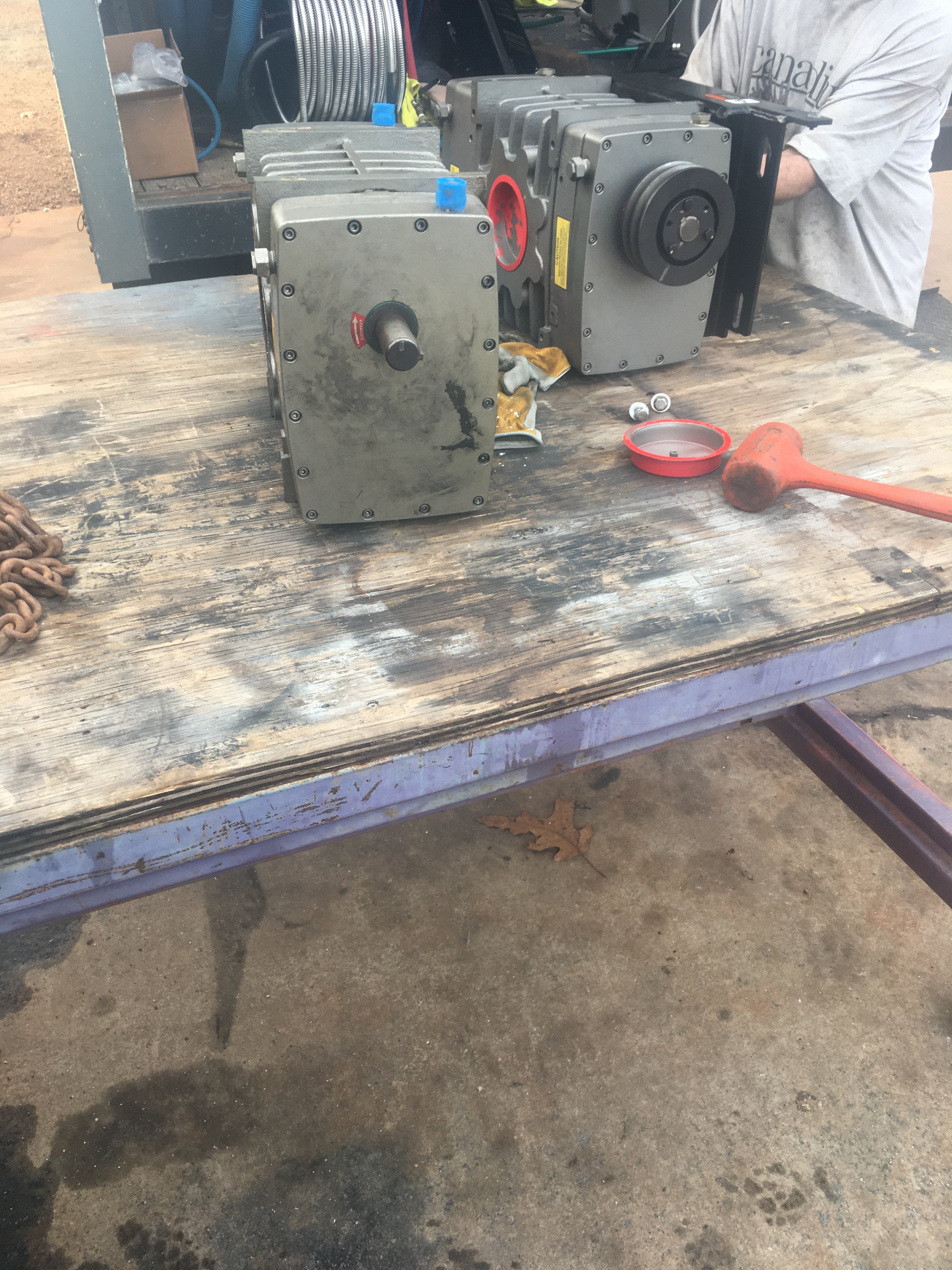

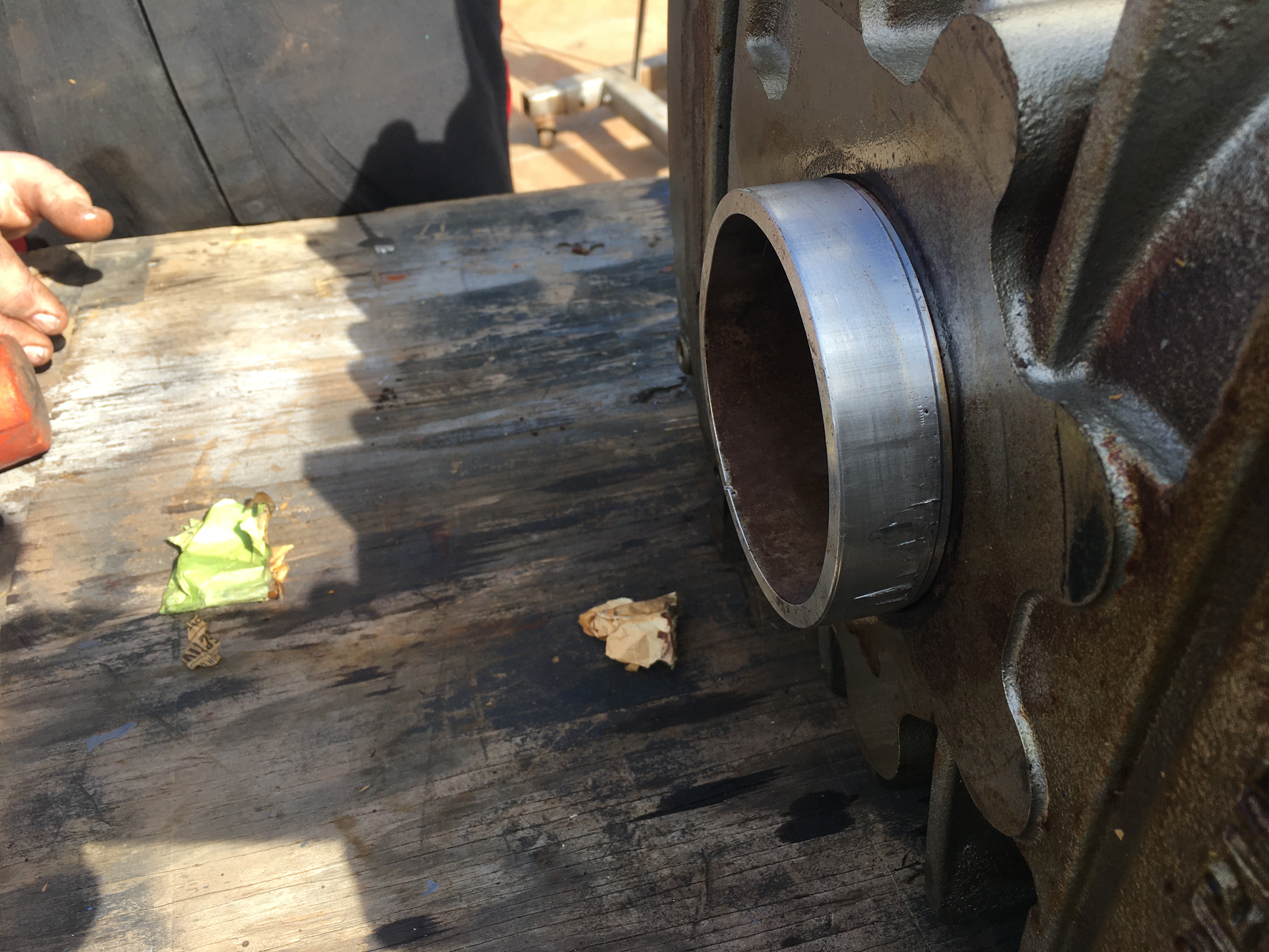

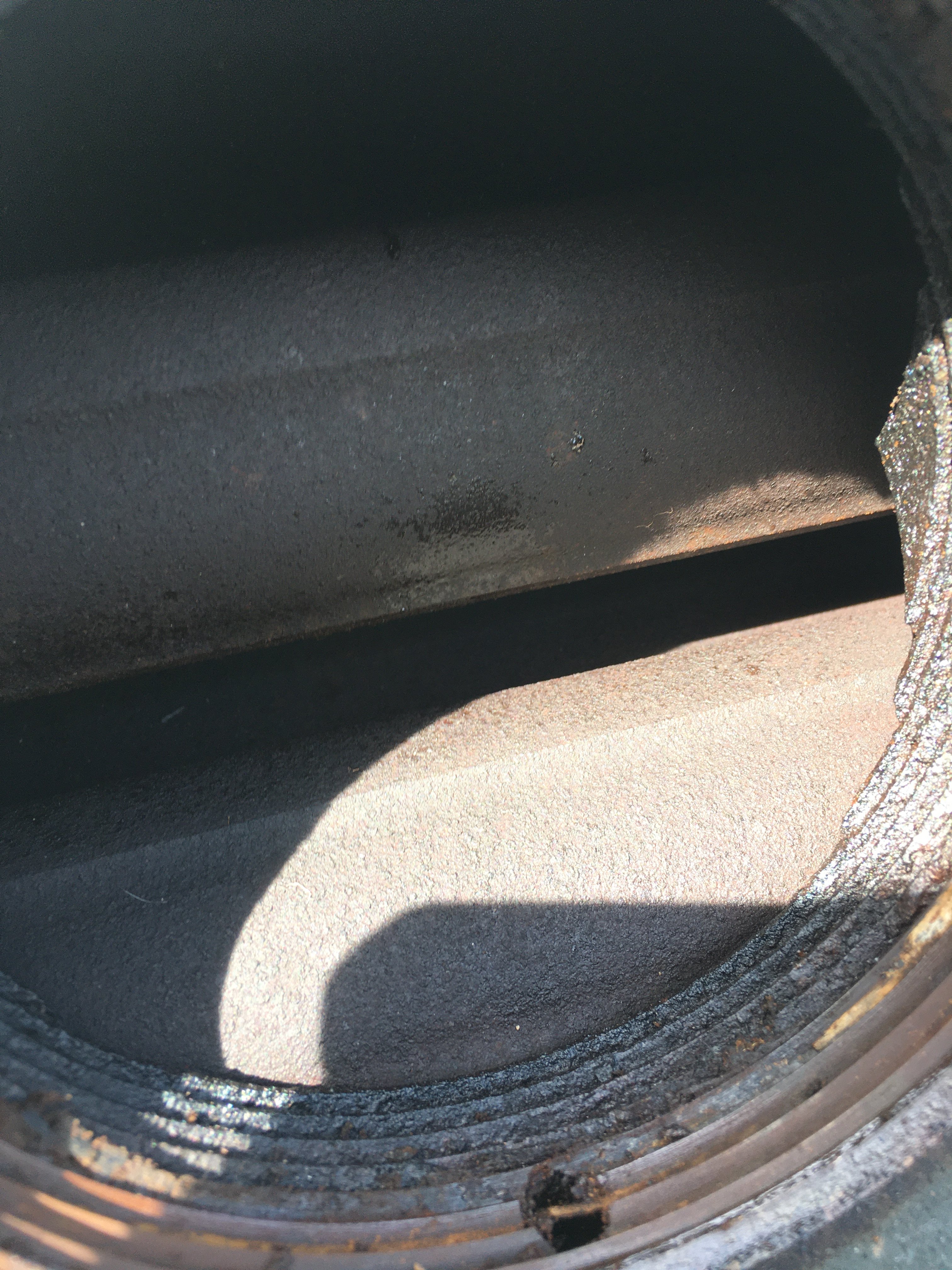

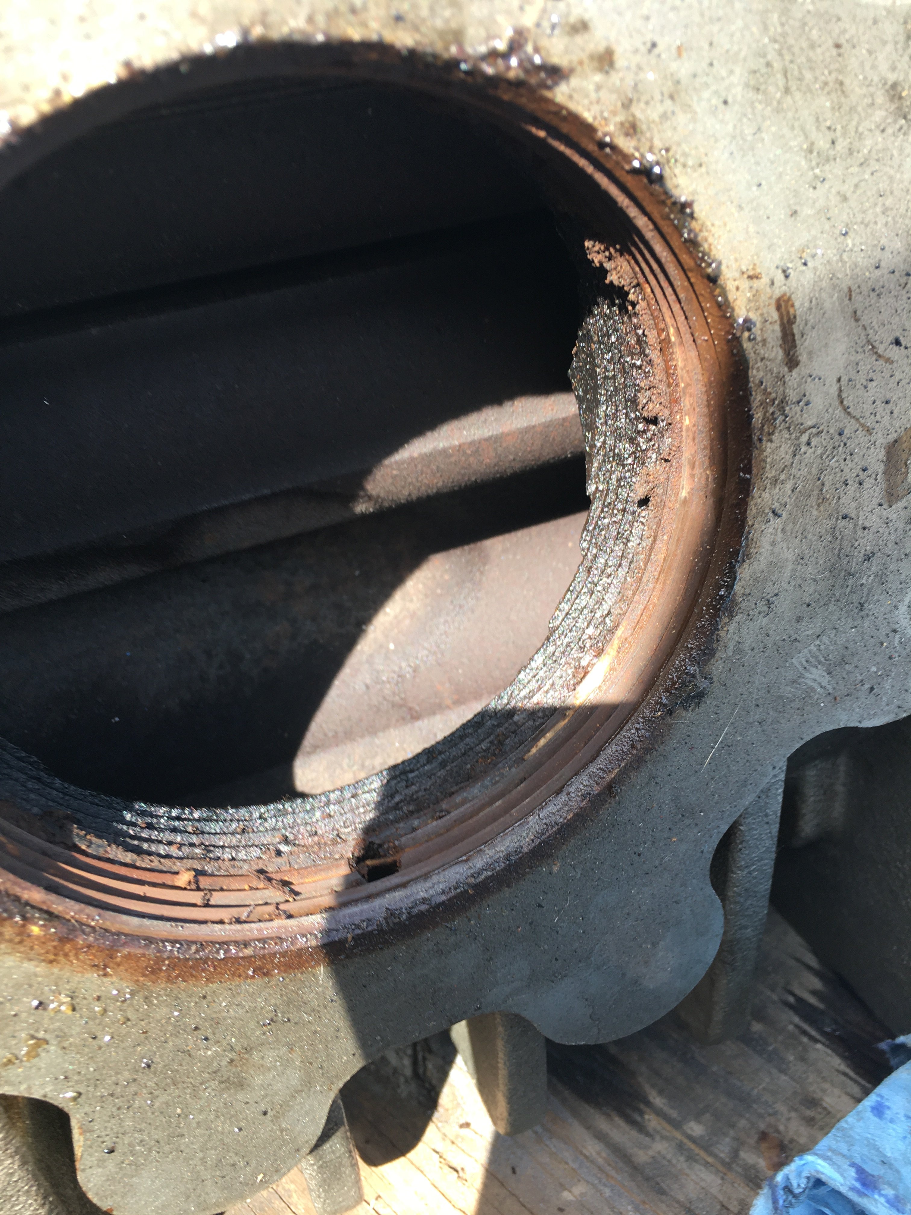

Got the blower out. Can’t remove the bottom pipe, so I’m having a new one made Monday. ☹️
Here’s a couple pics of the lobes. I hear a mild grind when I turn the shaft. I tried moving the shaft side by side and it didn’t have any play this time. Weird
View attachment 120539 View attachment 120540 View attachment 120541
Is there somewhere to send it to be refurbished? The new one is going to drive your quirky A crazy too. You’d love to have to have two blowers to swap out and compare on a multi point chart 😁

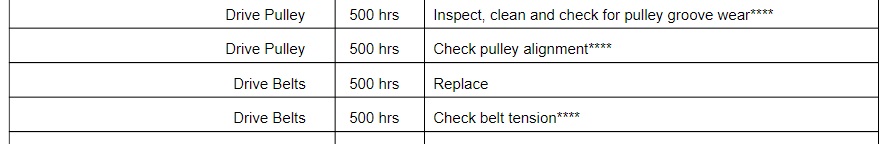

So if im doing the math right you've gone thru 5 belts in 2800 hours?? you're getting on average 560 hours on a belt?? and you feel this is good??
  • Wow
Reactions: Dolly Llama
Dwain Ray
Jul 22, 2020
872
I think I would look into clogged belts and stop changing belts with each oil changeon my blower but that's just me
That's alot of belt changes, on my pto i change the Serpentine belt around 1000 - 1200 hours, blower belts whenever they fail or look bad during routine maintenance(easy to change 10 minutes tops with just a crescent wrench) they usually last 2¹/² - 3 years. pump belt about every 5 or so years
