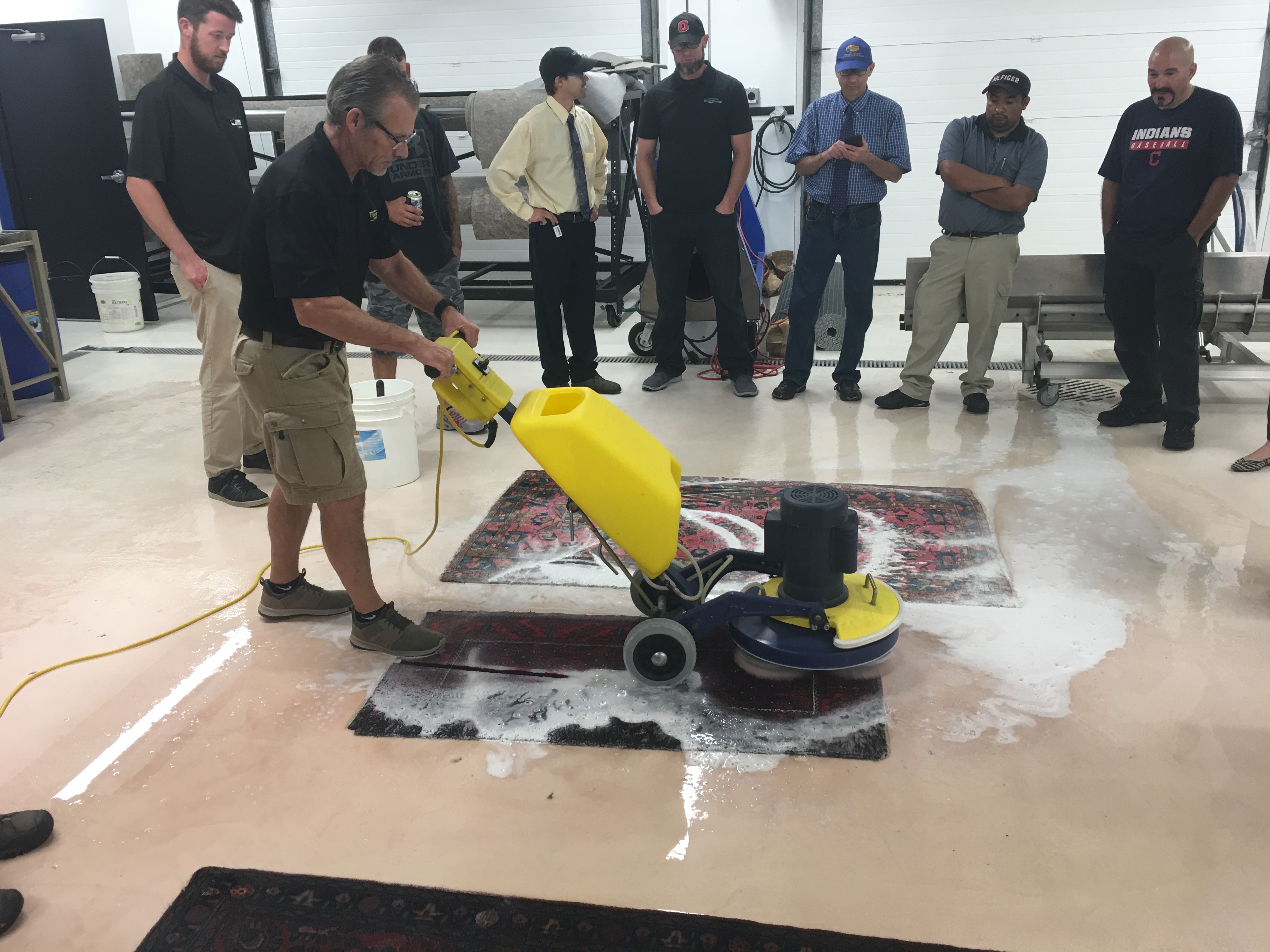

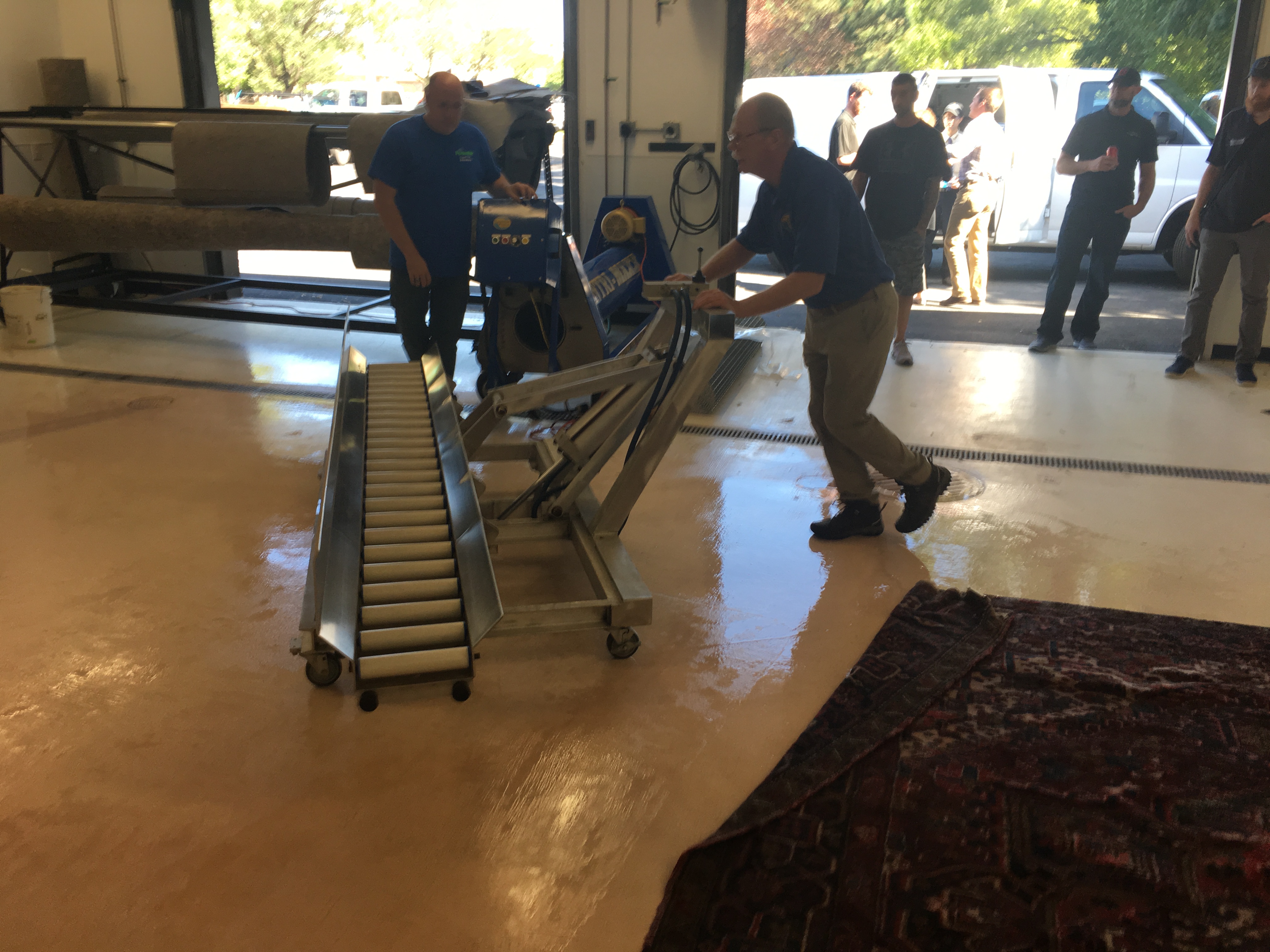

A big thanks to Tom Monahan and Doug Heiferman for putting on a great class. Talk about two guys that could not be more different. If you respond better to different ways of learning, between the two of them, they got the spectrum covered. I know this class was only really an intro to the world of cleaning but it was packed with hands on experience and information. I truly feel It was worth the money.
I really like Tom’s approach to rug cleaning. Simple and makes sense. Not a ton of chemicals needed, just about 4 that do the job beautifully. It’s an approach I’ll be adopting in my rug business.
Here is a bit of video from the class. I know Marty and Jimmy won’t last 15 seconds. Pics coming also. @Chris A , I got you in there a few times.

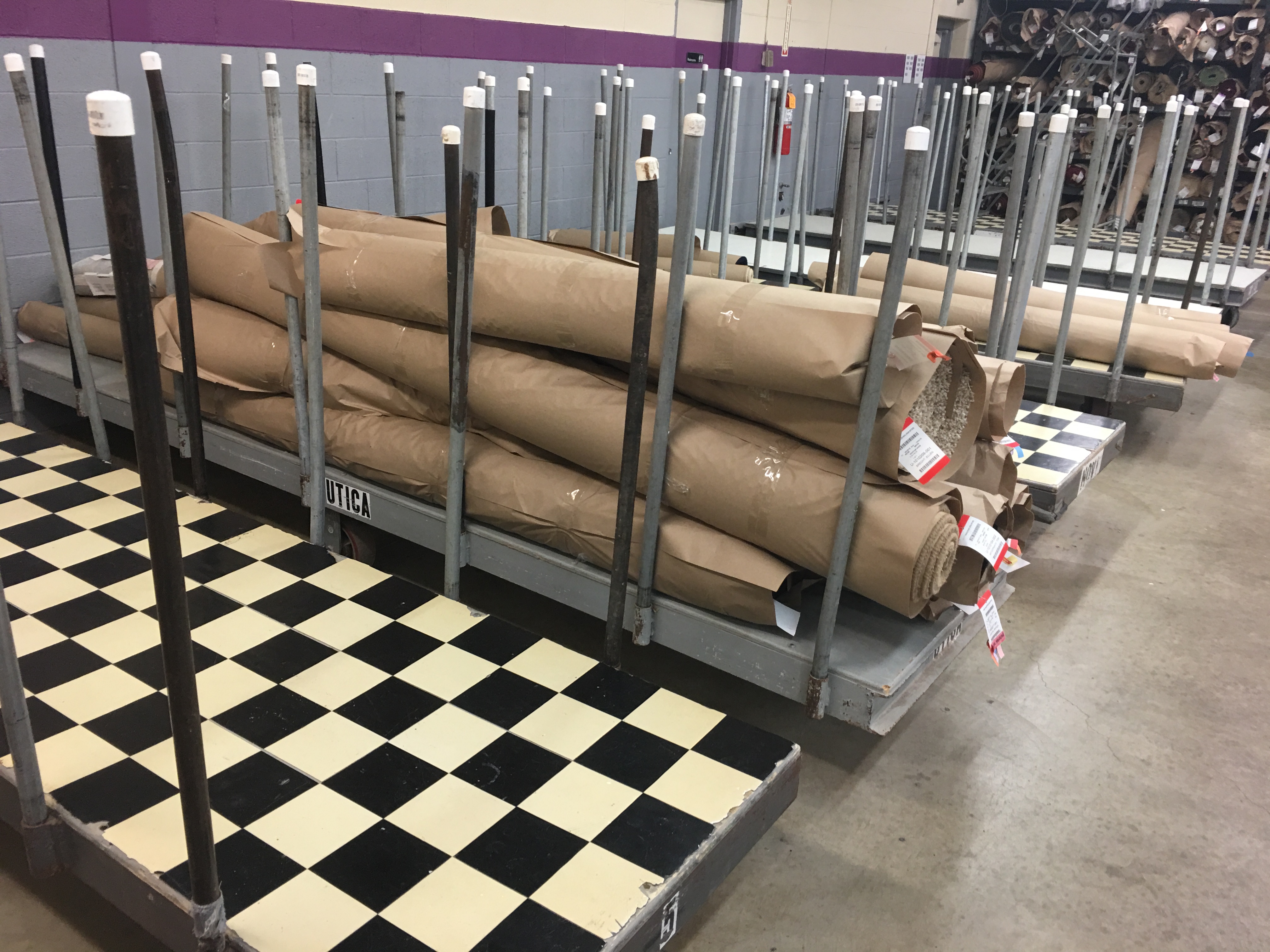

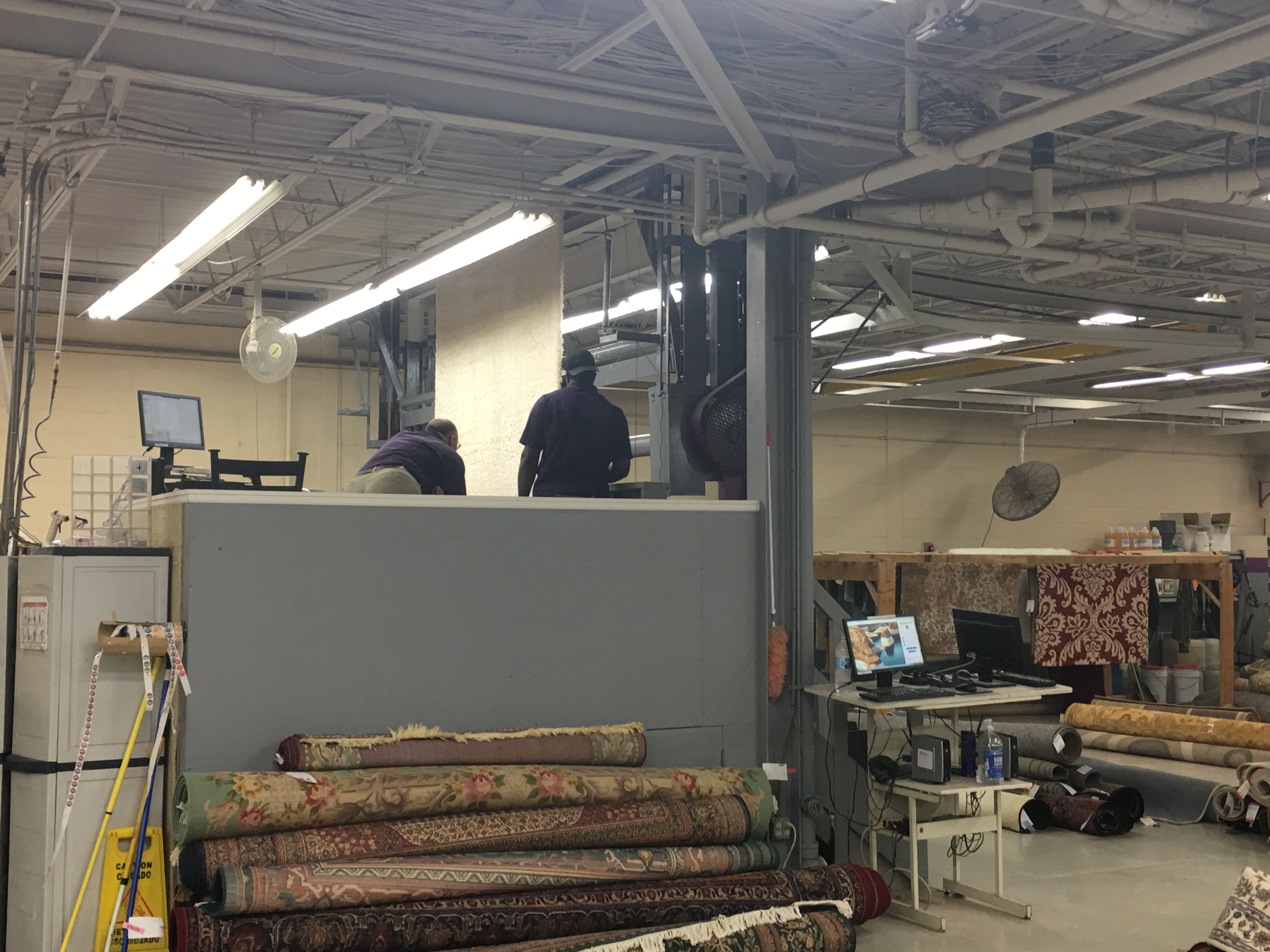

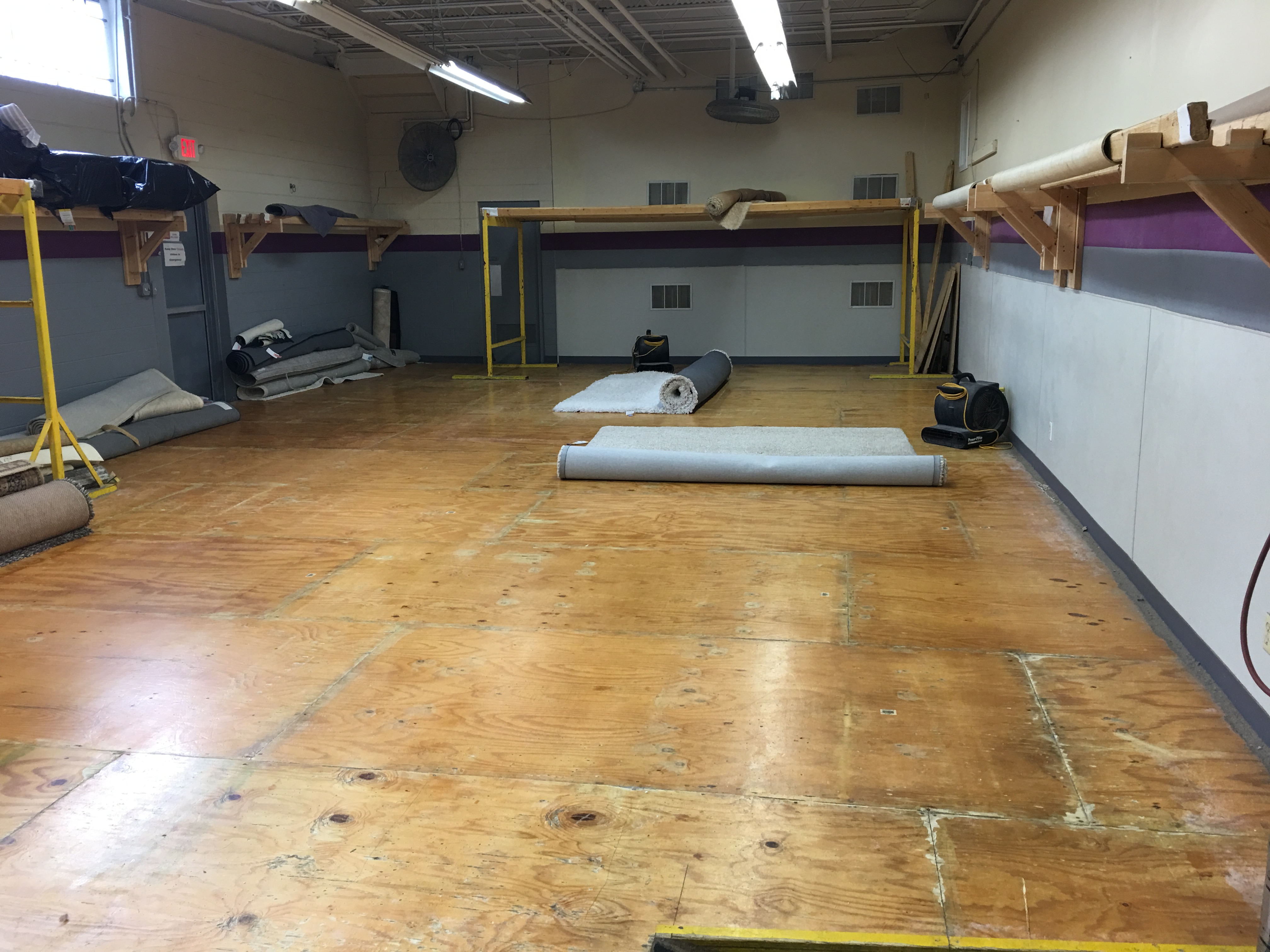

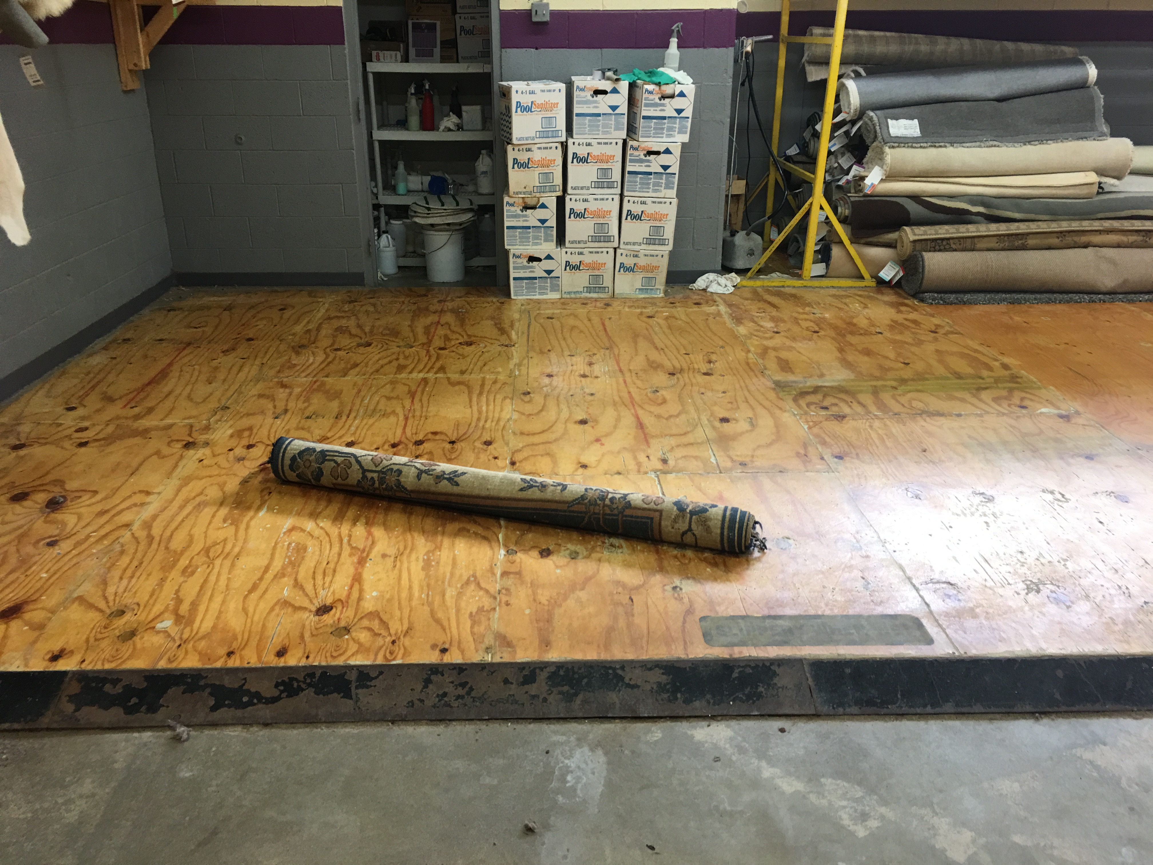

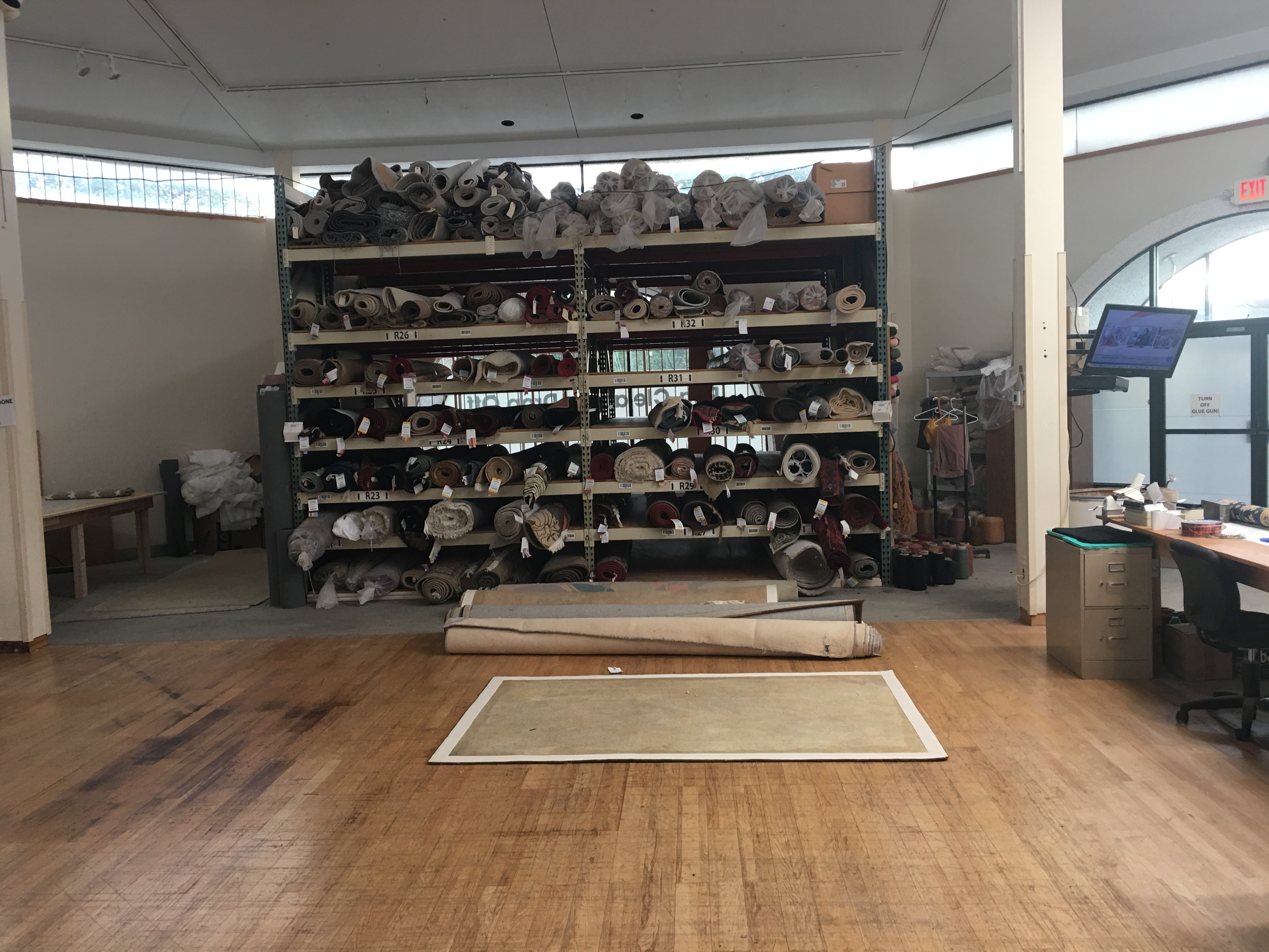

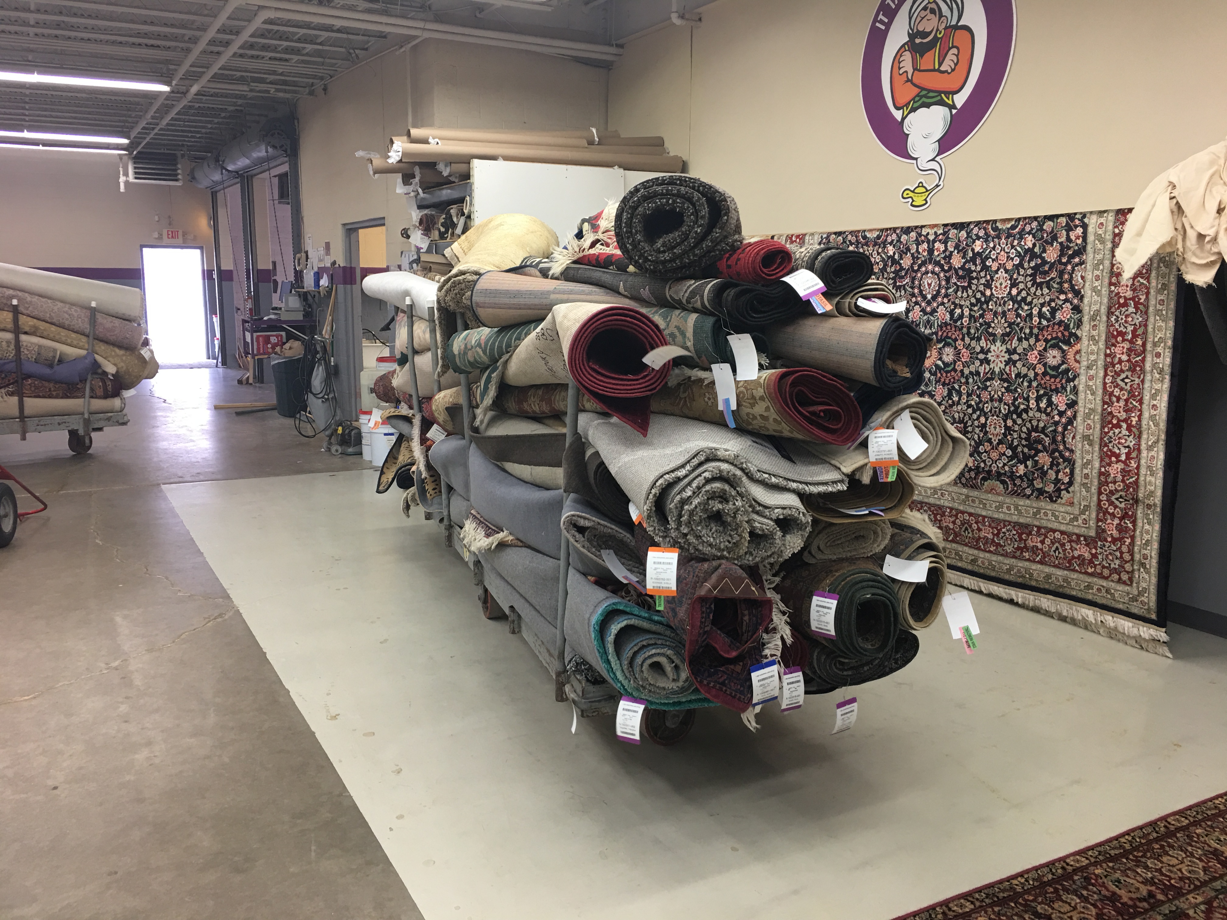

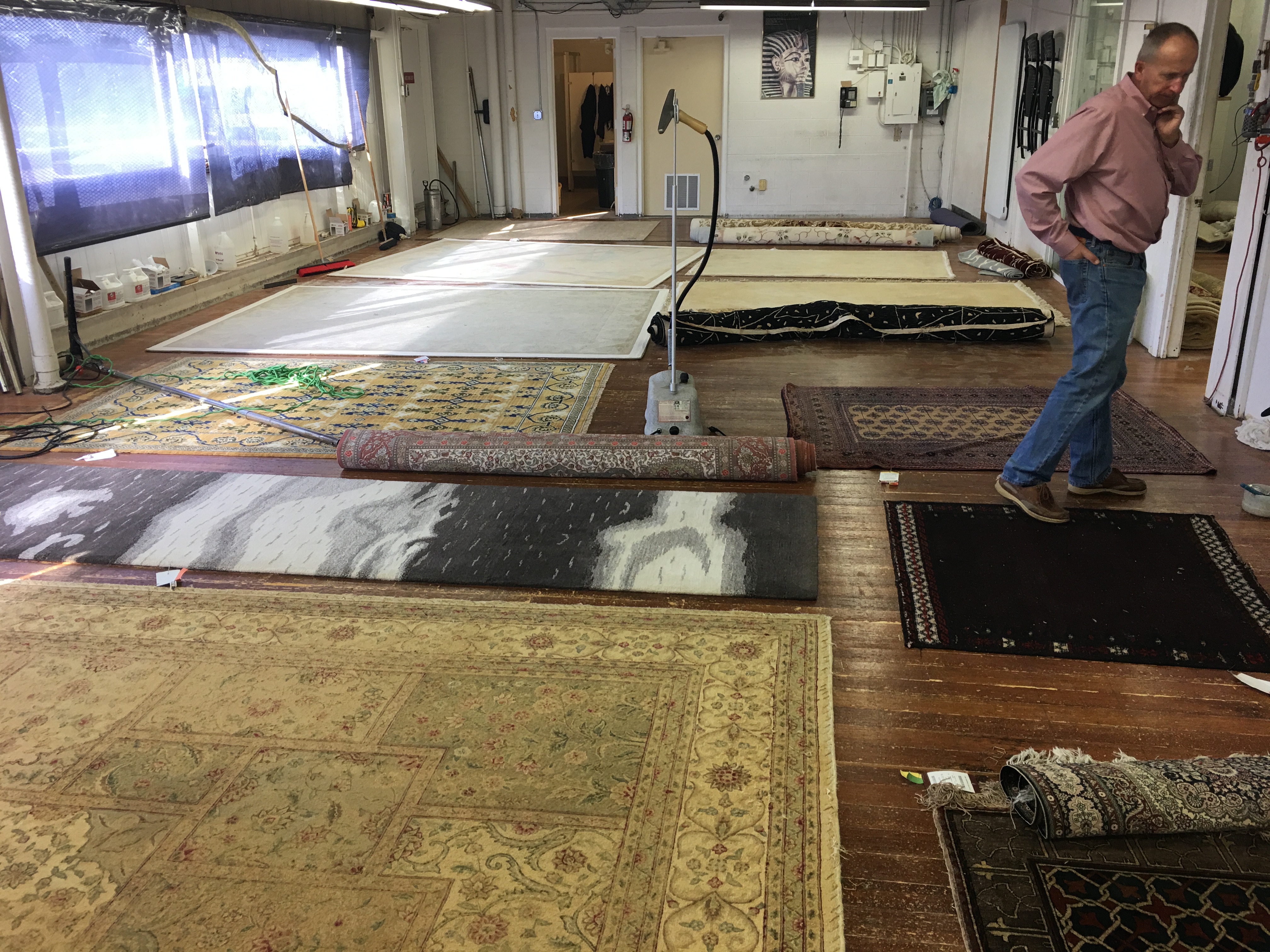

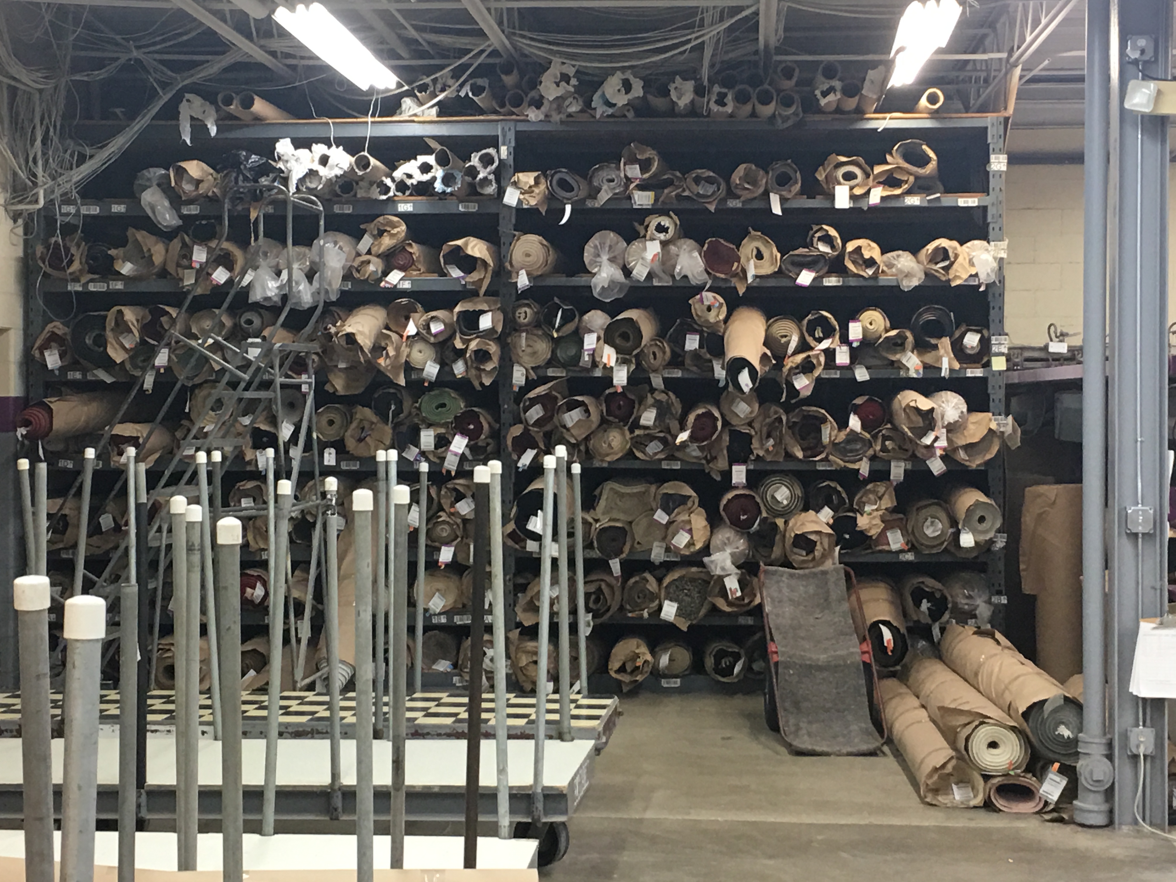

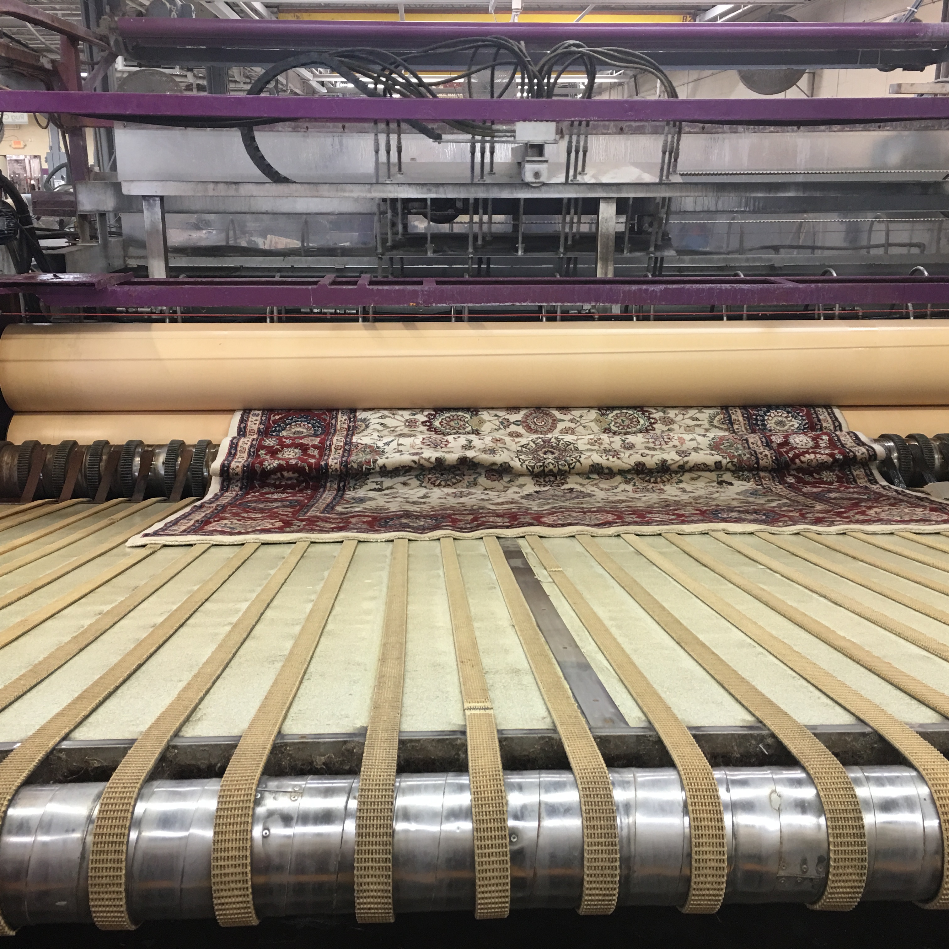

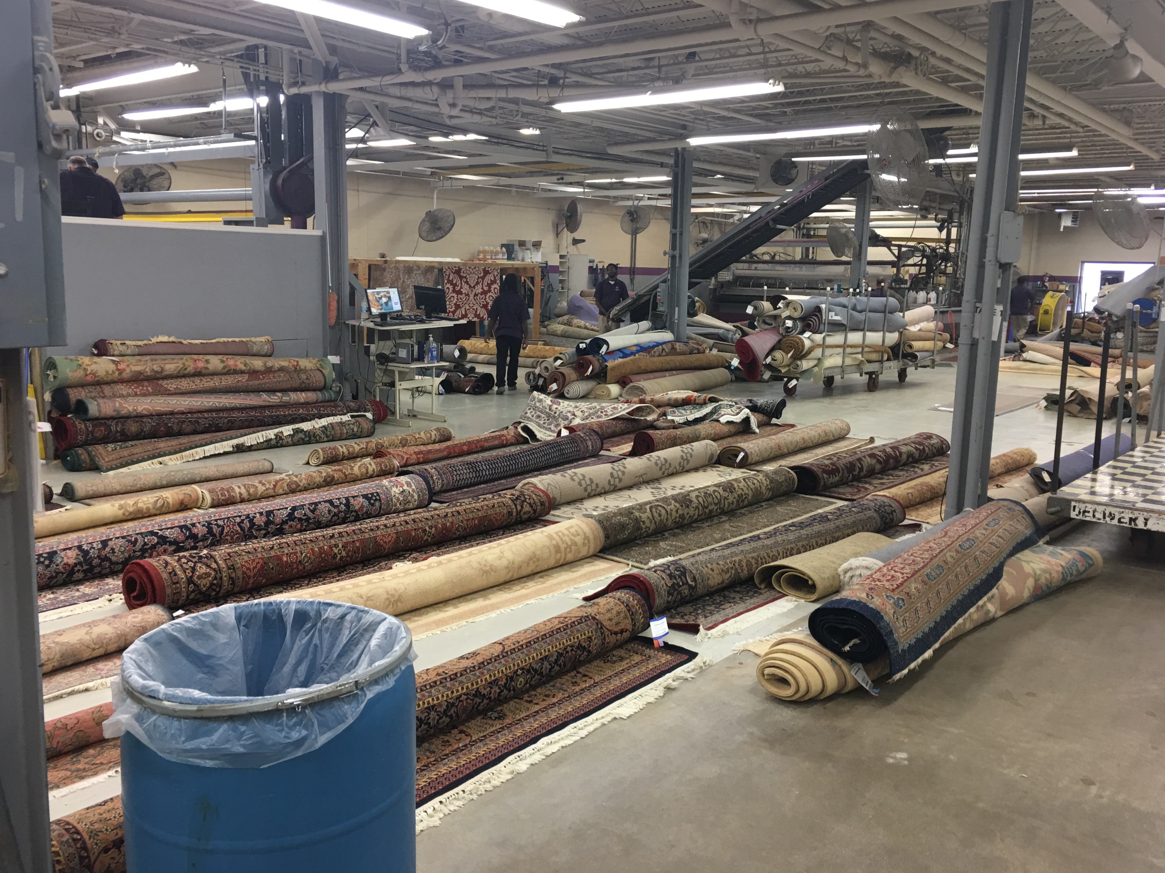

So the next morning I had some time to kill before my flight left. I was lucky enough to meet up with @Brian H from Hagopian and he generously gave me a tour of his plant. I had no Idea how massive and what an industrialized operation Brian runs. It was truly impressive so see something of this scale. The pictures do not do it justice in trying to present the scale of things. The drying room and conveyor system for rug transport was incredible. Thank you so much Brian for taking the time to show this Redding small fry your operation. Truly appreciated!

Impressive

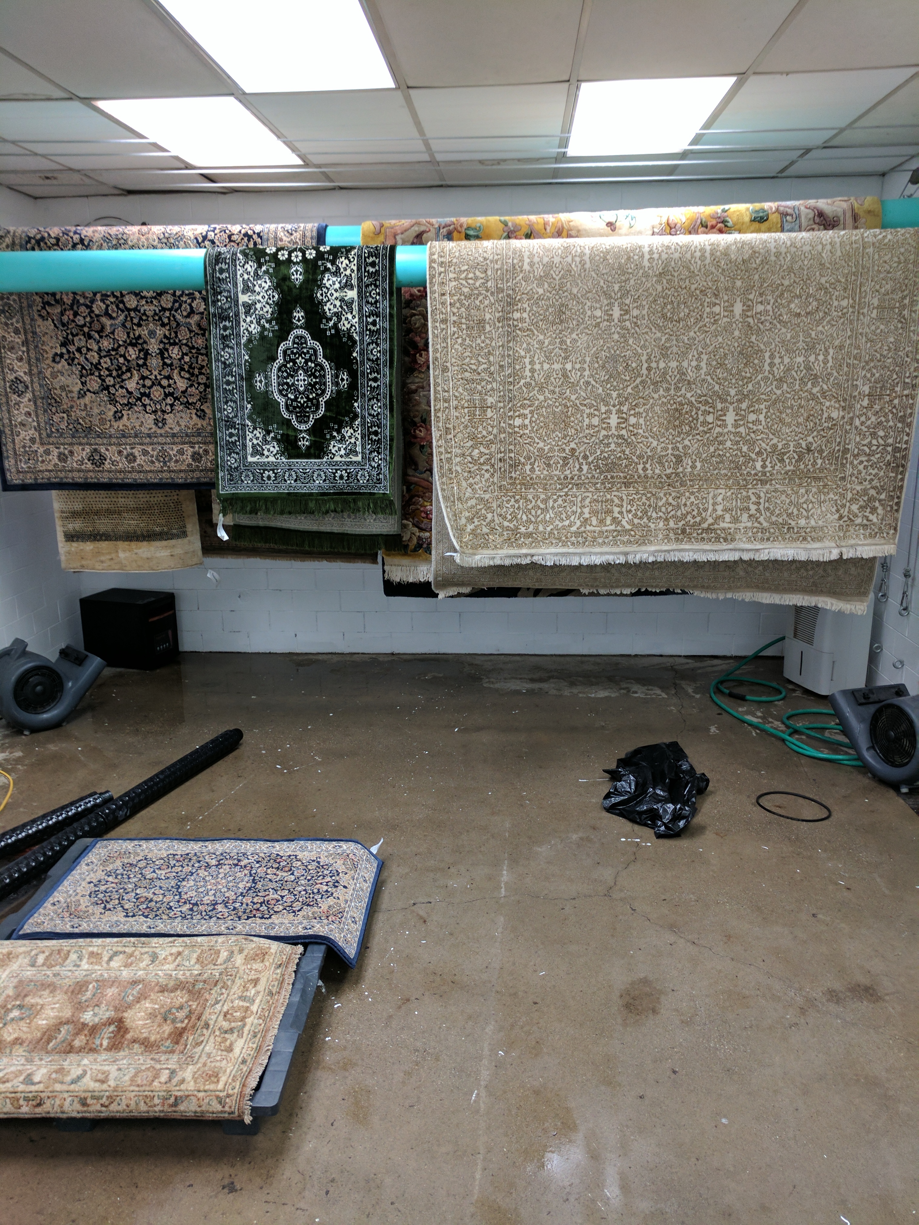

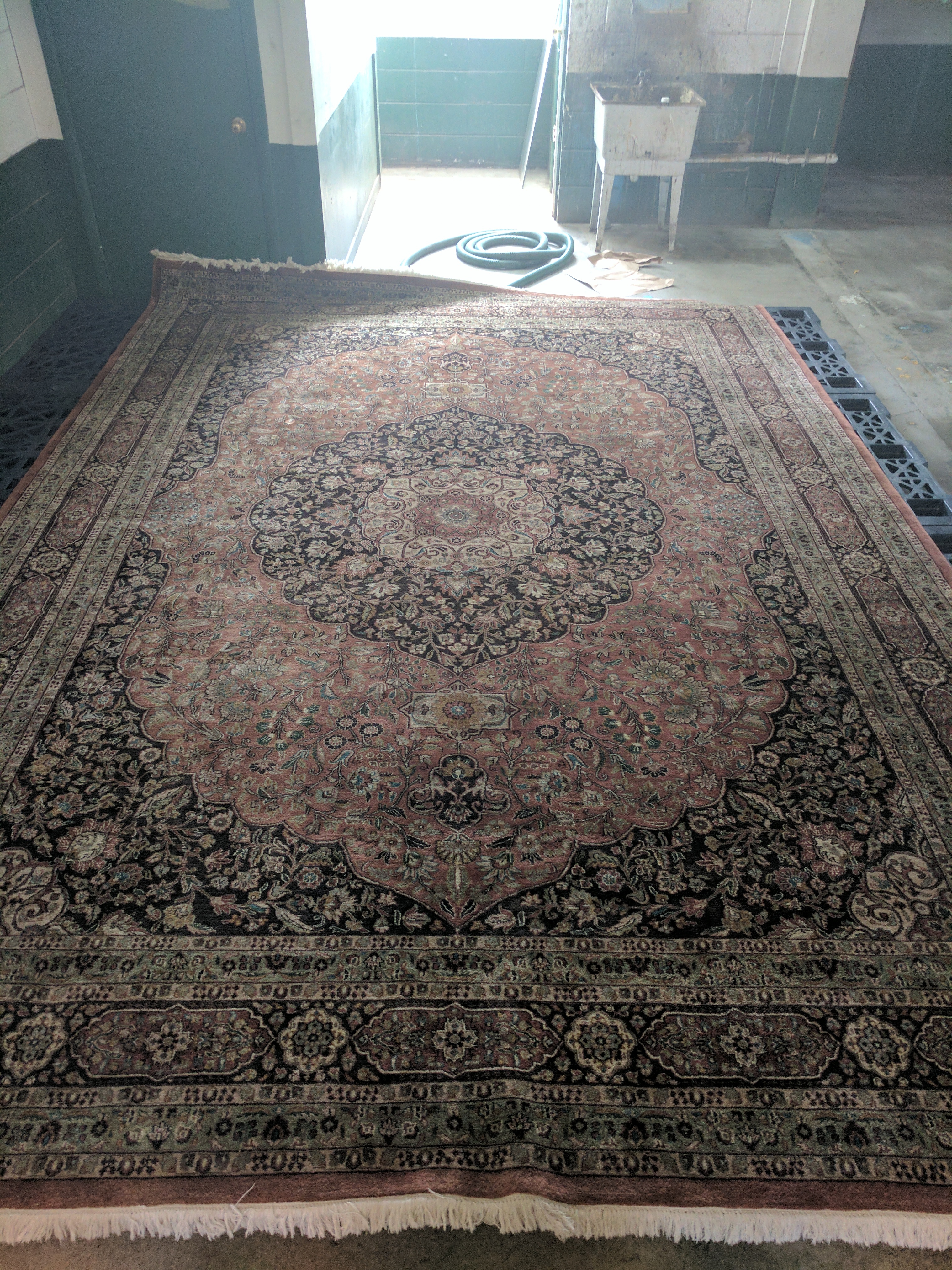

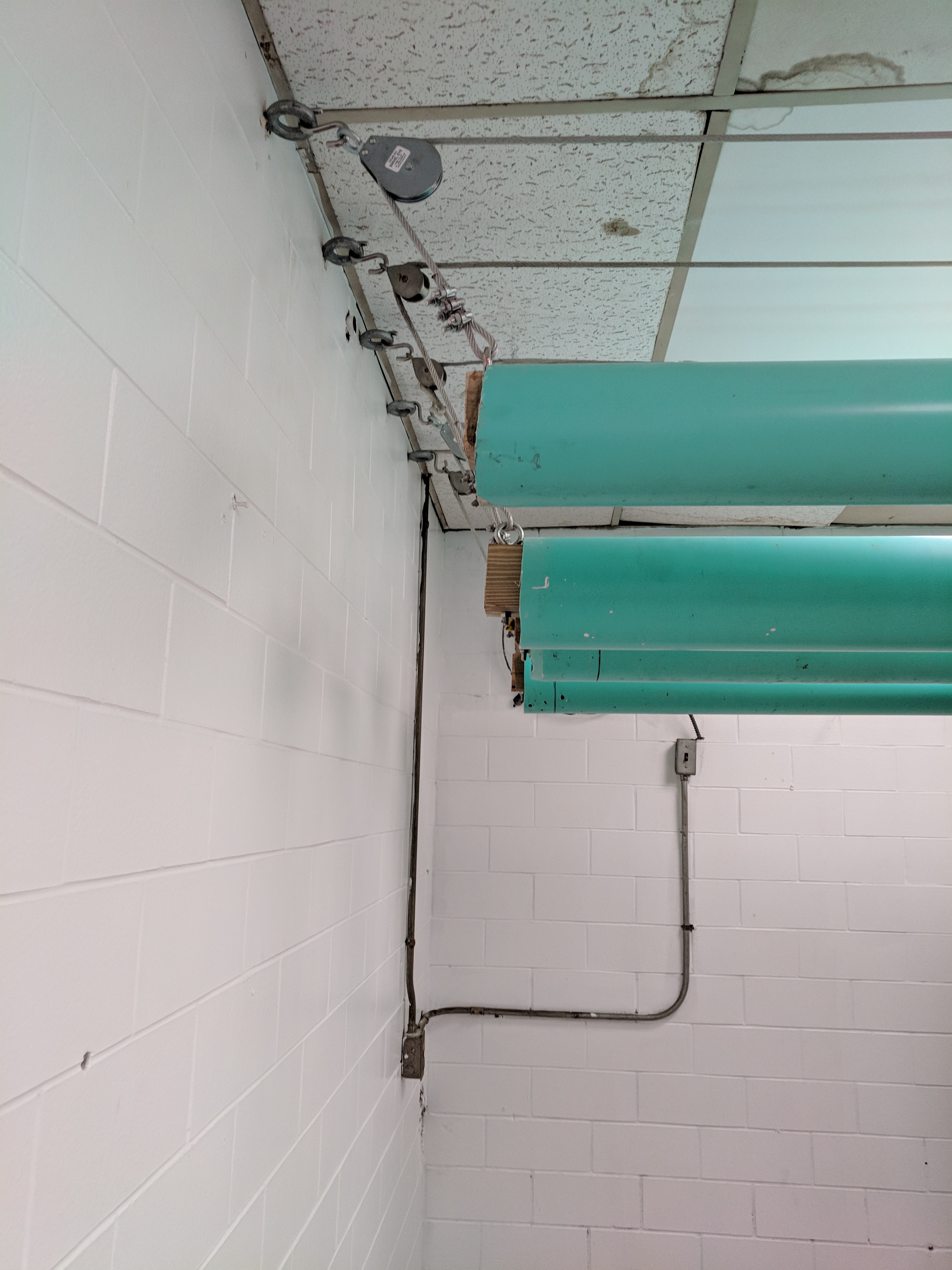

Here are some pics I dug off my phone. Rugs get dusted (kinda) on plastic pallets in another area. Then they get washed in the front part of this white room, there is a floor drain but the slope isn't ideal, I plan on changing that this winter, with the drying poles in the rear section. I use a warn 1000lb AC winch to lift and lower the poles. I have 7 14 foot poles hooked to eyebolts that go through the block, I have 3 more poles that need installed. I might fill the poles twice in a year, usually I'm around 5-7 rugs a week. Half are synthetic or tufted, 25 percent karastans, then a quarter or so hand made wool rugs. I have no intentions of taking over the rug world but I would like to get to 20-25 rugs a week. IMG_20170503_130059.jpg

How much can you do with that Rug Sucker system?
Did Mytee manage to fvck it up?

It gets a lot of water out, a lot more than I was able to do with a wand it water claw. I'm at about 36 hours to be fully dry with one dehu and fans, I do add heat to that room in the winter to get it up to about 80

Chris, did you install that trench system? Also, nice hanging system. Can you post a pic of your winch?

No the drain was there. Part of the floor slopes away from the drain which is a problem lol but I'm fixing that this winter. I'll get a pic of the winch tomorrow I just replaced the first one, but it was a harbor freight pos
5,294
Either lots of heat, OR, a big, commercial dehu is what you are going to need to get them dry, that, and lots of fans.....
Drying rugs is just like drying clothes: heat in, move air, exhaust damp hot air. While a dehu might throw some heat into the air, it's been proven by no less than the folks at Dri-Eaz that even big dehumidifiers are comparatively ineffective unless you're drying rugs in the hot and steamy jungle.

I disagree on dehumidifiers. If they work on flood jobs, they will also work in drying rooms.
Reactions: Papa John
28,154
better than just removing the moist air?
If they remove moisture from the air, rugs will dry faster as the ambient air is drier. Things in drier, warmer air tend to dry faster. Otherwise, it would be a waste of time installing dehumidifiers on flood jobs.
