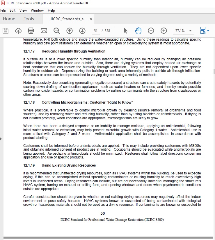

What is the fastest way to remove the moisture from the air?
In some cases it may be
I am aware of the difference between indoor and outdoor humidity. That's why we take readings in both in order to determine open or closed drying on water damage jobs. If I was in Phoenix or Vegas, I would just open the windows and turn on the fans. I can get my rh down to 25% indoors in my shop by using dehumidifiers. That's a lot drier than the humidity outside today. 55%

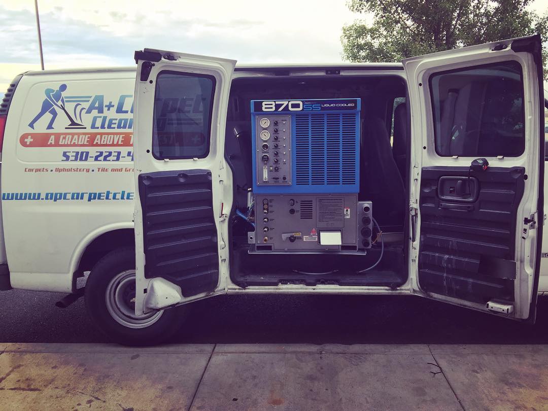

Just throw the 870 in that thing, and you and Macy could travel the country and make money....
Who knows, maybe you’ll become a trend setter...
