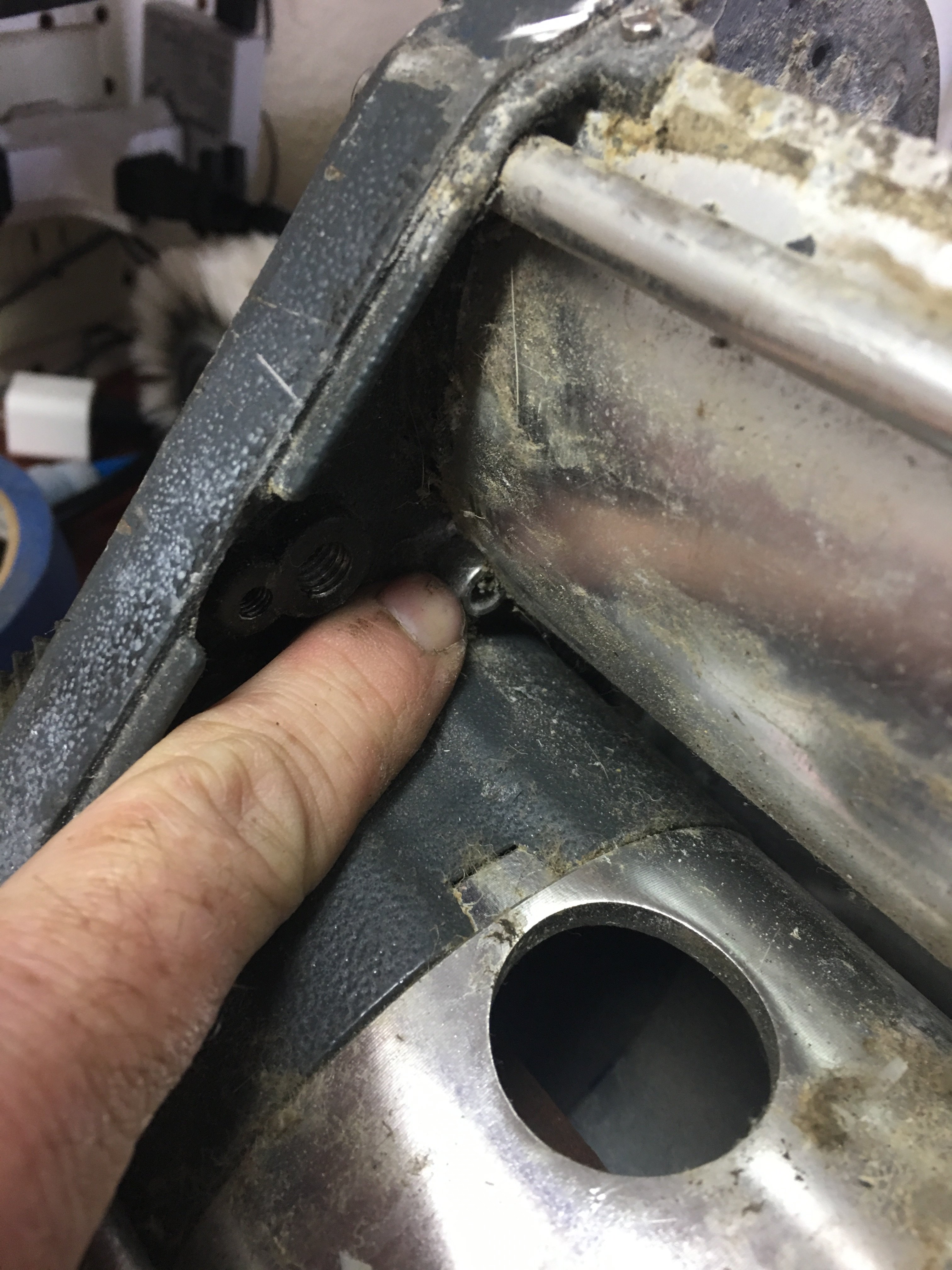

Well this helped. What a stupid design by Strong Dry. Seriously. How am I going to get to these allen head bolts! Ugh. Never again!
24,029

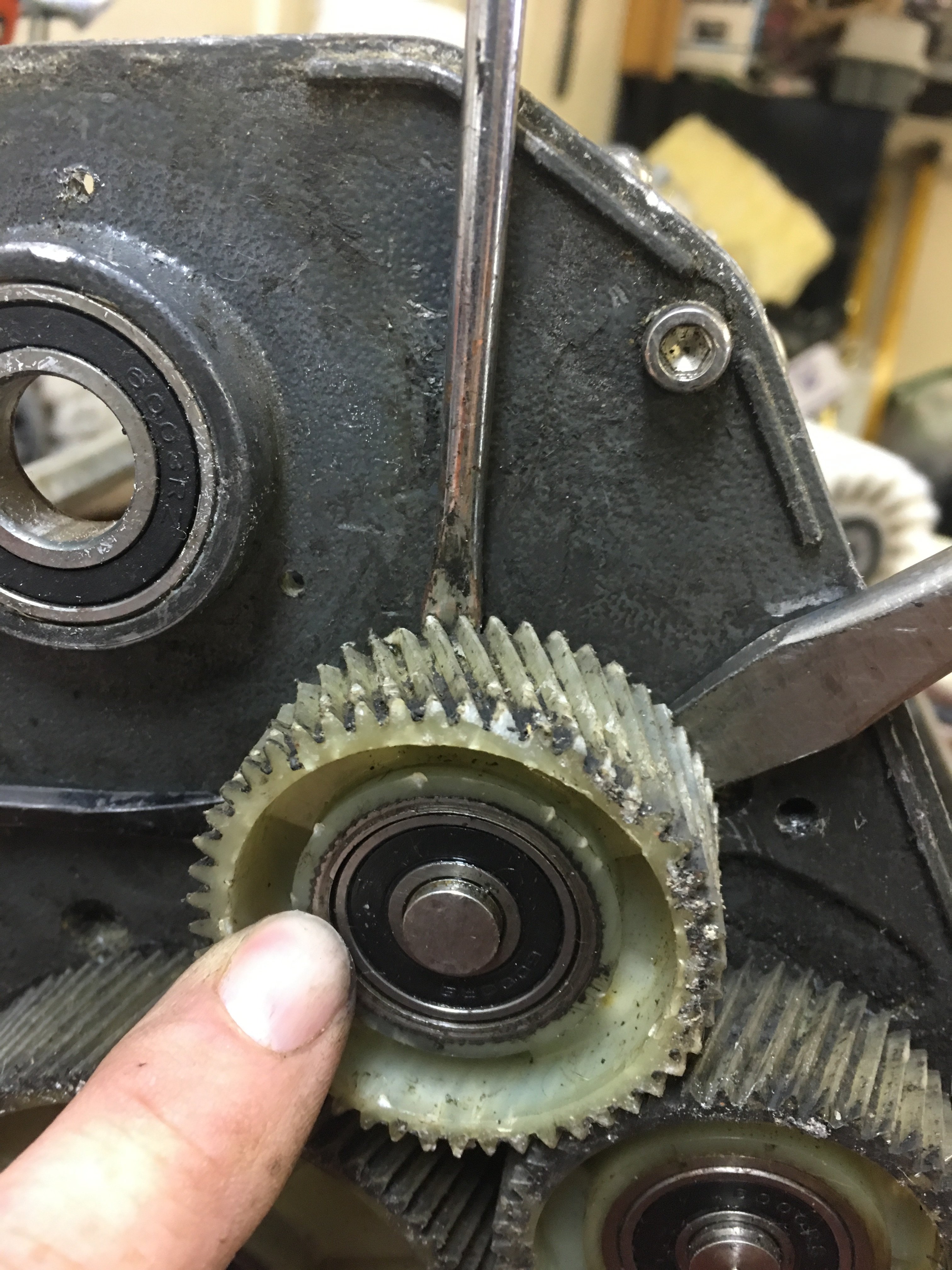

Damon, use thin wooden wedges. Oppose them and gently tap until the shaft releases them.
Door shims will work, 99 cents a packet at Lowes.
Looks like they need to disconnect from the back. The video says they will not come off from the front. Whats the point of the snap rings then? Seriously a retarded design.

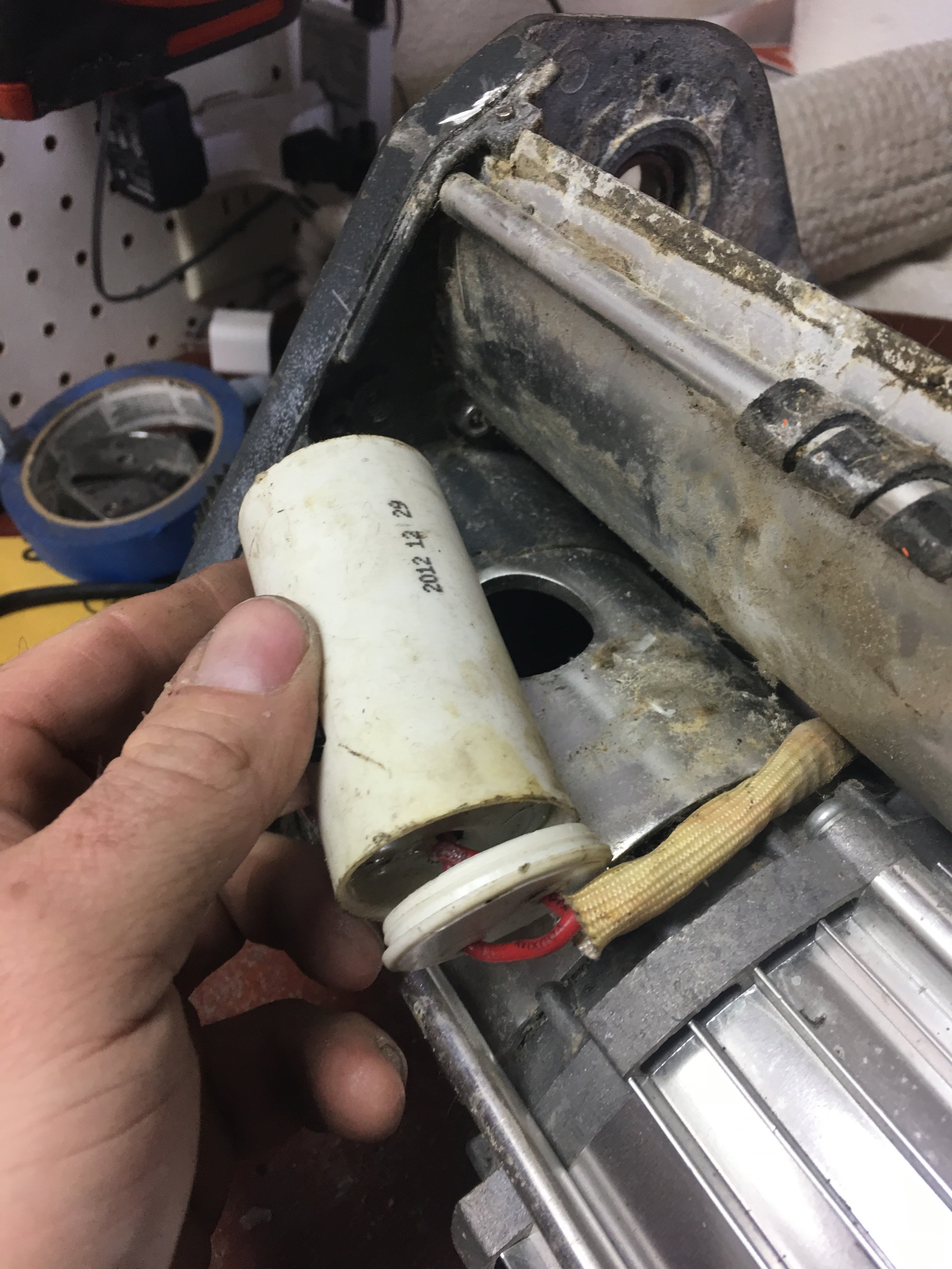

I had to remove the capacitor to get to the allen head bolt. I’m making progress.

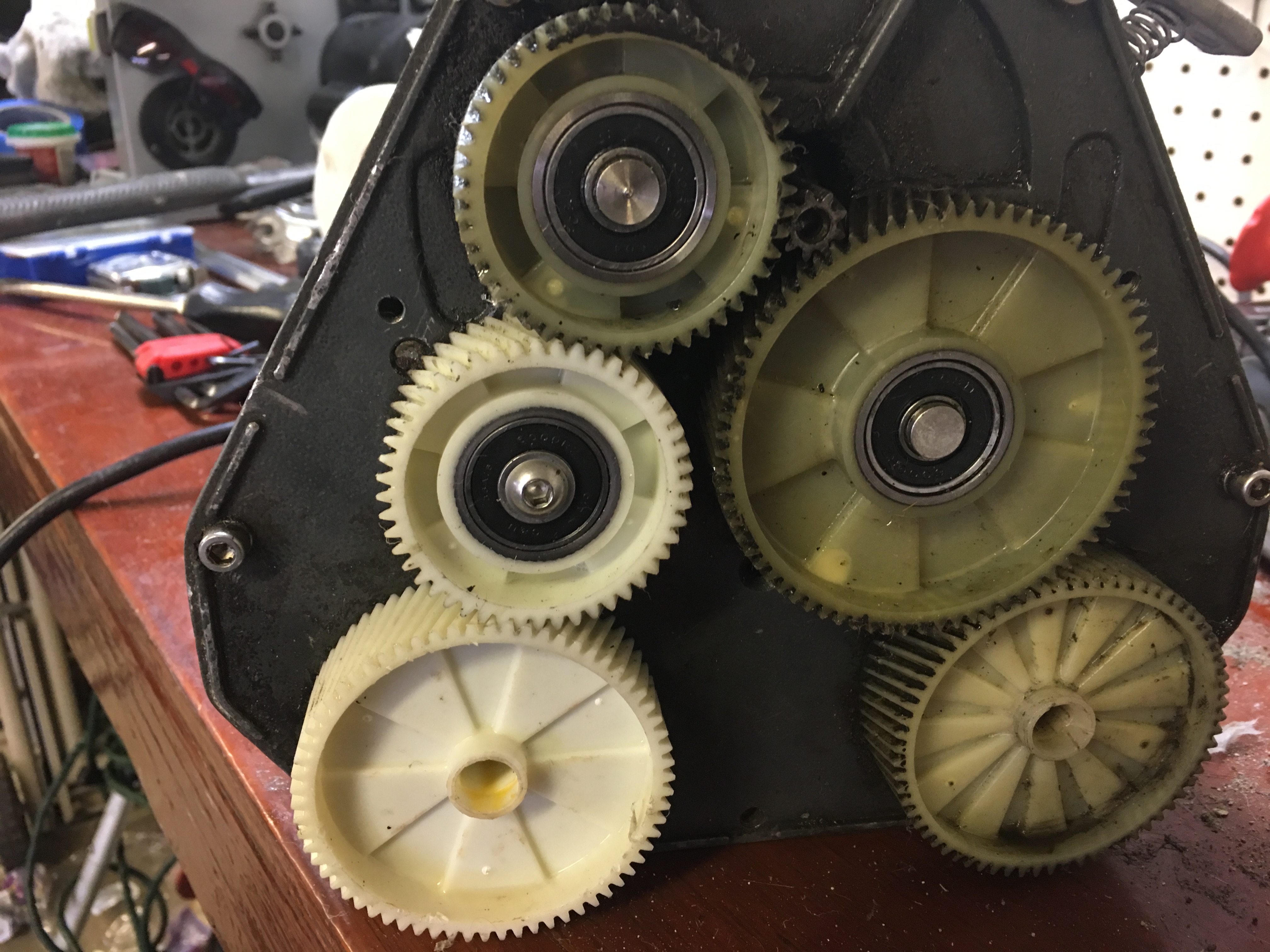

Looks like i got it. The gears fit perfect. Im only replacing the broken gears. I’ll keep the others for future repairs. Holy crap was this a pain. Time to put it together and see if she works. Got my white grease.
Should 've replaced them all and kept the old ones for backup. Probably doesn't matter though.

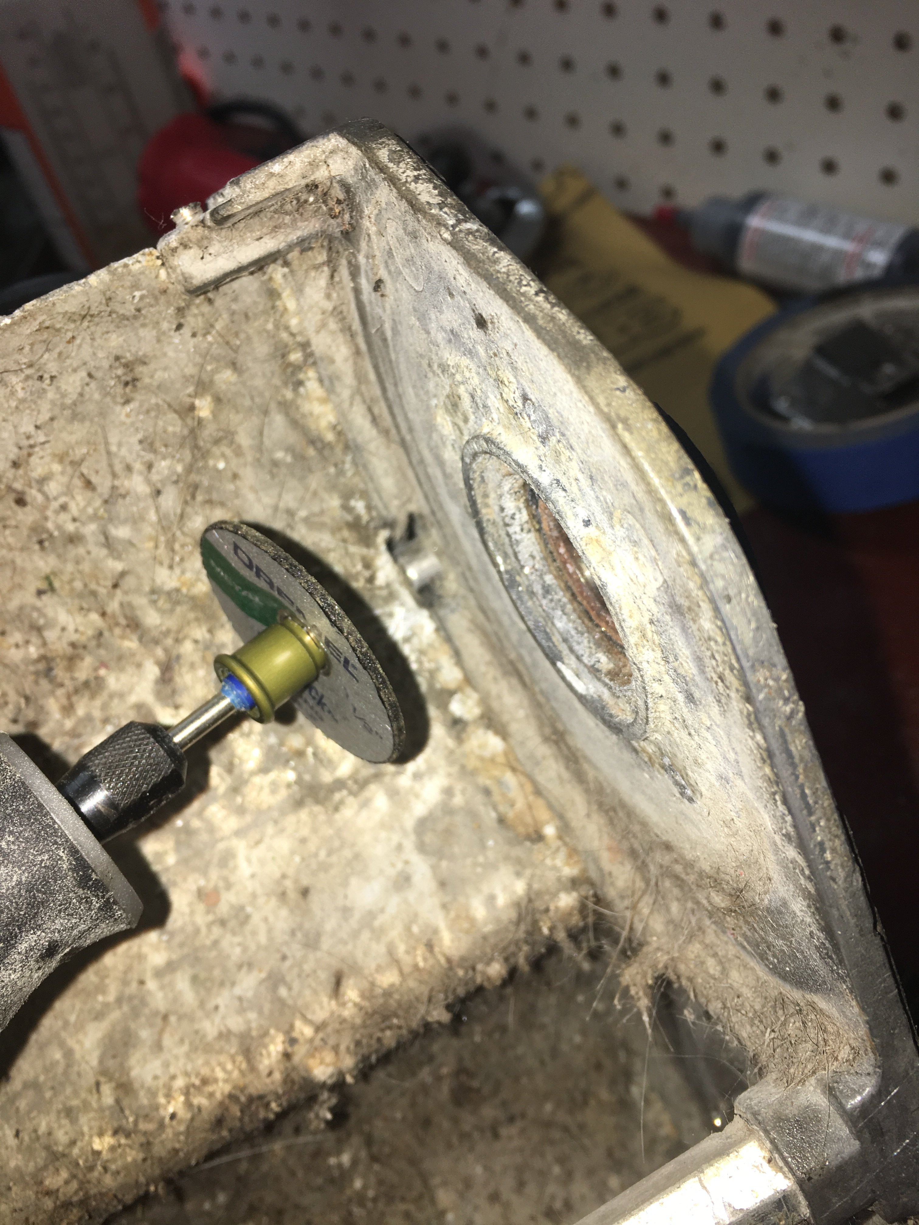

Putting it back together was a fun project. The screws that hold the main cowling on were so crusted the heads snapped off. When I attempted to drill them out, my drill bits broke. When I was able to get an EZ-out in there, my EZ-out snapped. So,I drilled new holes and tapped new threads. Its nice having the cowling secured down now. I ripped 4 pair of jeans on that damn corner sticking out while carrying it.
