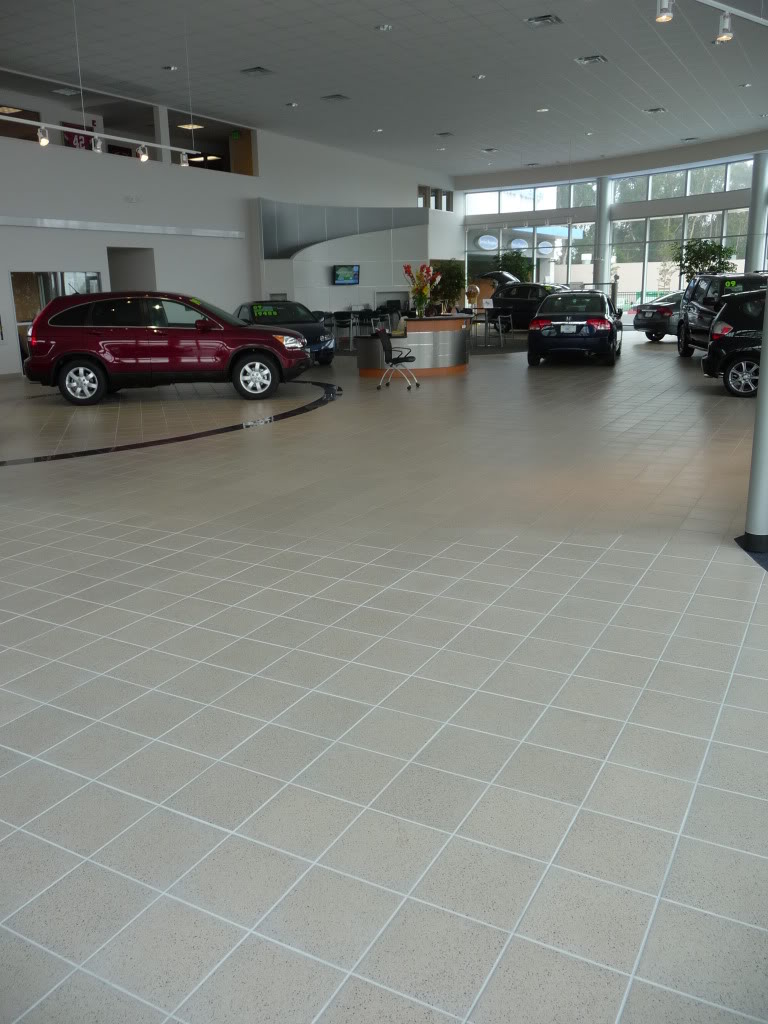

How's this look?

Looks great ... just wondering about the following
Mikey P said:
We wasted considerable time trying to get use to the Shamwows.
Thick cotton towels are just plain faster in my experience.
Mikey and I have battled on this topic privately for months ... my opinion is do what works for you. My only question is are you using the chamois wet or dry ?
116,977
Wet!
They smear the sealer too much and don't hold enough as well.
Thick Costco Cottons work best FOR ME.
and the OP pads are working best for buffing.
Spray down some NpH, giving it 30 secs or so and buff away to Perfect.
