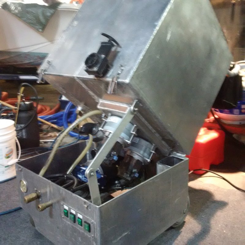

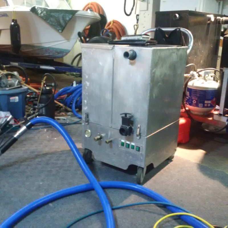

I have 14 bicycles. 5 of them I have ridden in the last year... 10 of them are rideable with just a little air added...
What works for me is power, and capacity. There is not just one portable that does it all. There are different machines for different jobs. If you are mainly a tm guy and you use a portable grudgingly and infrequently, you are probably good with a basic machine. Single cord, small pump, 2 small vacs. Probably half my work is portable from a 1-bedroom suite, to a 60 story highrise that needs all the hallways cleaned. My portable cleans with a true 500 psi pump at up to a 5 flow wand and has 2-3stage high performance vac in parallel to remove the cleaning solution and dry the carpet. The capacity of my machine is 24 imperial gallons and the recovery is 20 gal. I fill the machine with a bucket or a hose connected to a sink, whichever is more convenient. I use a edic heat and run heater with it's own power cord. 3 cords in total. Gives me decent heat on a 4 flow wand. You have to see it to believe it. Gives me truck mount performance where truck mounts fear to go. Is it for everybody? No, but when you do that much portable work, you get tired of the mickey mouse machines. When people see the sheer size of my machine in the elevator or the hallway, they always ask "what is that?". I tell them it is a carpet cleaner and we take it seriously. They always take a second look and ask for a card. -if you are a tm guy and hate using a portable it's because you are using a feeble little machine. When you get a real portable machine, it changes the picture. Not all portables are created equal, and ALL of the manufactures lie or exaggerate about their machines capabilities
I loved those big wheel chair wheels on that dirt invader!
After all it had the same 3 stage vacs and pump like everything else?
There are other photos on mb as well some where. It's not that we're sensitive about portables, we just make our portables as powerful as possible so that we can give our customers as close to a truck mount experience as possible. It would be nice if the manufacturers would smarten up. For example, edic galaxy machines. Good machine, uses an optional external heater with it's own power cord, available in 10-17 gal units, high performance options. How about giving it 2 inch plumbing? How about adding autofill/autodump? How about when the autodump engages, it cuts out 1 vac motor so you don't blow a circuit breaker? You will feel the vac loss and wait for a minute or so until the machine pumps out then you can continue. The Mytee line up seems pretty good. They do use 2 inch plumbing but they try to combine everything on just 2 cords. Not possible and still maintain the right power. We use our 500 psi pump at 500 psi. The pressure is our agitation. I don't understand why people turn the pressure down to 300. 500 is not excessive, especially when you have heavily soiled carpets. My machine is powerful enough that I could put it in a van and with a heat source, could call it a etm but it would never be as powerful as a true truckmount, which is why I have a real truck mount. For situations where my my tm won't reach, I don't want to be using a substandard machine. after using my portable, going back to a basic ninja or edic is like spitting on the carpet and sucking it out with a straw
@Cleanworks Any Pictures of your 20/24 gallon machine? So in US gallons is that 25/30? Did you post pictures of it before? All aluminum?

Ron, I think you said last time it is not as heavy as it looks. It is aluminum isn't it? What does it weigh? Great straight forward design. How is it at going up stairs?
I think they look at the average porty hack. The average hack only cares about price and design. Power & production are secondary to them. Unnecessary expense when you're a splash and dash cleaner.
Real cleaners like Frank, Nate, Ofer and Willy are far and few between in the porty world. Ron looks like he has a very nice unit...machine. However to build and sell one that nice would price most porty users out of the market.
Brevik made some nice units but people wanted cheap.
