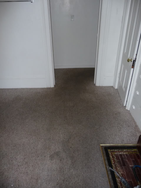

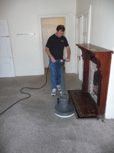

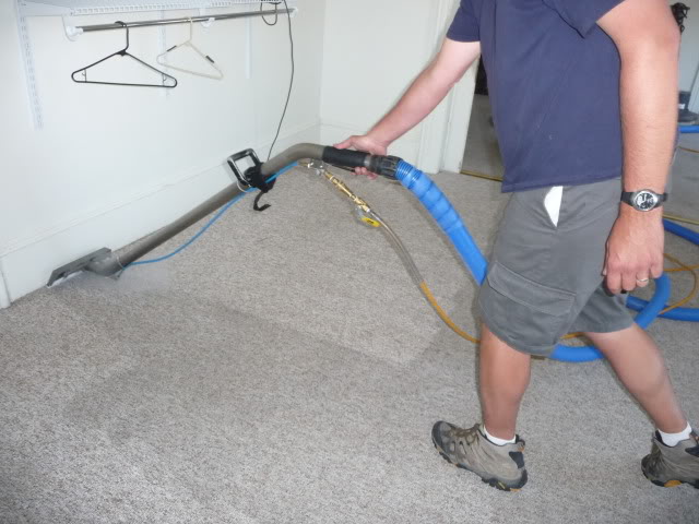

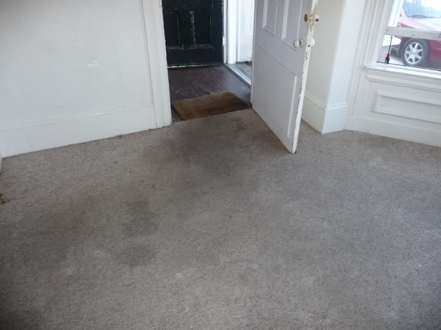

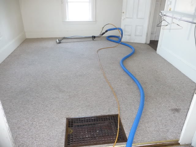

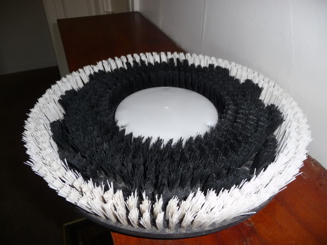

Ghetto but I gots my new shampoo brush.
116,117
after shampooing , before rinsing.
I owe FIddy an apology.
A Shampoo brush does work every bit as well as a Fiber Pad.

I don't have any idea who this thread was directed at, but you seem to forget that it has been ME, the king of pork, that has been telling you to get a shampoo brush for years!
On residential cut piles, it's better than a scrub pad.
On CGD, the pad is best.

I should confirm what Marty said, it works about the same on Berber but better/deeper on piles.
Especially a 80 ounce plush we did yesterday.
