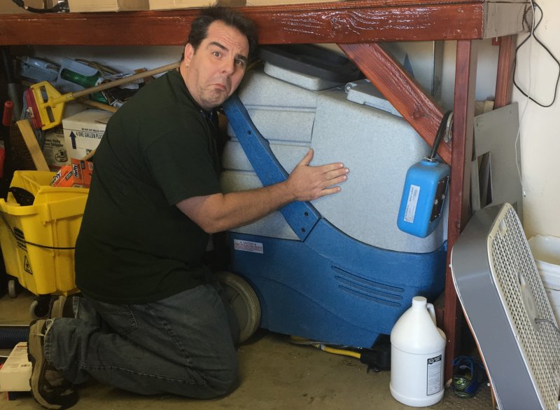

I could say I wish I had my Amtex right now as a back up. But I know that would not go over well.
