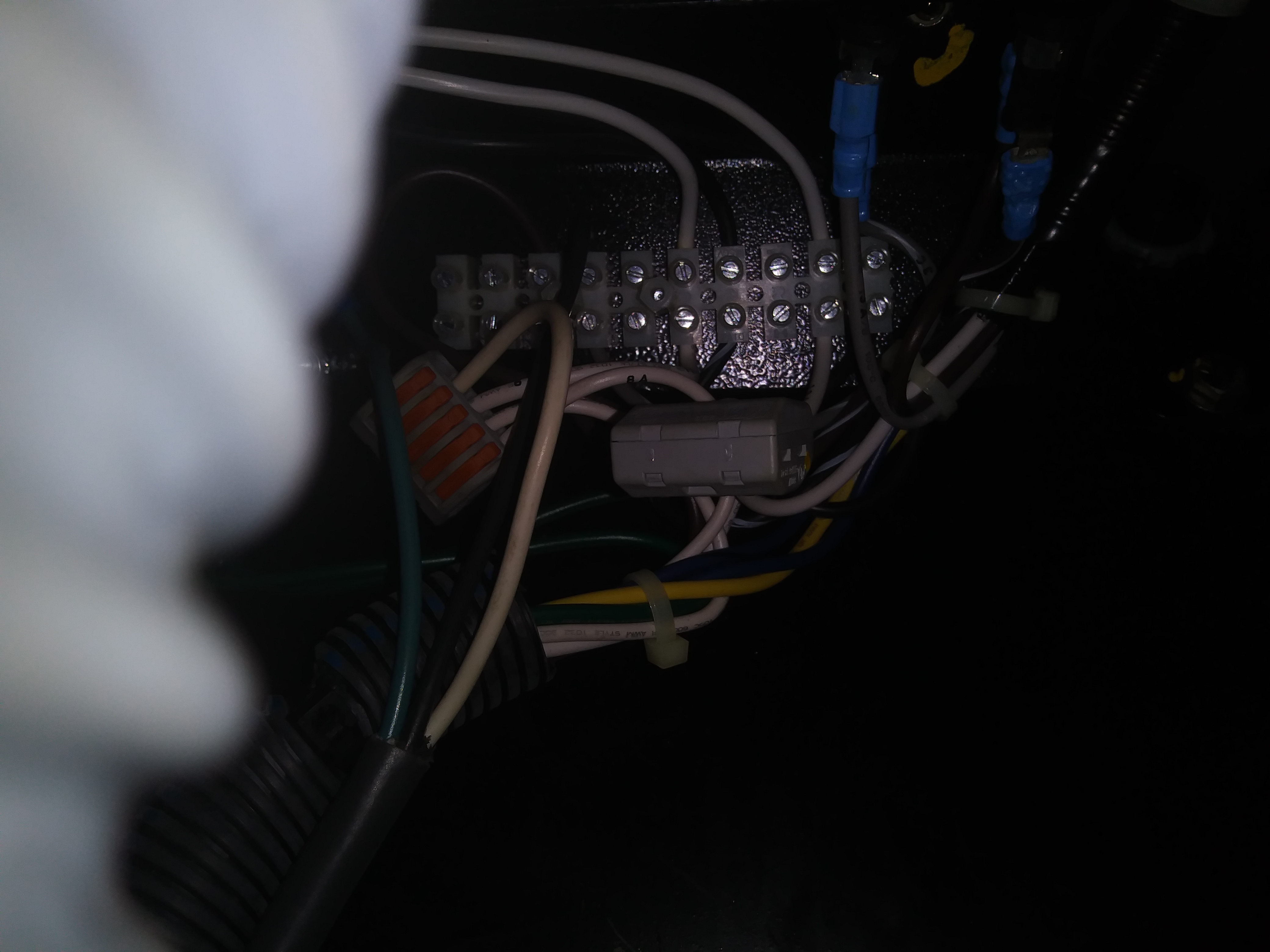

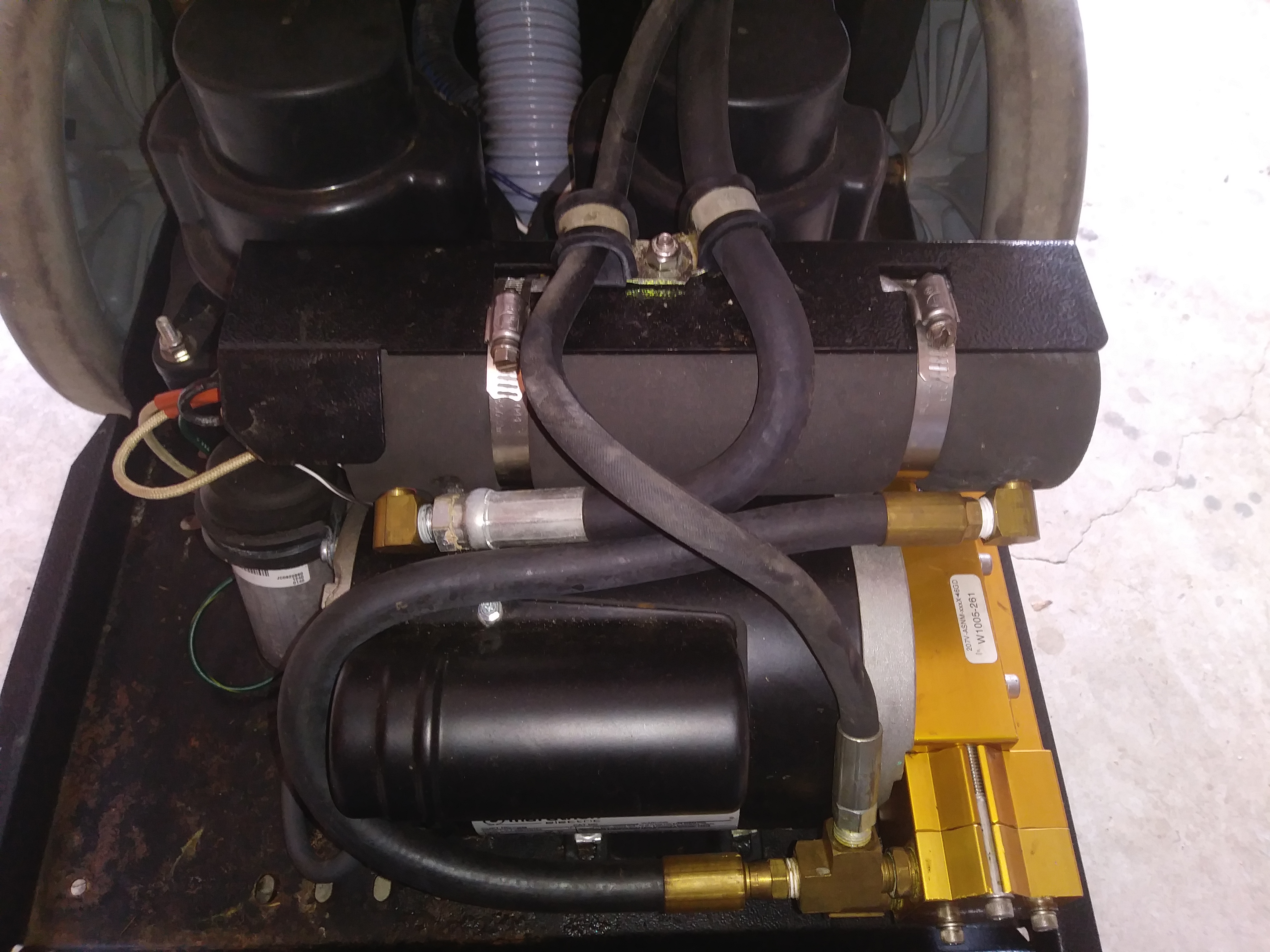

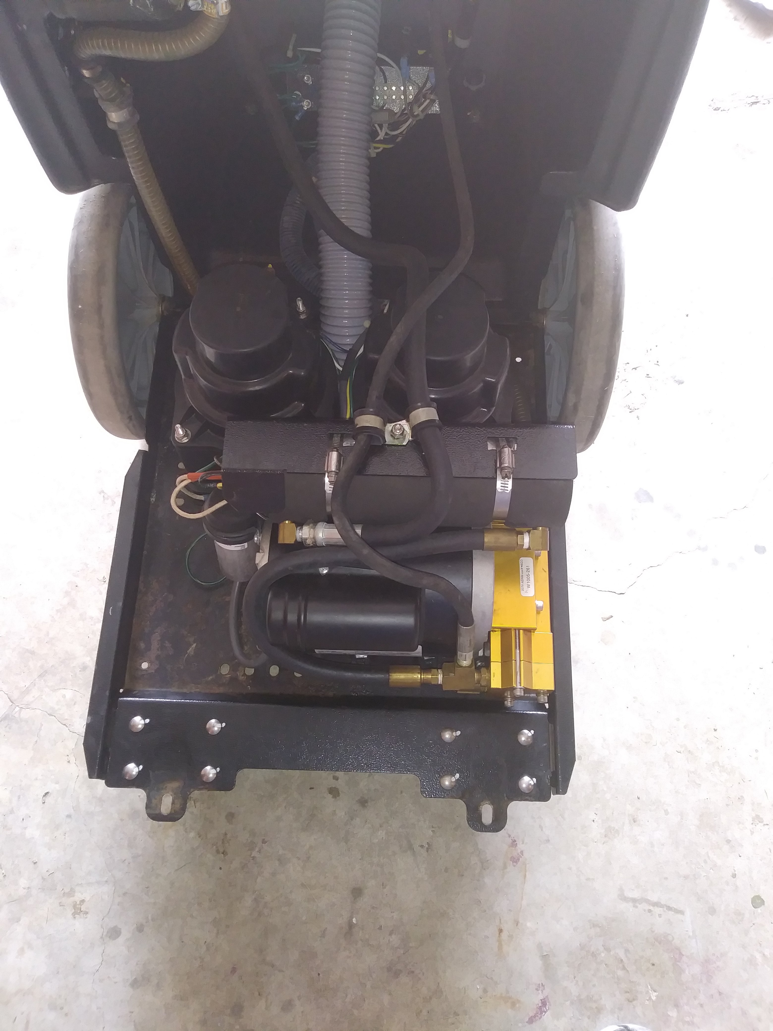

Here are those photos of the machine
27,867
The covers over the vac motors look a little oddball compared to most units. They are in parallel. They are probably only 2-stage as you wouldn't have enough power to run anything bigger with heater in there. It may be possible to ditch the heater and install 3-stage vac motors but I can't tell how difficult it would be without seeing the manifolds with the motors in place. If you did that, you would wire one vac with your pump and the other separately.
I forgot to mention that I had to get the upgraded pump motor. The original one was way thinner, this is almost the same size as my treadmill motor. What do you mean by oddball because I always had a weird feeling about this unit. I did buy it brand new from a jondon location so maybe this had a issue that they fixed before selling it
It appears that there are black plastic covers over the vac motors. Most machines, the motors are exposed.

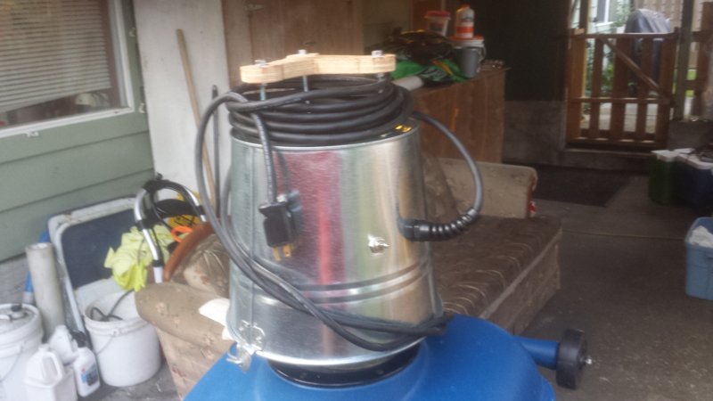

I've looked and I can't find pictures of my bucket booster experiment. I mounted a 3 stage motor on to the lid of my machine. It wasn't pretty but it gave me plenty of air flow. I'll dig around some more to see if I can find it.

There you go. It was mounted on a lid. It gave that old powrflite much improved air flow.It doesn't look pretty but it worked quite well
