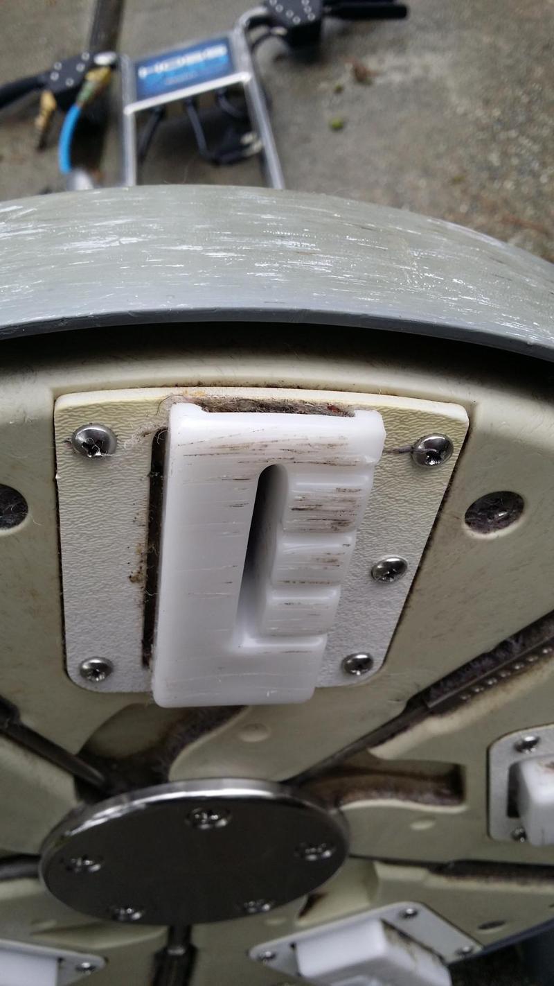

I have found that the rounded glide work nice on cgd. No lines in the carpet. Very smooth too.
