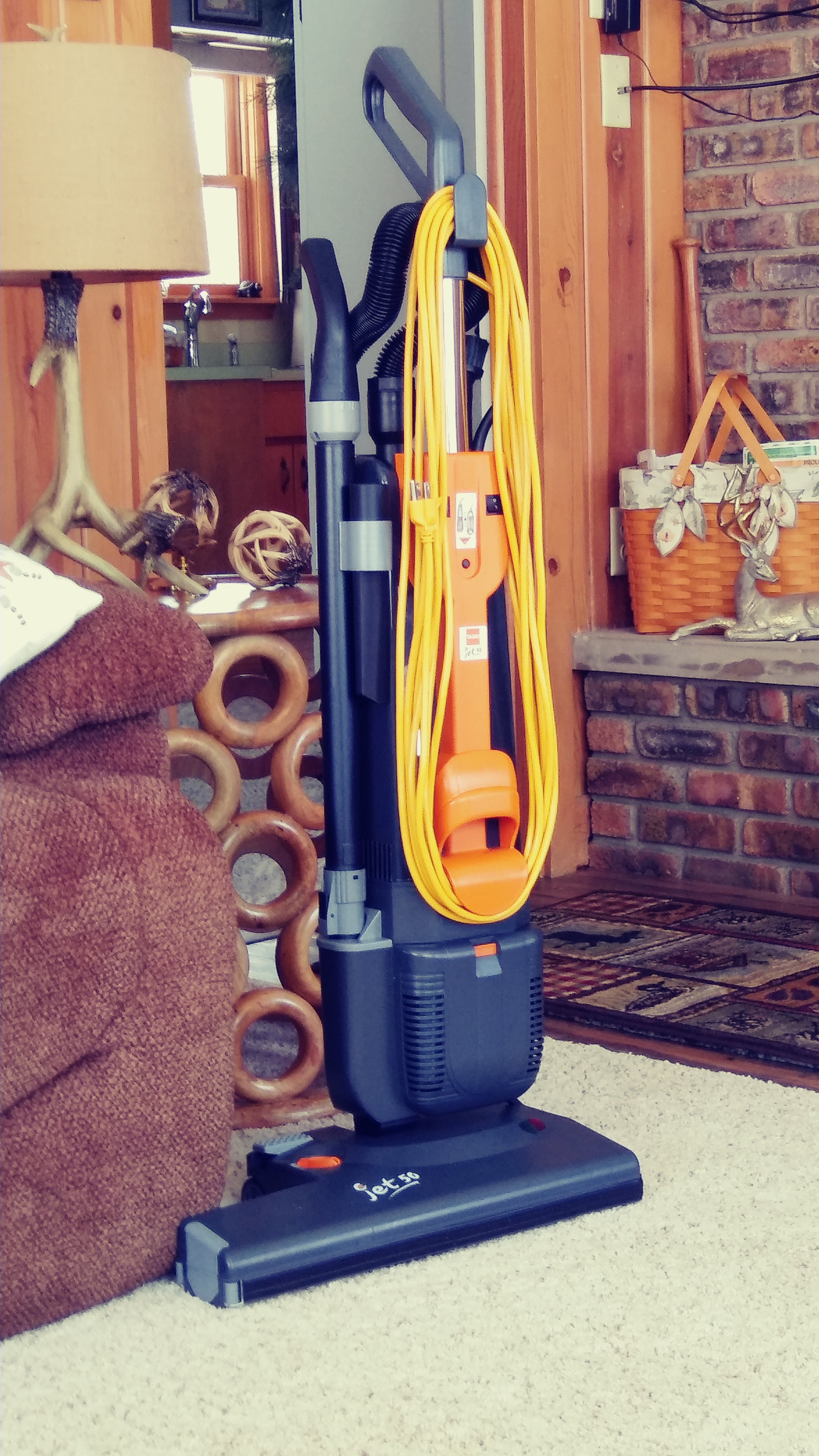

Oh LORDY!!! Will my customers take me seriously when they see this goofy thing in front of me?
The cup version failed!!! The vacuum was covered in dust from air leaking around it. It was embarrassing. If anyone buys a beast like this, get the bag. It worked great today

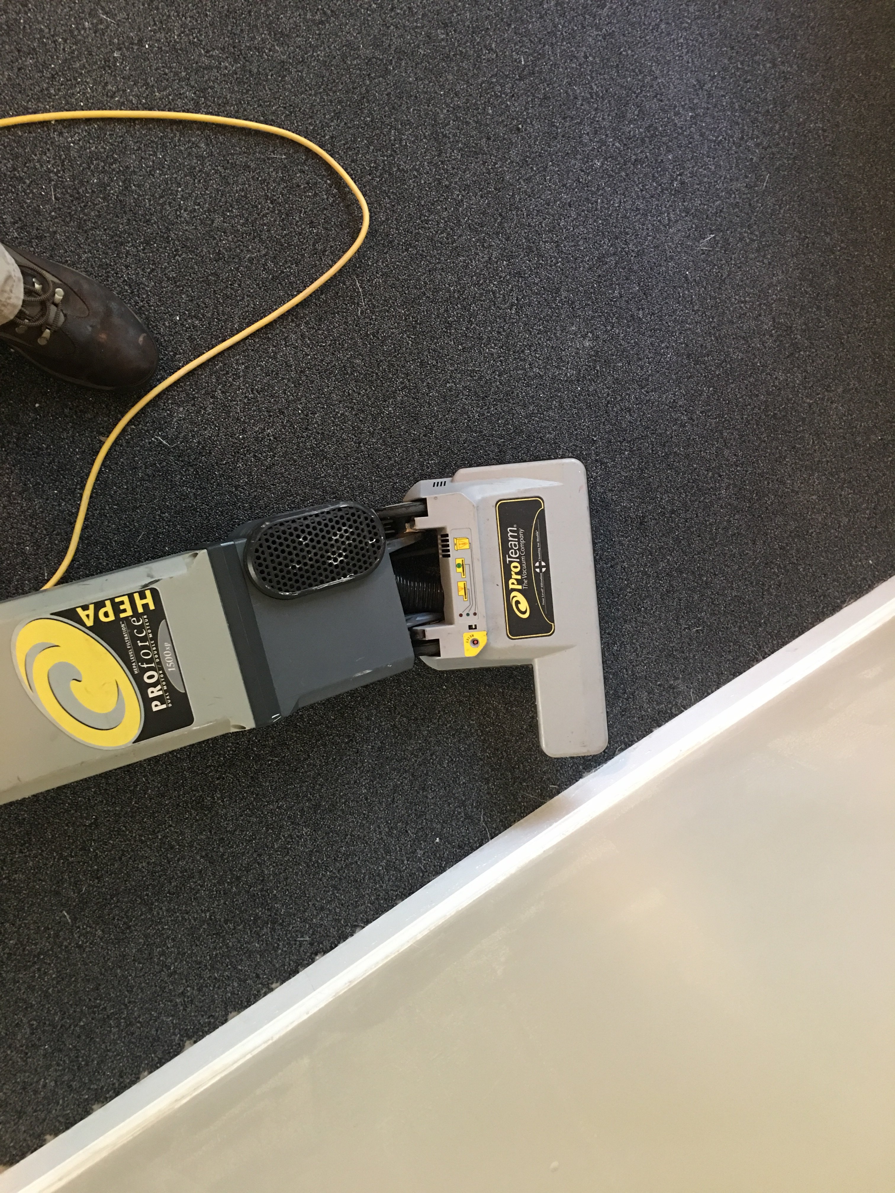

Yep. That’s Jimmy’s advice right there. It looks like I’m in the market for another residential vacuum. This happened about an hour ago
I should’ve used the ugly Hoover instead of this one

The thermal overload on the motor tripped. Remove the clog, wait about 30 mins and it will reset.
Yes that's what happened. I think the maintenance man was using it and we have several 17 year olds so I need to keep a closer eye on it I guess.

Unless it’s actually broken, ITS SUPPOSED TO DO THAT.... that’s how you change the power head, or put a different size head on... 12”-15” for example.....
