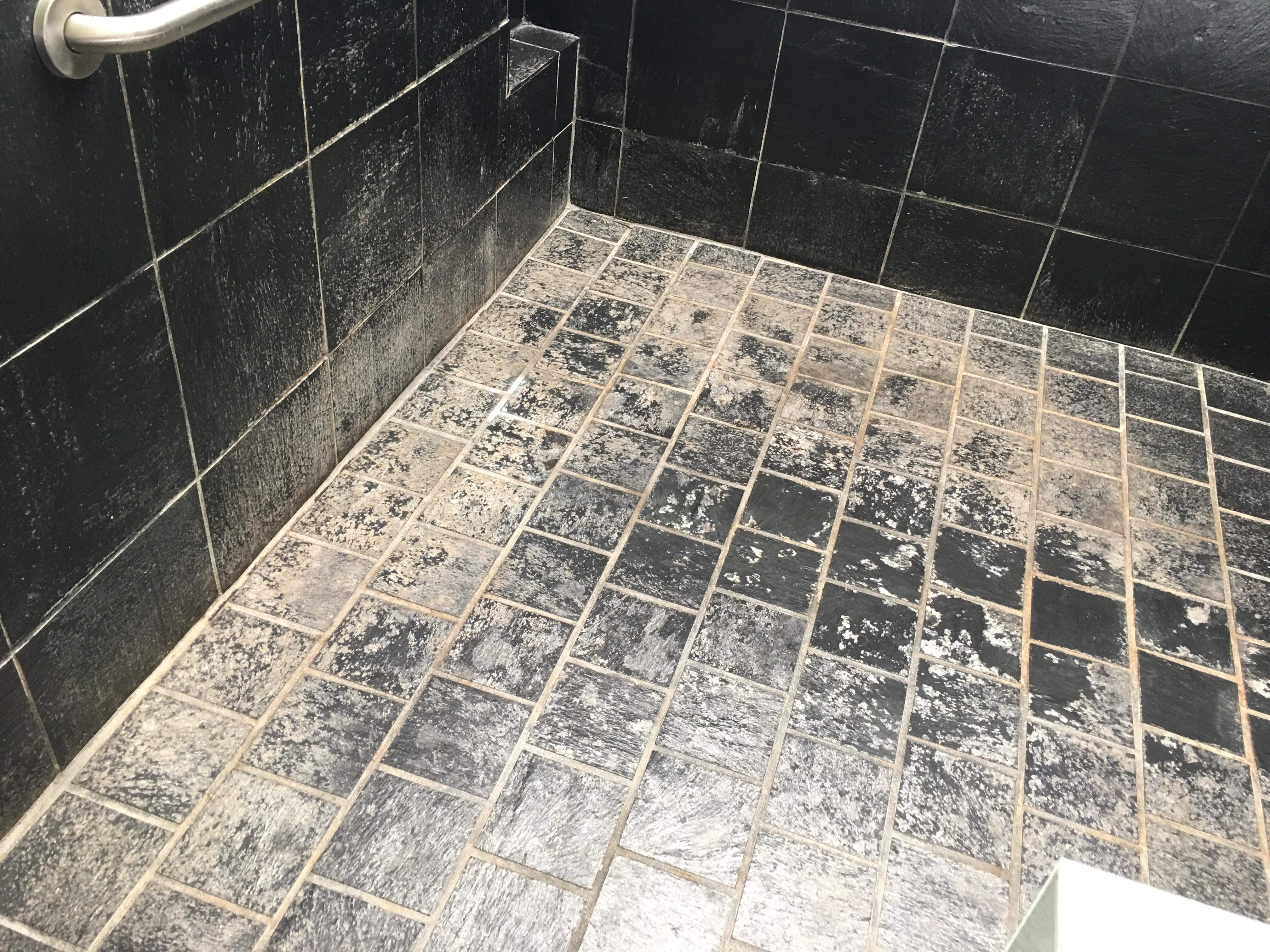

I've yet to see a Enhancer that was a topical.
Typically they are a penetrate live with a wood stain like additive, which make them oily. They need to to be wiped or buffed off after a few minutes of saturation.
Looks like this owner didn't do that properly

I started with 12ph tile spray/floor stripper, scrubbed, rinsed, another 12ph, scrubbed, rinsed, prochem acid, scrubbed , rinsed, acid again scrubbed rinse, back to alkaline scrubbed and rinse and it came out like this. As it’s drying it looks more and more like crap. I almost wanted to get some oil based black paint and roll it all over this crap
14,496
I’ll get another pic of it completely dry this afternoon.
Would a coating of enhancer help keep it looking black?
116,969
Enhancers are not coatings... it'll look good for about two showers and will go down the drain and they'll never know you did it

looks much better. Ive fixed some issues on slate in the past by wet sanding with 100-120 grit sandpaper.
in my case it was a floor covered in scratches

Update. This is after the impregnator sealer that they used on it. The last pic was just after the enhancer

My shower dries so quick I think I could pull off a stone shower if I use triple distilled RO water..
14,496
That’s why I told her to send me another pic 2weeks from now. We’ll see. It’s been a good learning job for me
