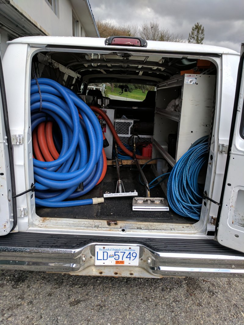

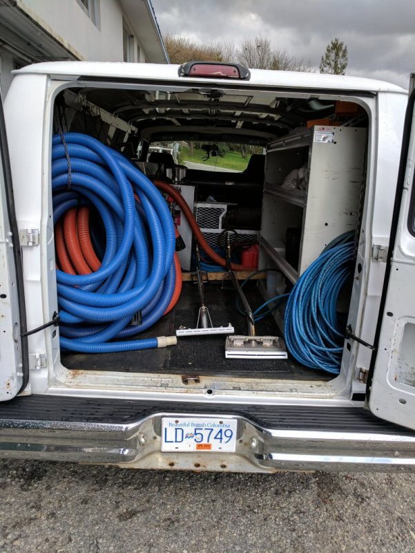

Hey Lee Stockwell I'm thinking about removing the manual vac real and just roll and stack my hoses. But I'm also thinking about moving the lint trap from the back of the van to the side door next to the solution reel.
That would open the back up some more. I'm thinking of building wood drawers or shelves on the driver's wall for all the tools and wands. It would Nestle in beside the waste tank.
Any thoughts?
28,154
Steve, I hang my hoses on bungee cords from the side of the van. It allows me more room for my portable and misc stuff. Also I can take them out if I need to. Once you bolt a hose reel down, it's never coming out. I usually run with 200 ft in the van and add more when I know I need it.
I can only carry 200 ft on the reel and I'd like to carry more. Stacking them on the floor where reel is would accomplish that and allow me to move the lint trap.
28,154
You could remove that filter box and go with a devastor filter. That would give you some room for shelving. Looking at your van layout, I would keep the hose reel and just add extra hose when you need it. 200 ft is good for residential and most commercial. Just throw another 100 ft in the back for those bigger jobs. Biggest job I have is just over 350 ft.

I want to dual wand and throwing extra hose in the back takes up to much space. And my reel is manual so it sucks imo. I took mine out of my bane too. Found it easier to just roll them up. Now when I get an electric reel I'm sure I will love that.

You use 2 prefilters? Just go to the paint bags and you should be good with the white magic filter box. Dual wanding is the pot at the end of the rainbow. Most of the time it doesn't equal the productivity increase you wanted. I know some people dual every day with just 2 people. I personally have found that one guy and a rockin helper that can keep the wand moving, will get more done than 2 people wanding separately. Just leave your truck set up for what you do 90% of the time.

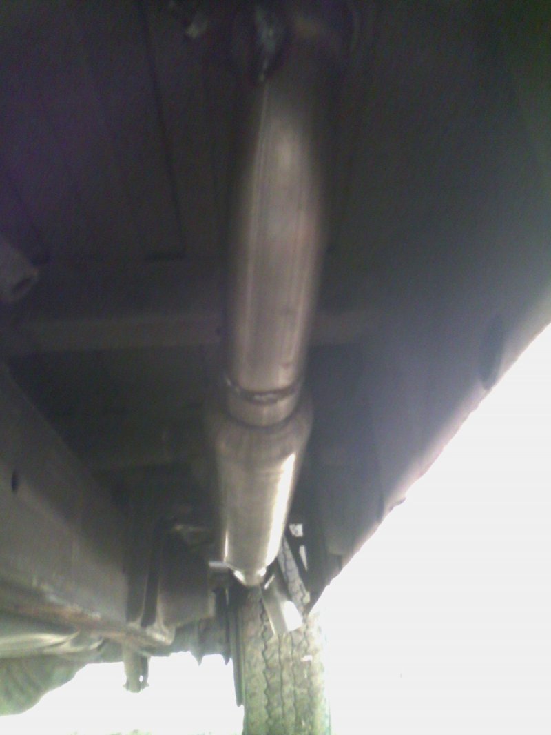

May try and put a new silencer or muffler on the blower to quiet things down some more. The heat exchanger that leaked is causing a lot of noise I think. I need to remove it from the system.
I tried removing the hose reel and coiling hoses but put it back in. It just didn't work like I thought it might. The reel needs some repair too.

I pulled the heat exchanger from the system today. Had a shop run a pipe from the blower to the silencer.its quieter inside the van now but seams louder outside.
