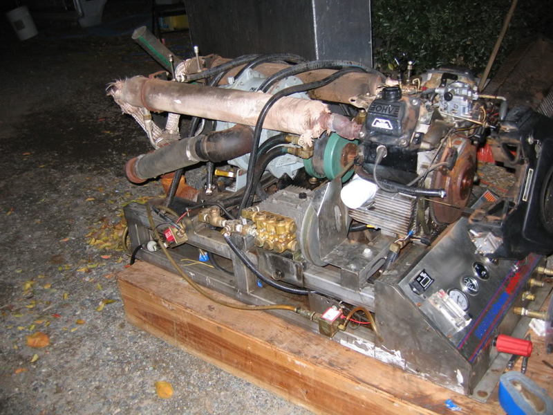

dude get it, $1500 is decent, yeah some money has to be dumped on it, but hey almost what used one doesnt...
I have one of them tanks, and while i wish it was a few more things, it has made it sweet to pimp...you can get your true flow of CFMs and lift through that....
I hate the fookin filter set up in it though...little nubber things...but what ya gonna do??
of nothing else and you have to buy a motor or blower or what have you, at least you have a frame to place stuff....hell how much is a frame to get made??? let alone to make sure you have the right spacing...
I havent torn through those exchangers, but kelly over at steamaction supply (no relation to the machine) has re-built a few and could help you out...

I don't want to bust on Larry, but something tells me if I call the SteamAction 800 number right now, they will make me the HX I need for that unit.
But....it'd have to be pretty F'd up to need a new one, they were built like tanks, any decent welder could put it back into action.
The engine and blower are worth $1500 right now to someone that needs one, or some dude in N. Cal that is using a #3 blower 16hp machine.

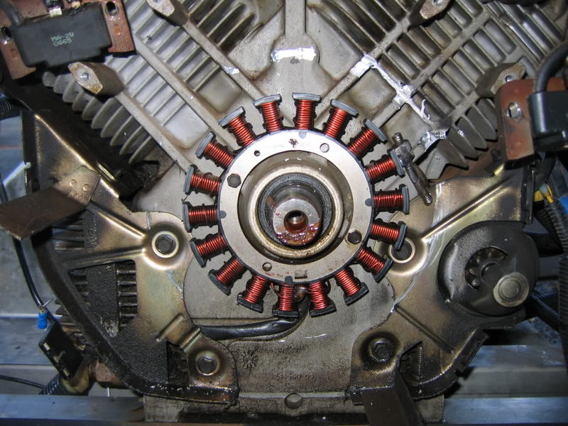

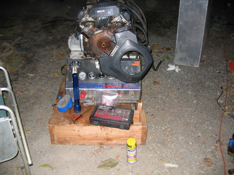

Dang it, anybody got a 25 hp kohler, first took spark plugs out well one at least the other took awile to get because it was frose in there and strip the threads out coming out, so I ran around to find a heli coil and got back and started messing with the machine was able to put the old spark plug back in and spun it over and didnt shoot out so I thought well I'll try to start it now. so I hooked everthing up to just start it ran it for a few seconds rev it up a little and it was running just fine and then hell broke loose like when you blow a motor but no noises leading up to it. look like the sparks and small junks of alluminum came from the front like where the air cooling fins are no visual marks of what broke I know the motor wont turn over right now so I've got to tear it apart to find out what happened. this thing is aready starting to bite me. but blower sounded fine.

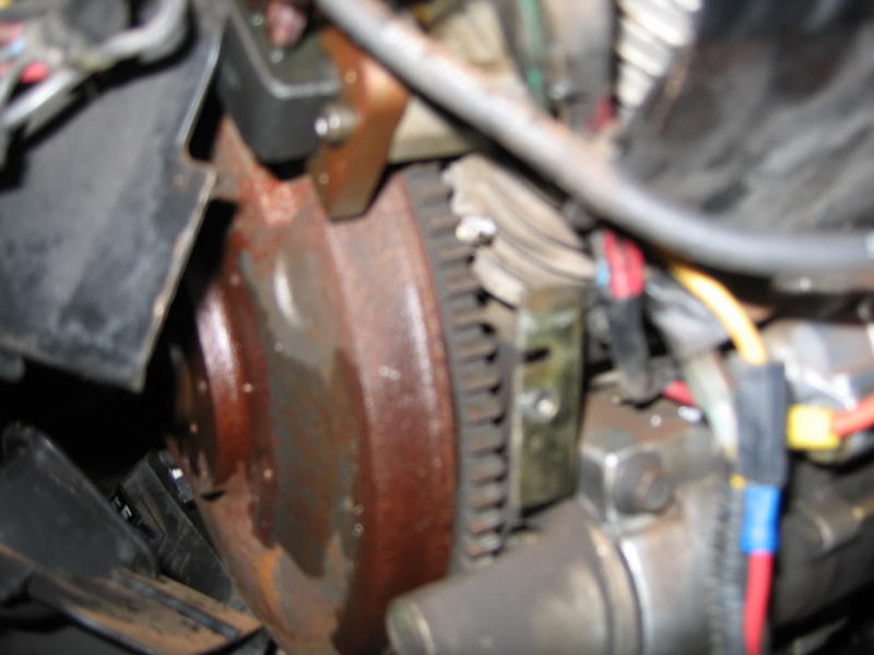

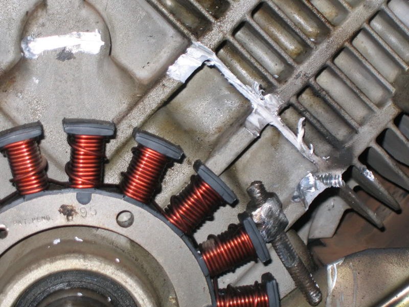

Well I went out there again when I had a little time and tore into it and got so far as the fly wheel and didnt want to go find my puller for the night but I found part of the problem there is looks like a 2 inch bolt that is stuck in between the fly wheel and the crankcase and the alluminum chunks look like little bits of cooling fins so until I have taken it apart all the way I wont know the extent of the damage. will update yall though. I kinda miss spinning wrenches.

Shit happens when you buy a used machine. If the blower heat exchanger, pump works you'll be in good shape. If you have to dump a couple to a few G's in it you'll still come out with a good working machine and you'll know every sq inch of it and can do any repair yourself. I think we all knew that some $$$ was gonna have to be put into it.

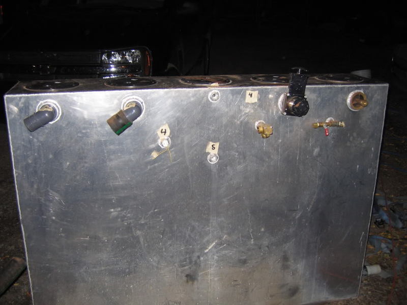

I was talkin about what he paid for it.It has froze see the gauge? so pump is probably gone and maybe the hx and those are not as bullet proof as greenie thinks but they can be fixed I know we've fixed those same ones 4 times now. Next it is covered in dust which has been wet more then once so the blower probably has rust an the engine would be iffy which we now know. all these things put the machine at 500 or less. Now some people said the parts are worth xxx well the used parts market aint what yo think it is. I have 5 blowers sitting here and they aren't flying off the shelf same as the used engines or pumps. So i'm not bustin' his balls for buying it but anyone that said it was worth more then $500 and that might be a stretch.

i would change all of the fluids before you even turn that rig oer

A piece of the Carb on the 27hp Kohlers rattles loose and falls into the engine and trashes it. (Found out on the south side of the factory warranty to the tune of FIVE GRAND!)
Look for something like that on the 25HP... bound to have something like that...

Well she is back together and running like a champ hook up some water lines and got a couple leaks but pump is working I think the pressure guage is jacked up. Blower works fine good suction still some reworking to go on.

Ignition coils look good along with the alternator. How is the flywheel? Looks like there is no major damage.
