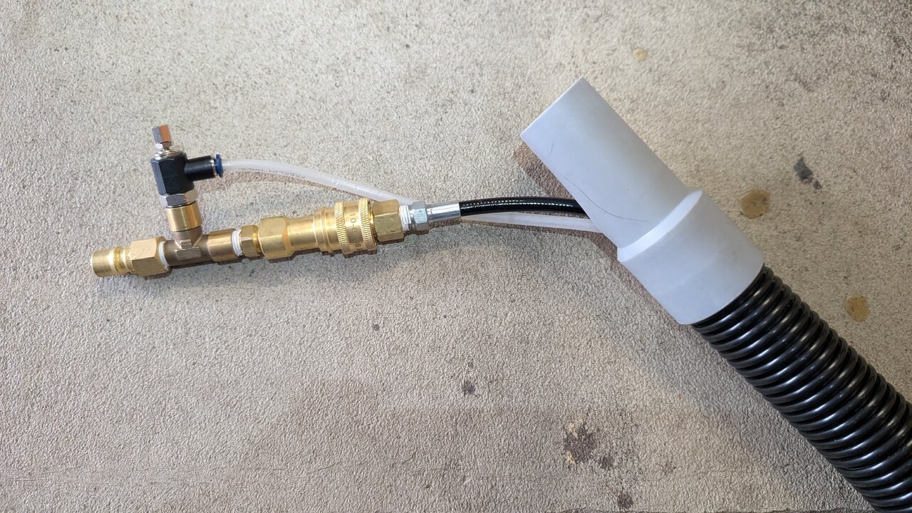

This is what i use to bypass on all my upholstery tools its built from off the shelf parts from a kleanrite solvent tool. It's simple and can be easily removed if necessary
View attachment 129914 View attachment 129915 View attachment 129916 View attachment 129917 View attachment 129918
Forgot to say , the short teflon hose is there so as the jet of hot solution doesn't cut a hole in vacuum hose(and it would). The teflon hose is connected to a small orifice used inside kleanrite solvent extractors return line
