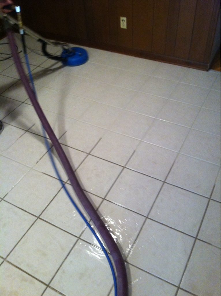

No floor is perfectly level.
Spray it, mop it, whatever, after 10 or 15 minutes dwell it will pool. Resulting in inconsistent coverage.
Use a CRB and you can use less product, makes the job easier to rinse and better results.

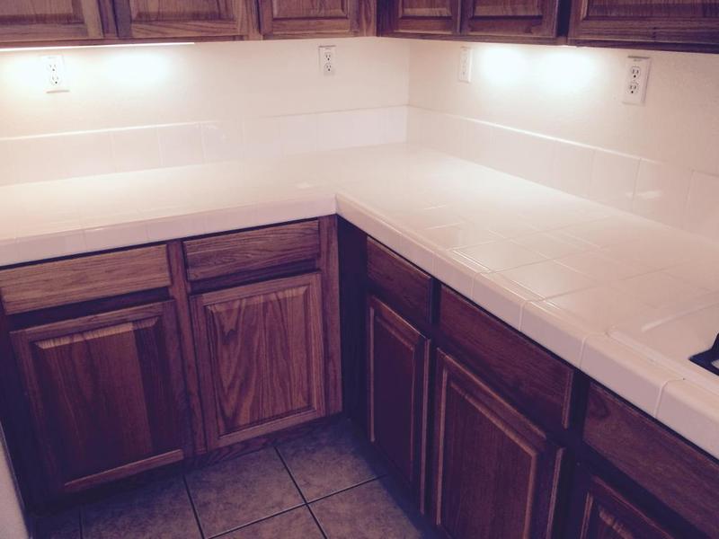

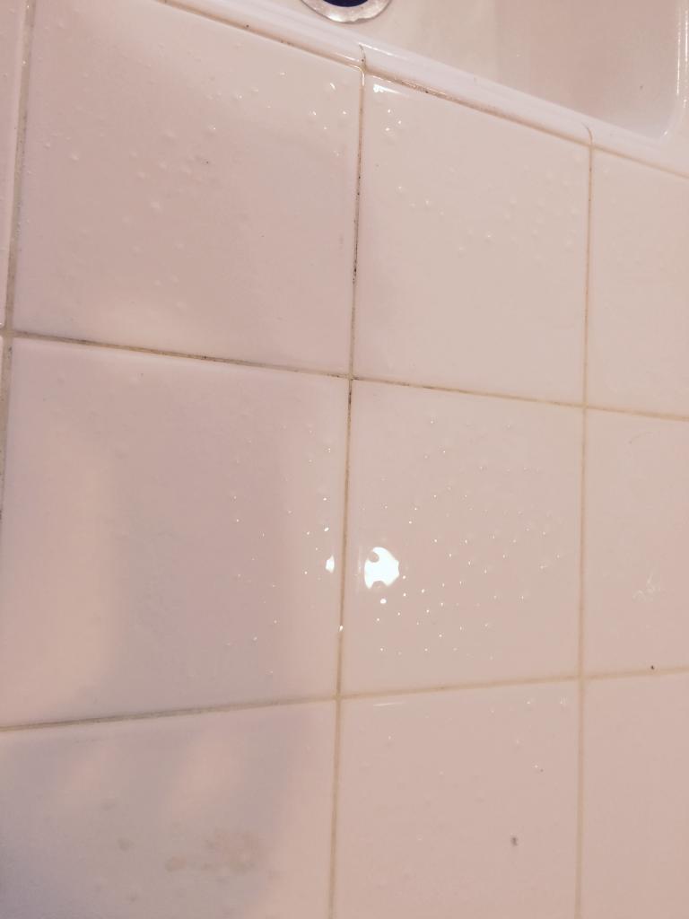

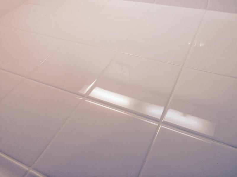

I can't think of the last time I've had to scrub a tile job. The one it did Friday had an 8th of an inch of black crud on the grout.
Hello Marty, what machine are you using these days? How hot does it get and what chems and dwell time are you using to get these miraculous results? Do you mix your chems with cold or hot water? What kind of sprayer? How do you get the edges? What tools or rotary do you use? Do you wipe up the edges kneeling or standing up? Air mover to dry or not? That's a start. Anyone else have a question for Marty?
49,300
We didn't scrub this one.
