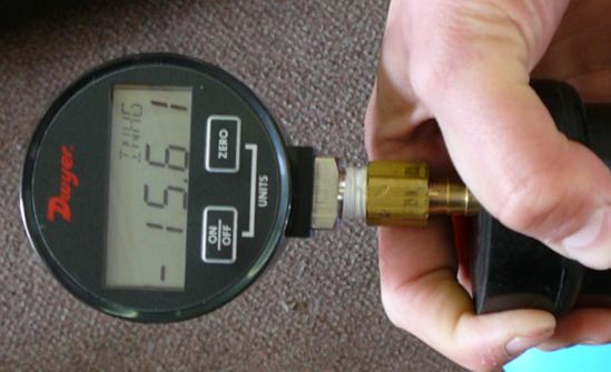

This is what a REAL Mytee modified portable delivers @ sealed suction:
15.61 in hg . . .

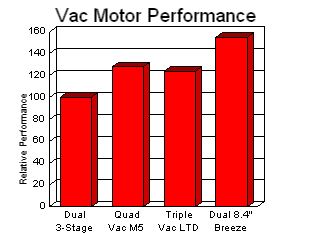

Also have performance on the carpet in these graphs :
More info at our web page:
http://www.cobbcarpet.com/zen/index.php?main_page=document_general_info&cPath=63&products_id=5110

the measurements at the machine mean nothing
Agreed, but...
Assuming no leaks, sealed vac readings will be the same no matter how long the hose is.... The readings will only be different if there is air entering somewhere along the line. The longer the hose, the longer it will take the reading to stabilize (so-called rise time).
he should put it at the end of a 100 feet of hose
Yes - readings at the end of the hose are what's important - but not sealed vac. How much lift is generated with the wand hooked up and on the carpet - that's what is important. I can build a vac system that will generate 28" hg of sealed lift (380" WC) and do it on one cord, but when you hook it up to a wand it will not extract one drop of solution from the carpet.

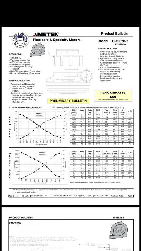

High lift equals low cfm. You can't suck a basketball through a straw.
CFM testing is a lot more difficult to test for than waterlift / sealed suction. The easy way is to just measure the amp draw on the motor under operation (no hose, hose, with wand etc, your choice) then compare the amp draw to the data sheet (attached), read over to Lift or CFM and you are in the ballpark, probably within + or - 2% worse case. If the motors are in air parallel you are dead on, two motor CFM.(2 x 115 CFM= 230CFM) if in air series use only one motor CFM. Since I am at elevation, at 8000feet, the air density is way lower so I will have variations in flow, the motor speed will increase slight so the CFM will be higher.
