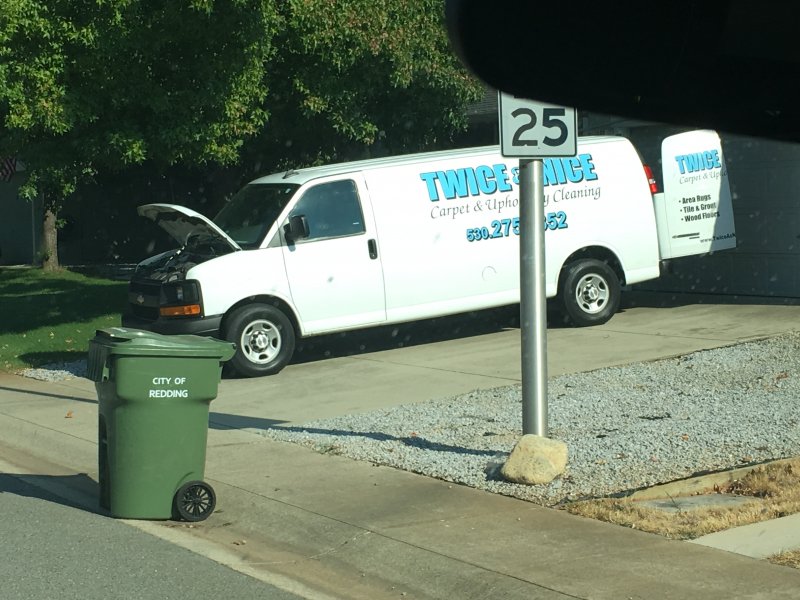

I run my slide-ins with the hoods off.. "They say" it disrupts the air flow from the cooling fan.. I don't buy that, I think open is better. I wouldn't want my van sitting in a driveway with the hood open..
24,043
I run my Amtex with the hood up.

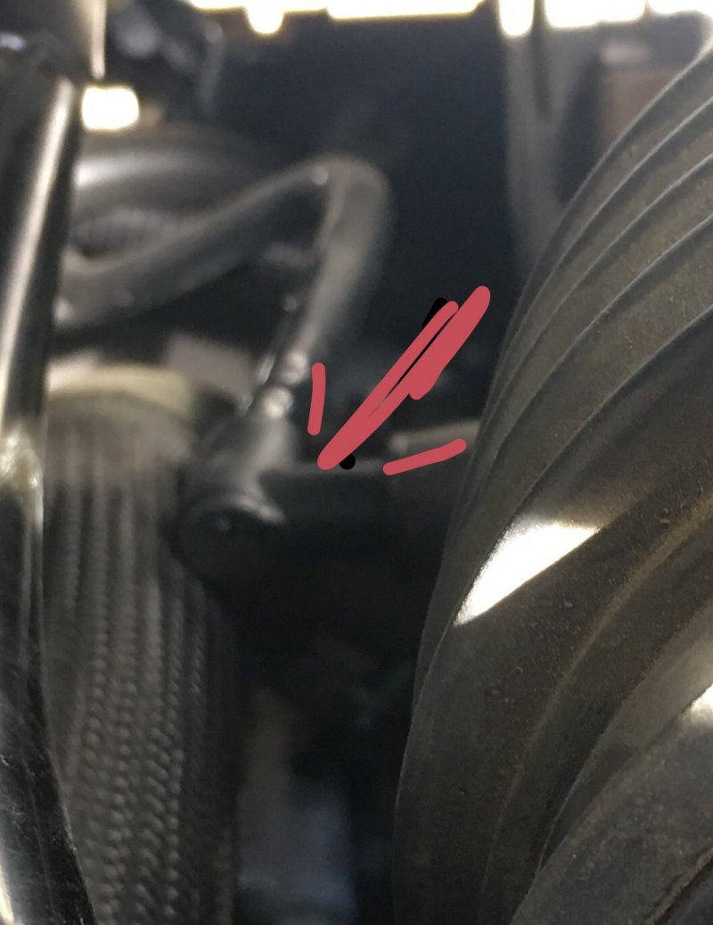

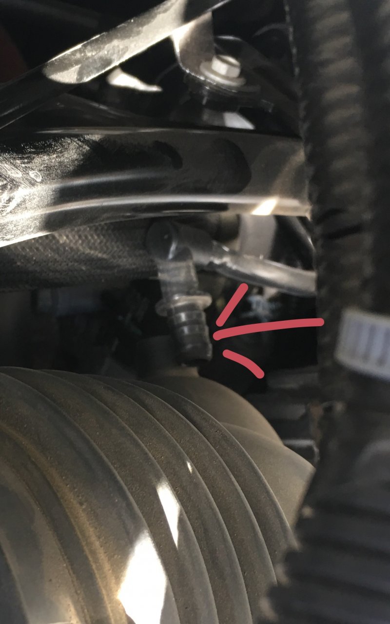

Not sure if this would cause it because like I said it clears when I drive for the most part and happens when the truckmount is running.
Pretty sure this isn't right though
24,043
looks like a vent tube or a vacuum line. If its a vacuum line, it can mess everything up while it's off. Very simple fix but annoying to figure out if you don't know it's the issue.
11,297
Ok so the light was on when I found the vacuum tube off,
Stayed on until the next morning as I went to a huge job, van ran for 5 hours and the light stayed off.
Gotta guess when the guy who put in a new serpinetine belt that was precautionary warranty work for free by sapphire he pulled all the air stuff off to get at the belt.
He probably just didn't reattach that one.
