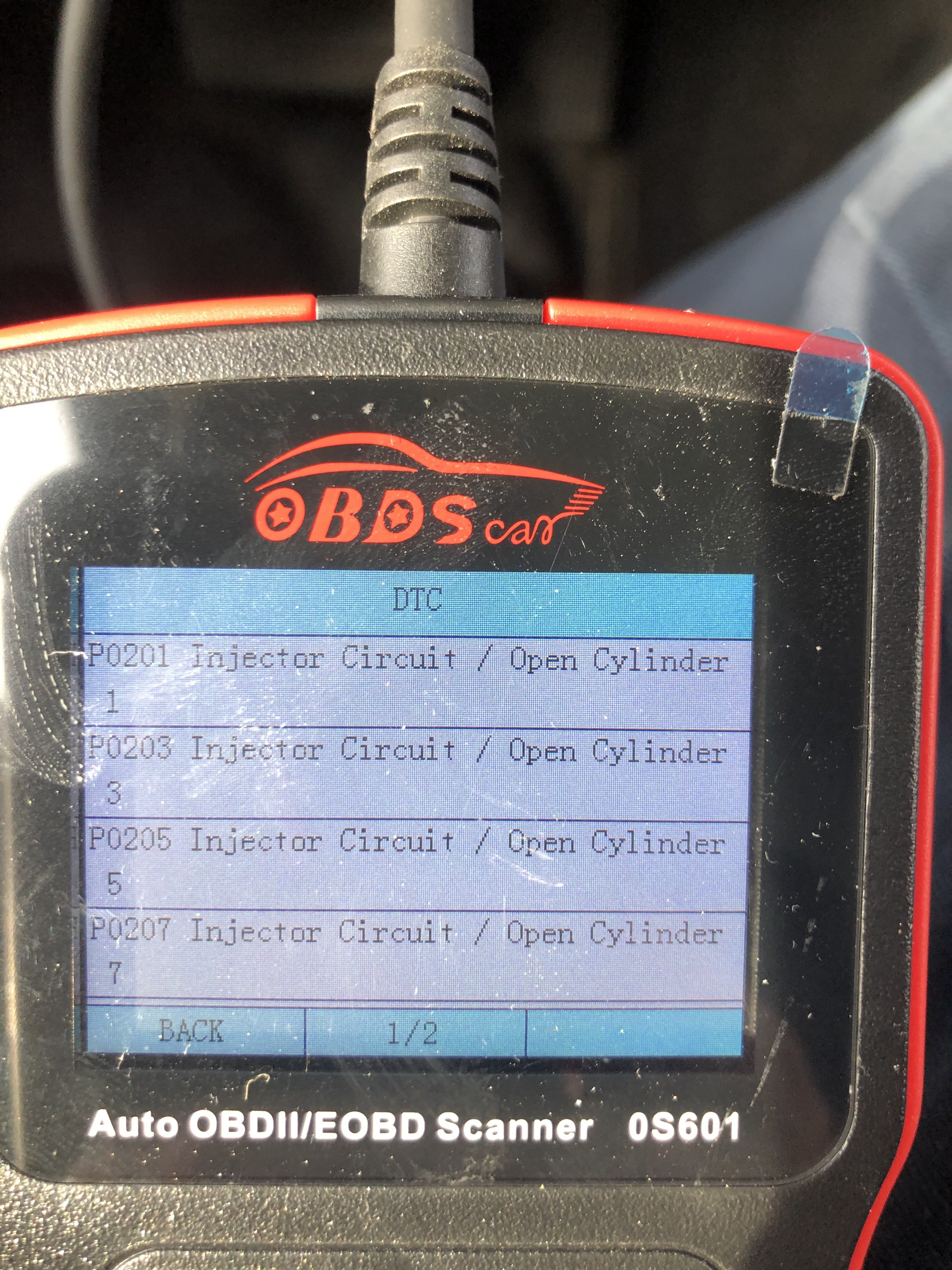

Ok update, dealership says it’s two injectors and the engine needs to be torn down to fix.

The number one injector was getting 12 volts way to hot.
Over a week ago. Was supposed to get a harness in Thursday and let me know if it was fixed.
