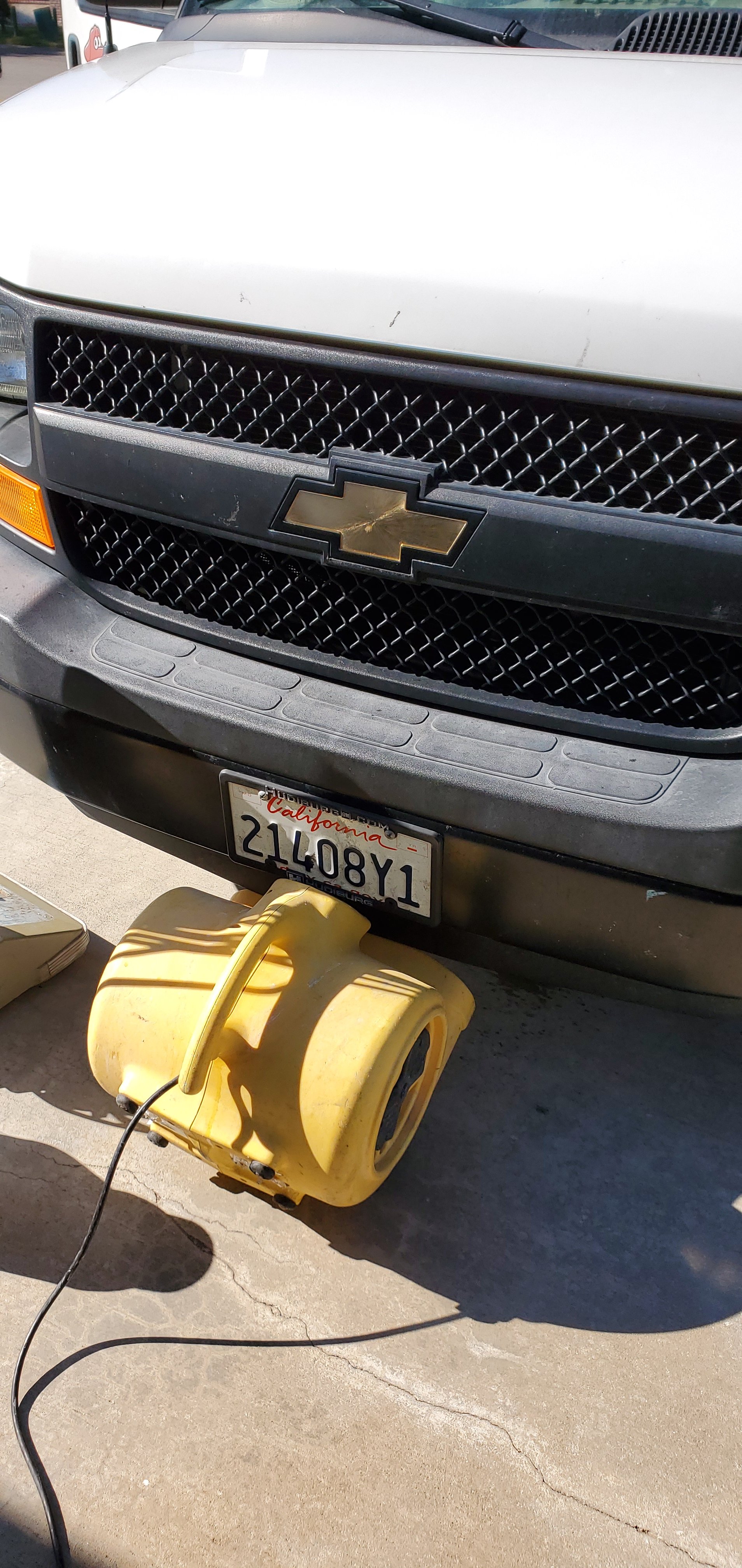

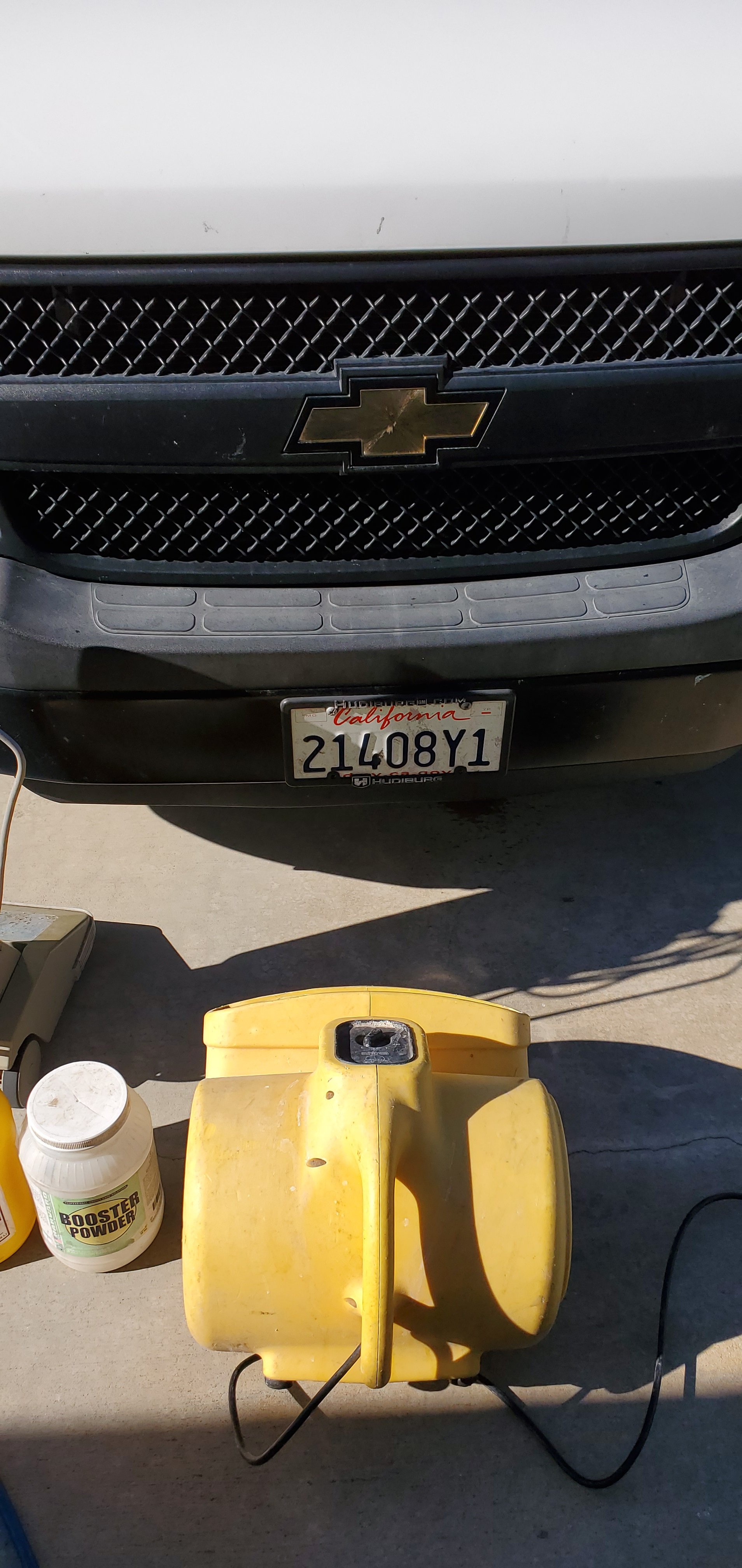

would you expect it to?Blowing a fan at the front makes no difference with air flow.

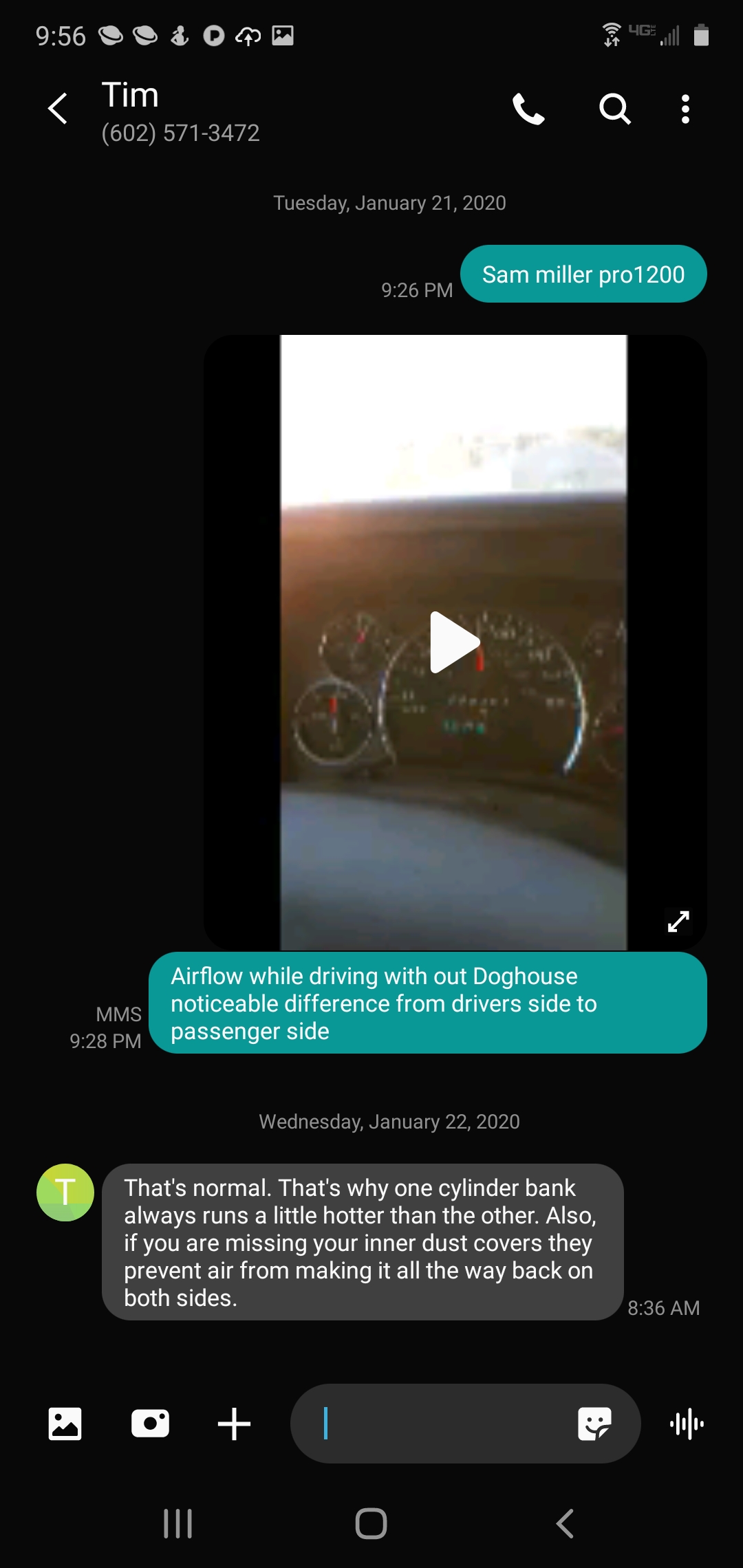

Couldn't feel anything until the van fan kicked on
And only on the passenger side could I feel movement of air.
I wasn't sure but that's been suggested to help cool it down.would you expect it to?
and isn't their a lower radiator baffle?
Iam saying it doesn't appear to help.
Its was bank 1 bank 3 bank 5 bank 7 open injectors.Not sure what he is talking about other than there are usually plastic pieces like the baffle ,shroud, cover etc that direct airflow.

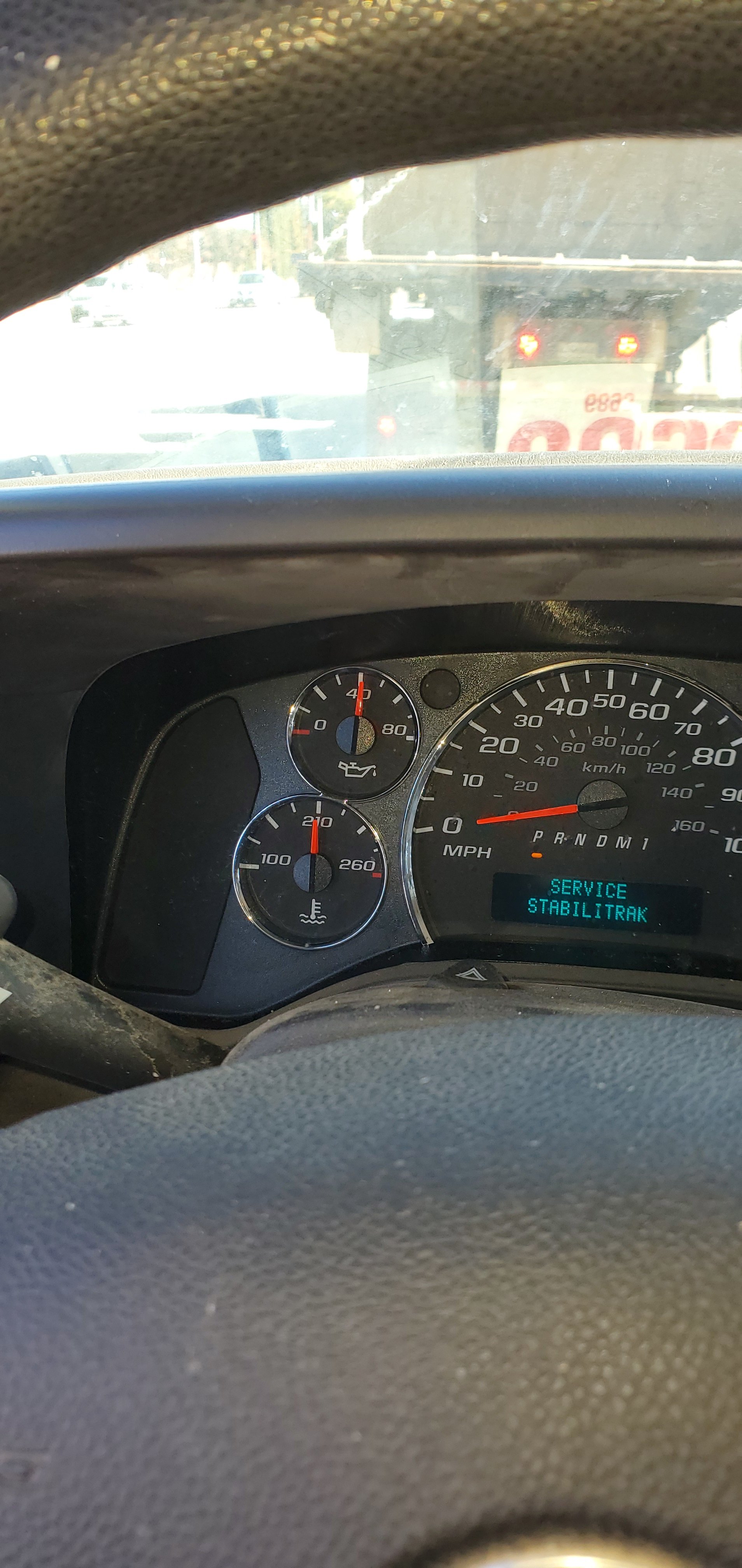

Is this confirmed to be the same issue or could it be another? If it is confirmed the same what are the codes and what year/model/engine?
You would think the dealership could check that???Sounds like it's your engine control module. Your engine is designed to save fuel by turning off cylinders when you don't need full power. The ECM is what tells the engine what to do. I don't know where it's mounted but if it's under the hood, the heat could be causing it to malfunction.
It's really hard to check. Better to swap in a good one to see if it makes a difference. I had to replace an old one on my dodge. The first 2 were defective. The third one was the charm. Only had to pay for the third one.You would think the dealership could check that???
