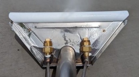

why get (striaght down) extenders when you can install these?
44,241
La La Land
Nice.....i got THREE AW29s to rebuild....i lik them bender doo-hikies
I'll be in touch when my goin gets going! You sellin any soft touch triggers?
