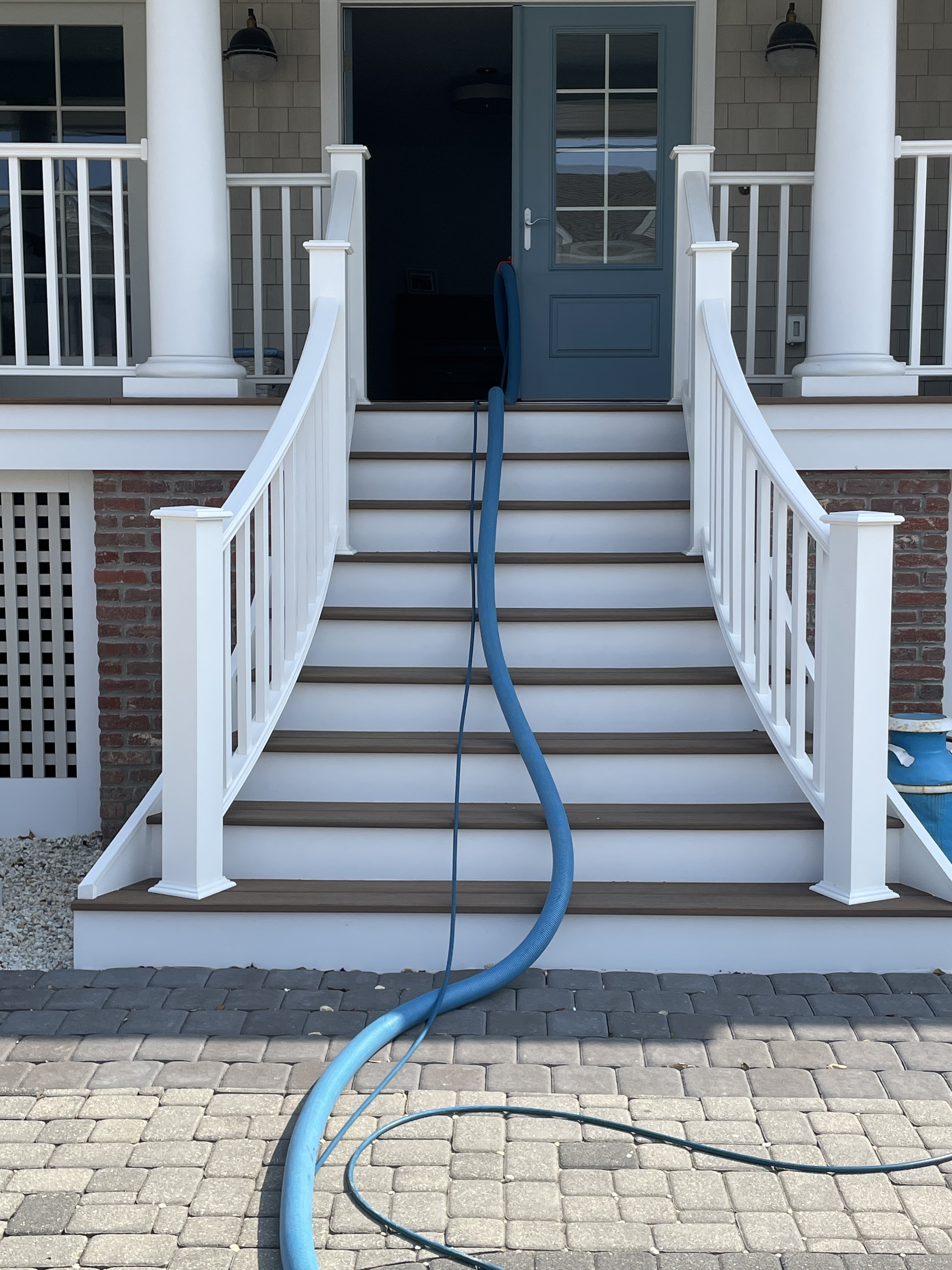

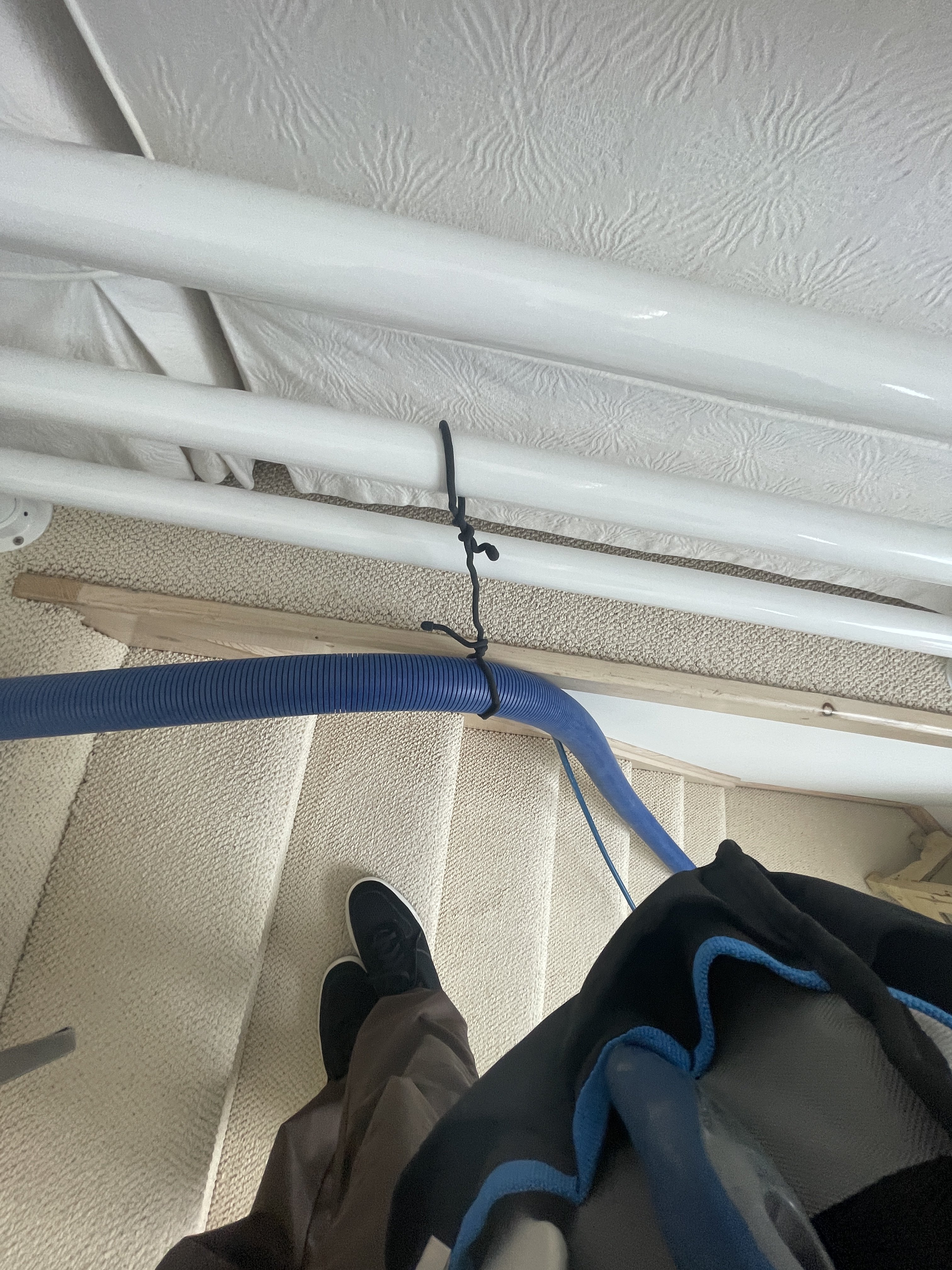

It was getting late, did not want to pull out another section for 5 feet, so i ran a tight line. Without the ties it would have sawed away the corners. worked perfectly.

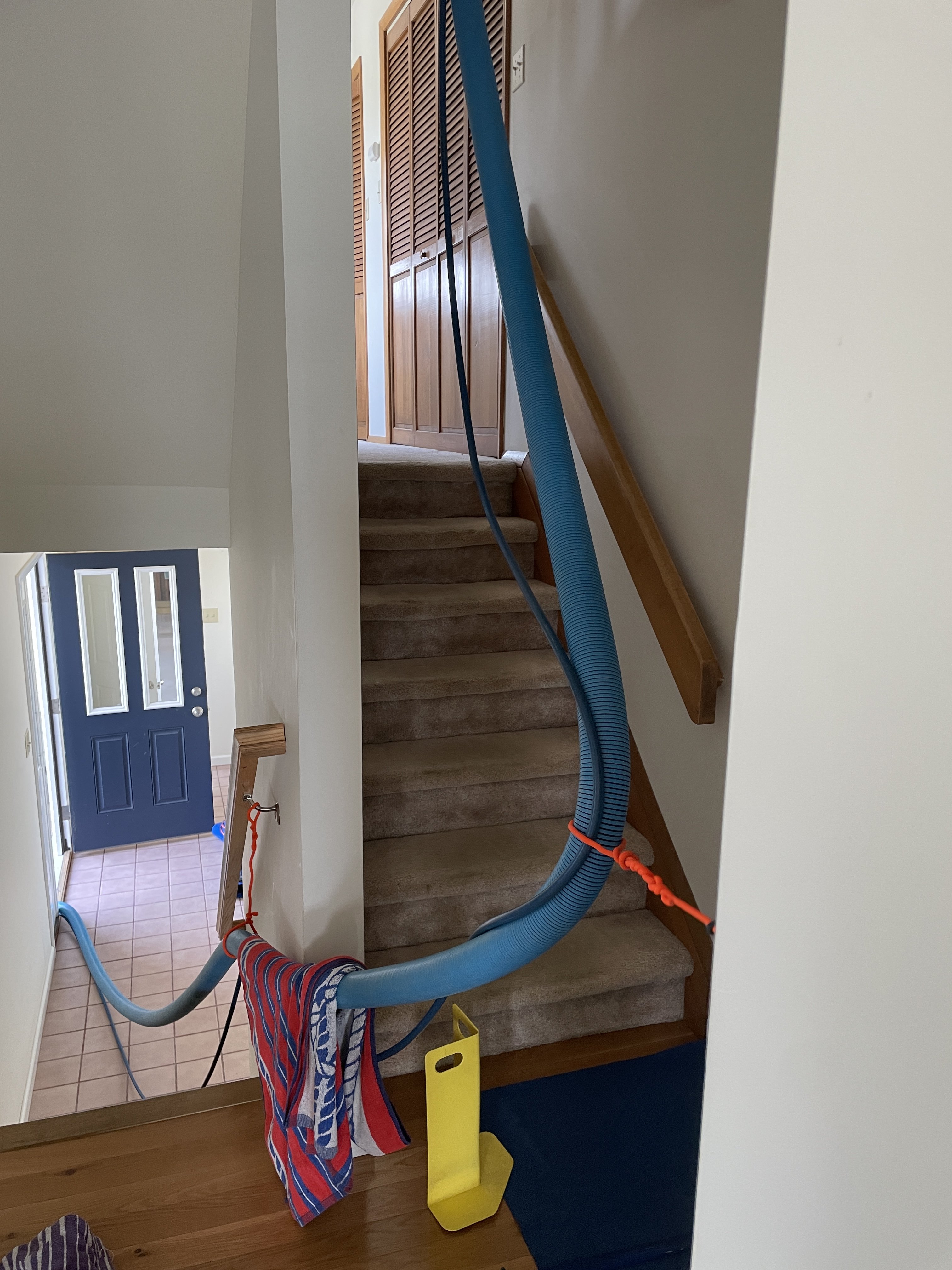

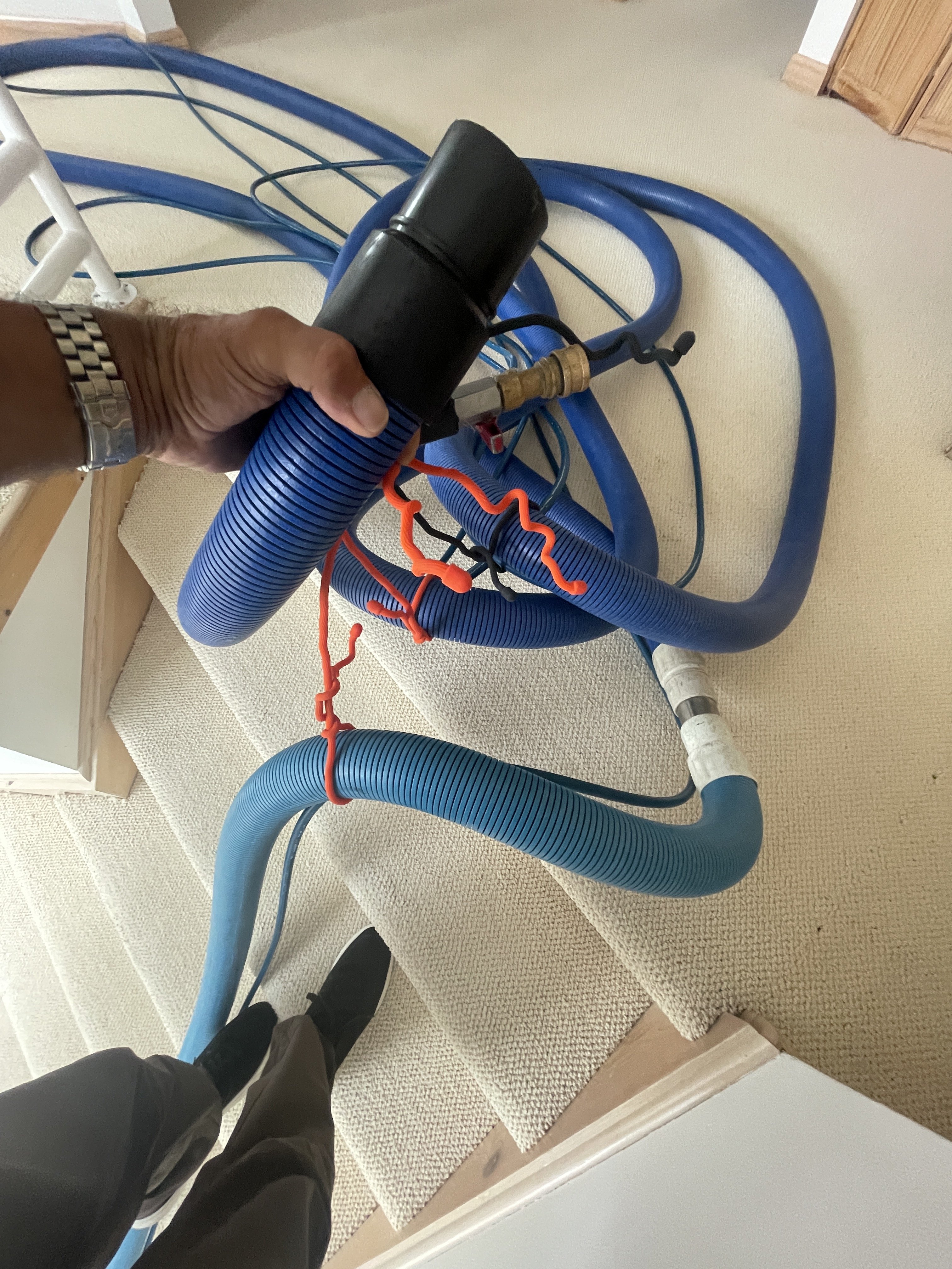

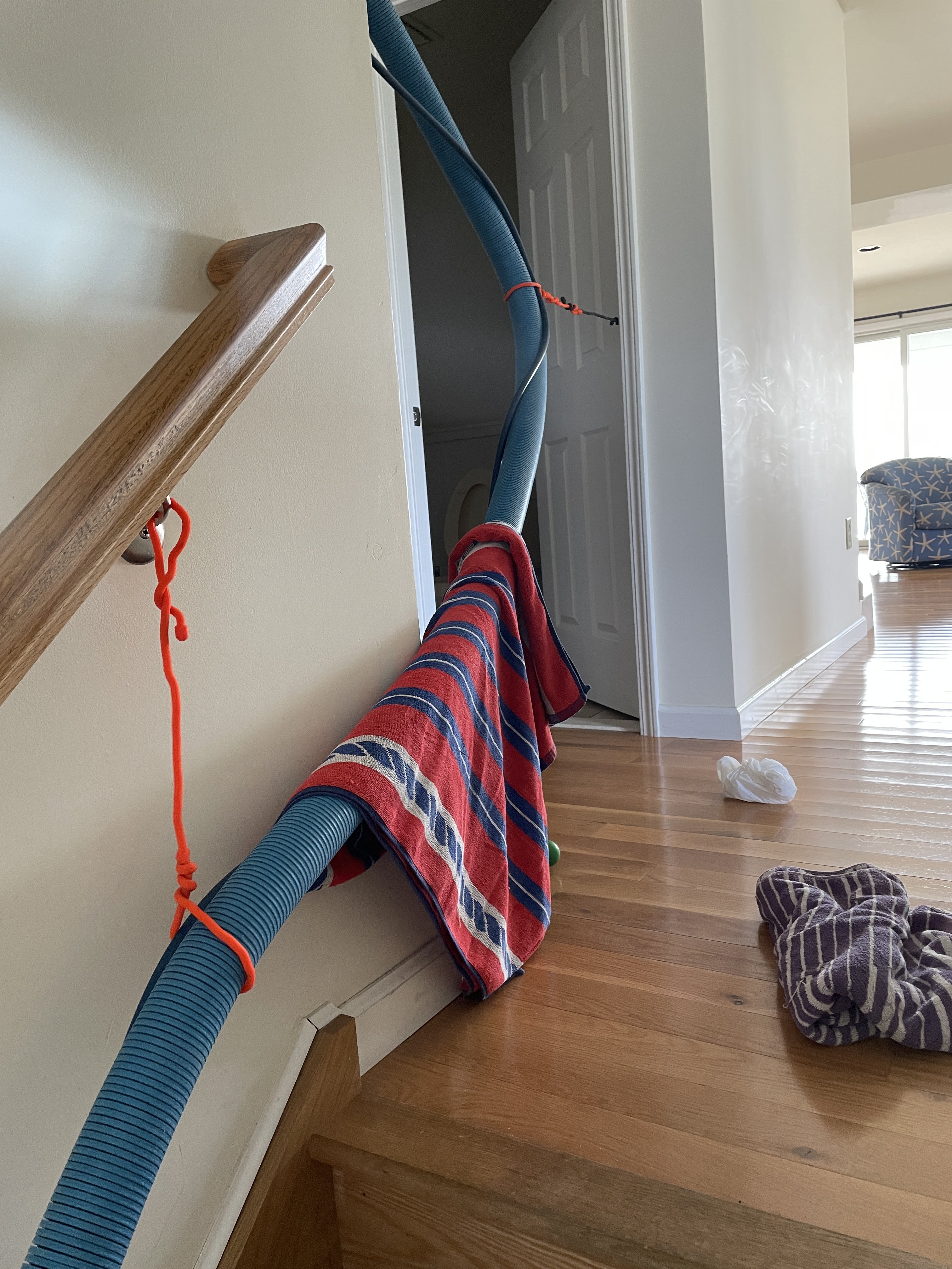

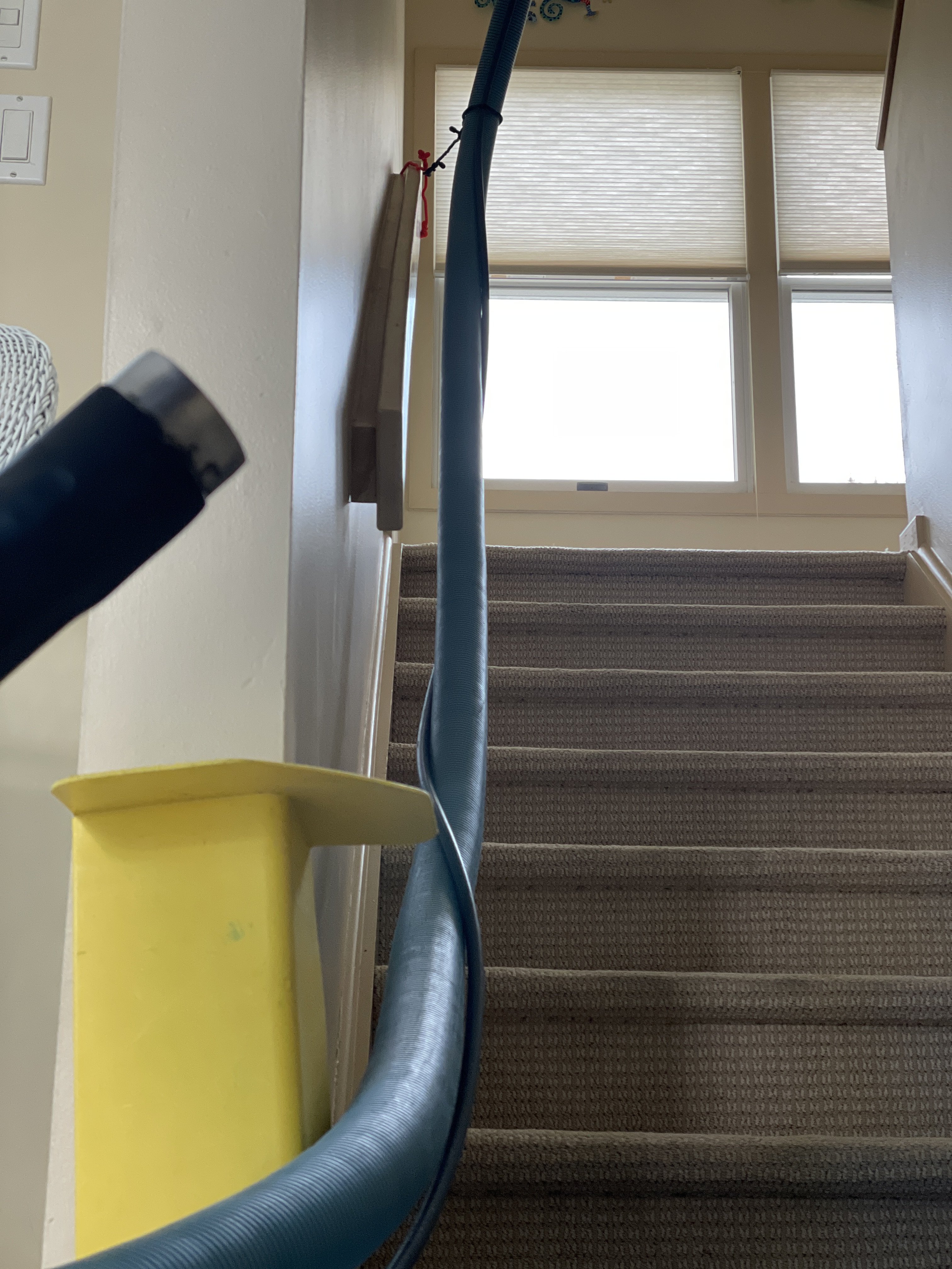

Those twist ties are working so good. I use a hook over a rail, but all thru the house up the stairs I use more twist ties and less hooks now. A lot easier on walls too by securing them to spindles.

Little moves like this are all over, dont have to worry about guarding corners or protecting rails. I find pieces of furniture too. I almost launched a little table down the stairs today. Was using the leg to secure the hose and you kn0w what happens. Caught it in time.

Never seen hose going up a staircase like that before. You’re amazing.
It kinda does amaze me. After so many years of a hook and a towel guarding the vinyl, this is positive moment of truth working.

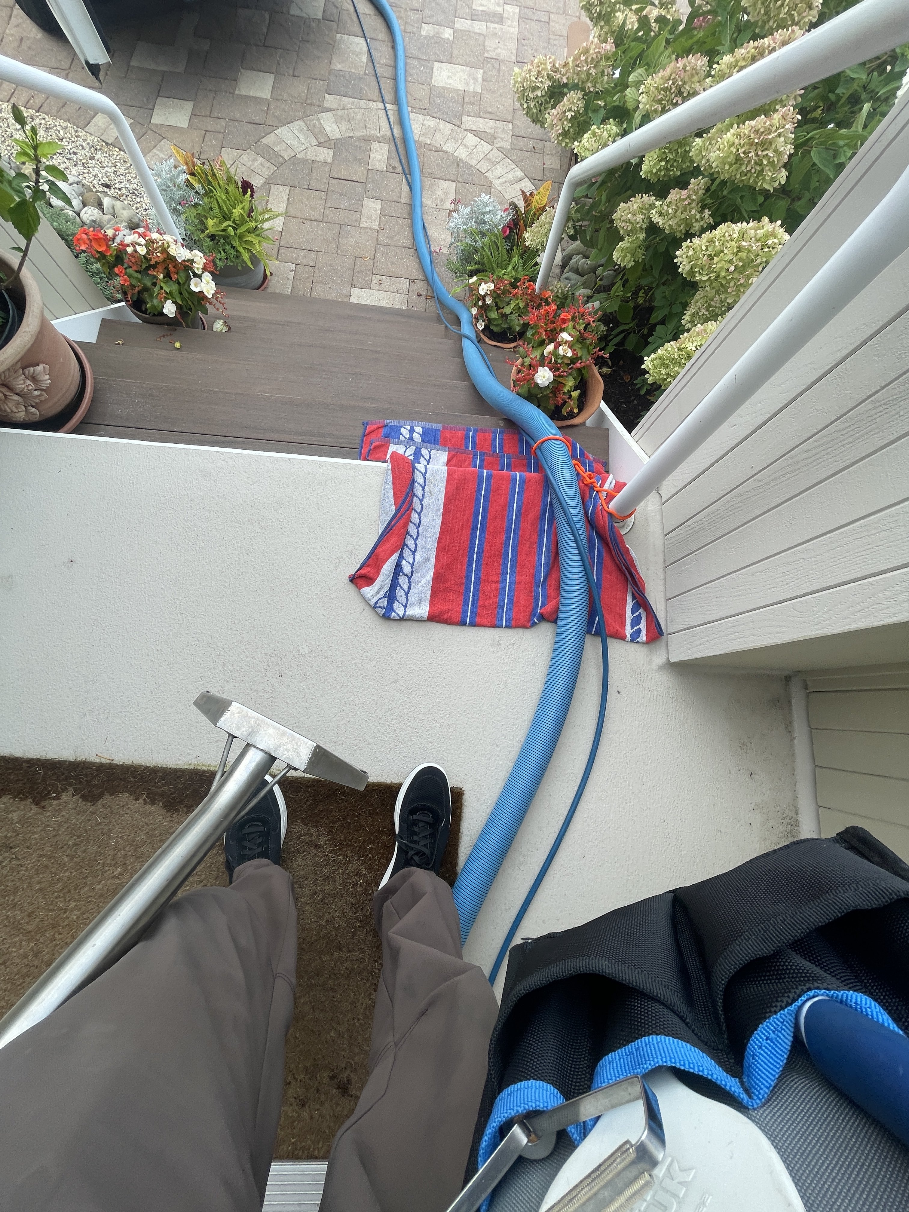

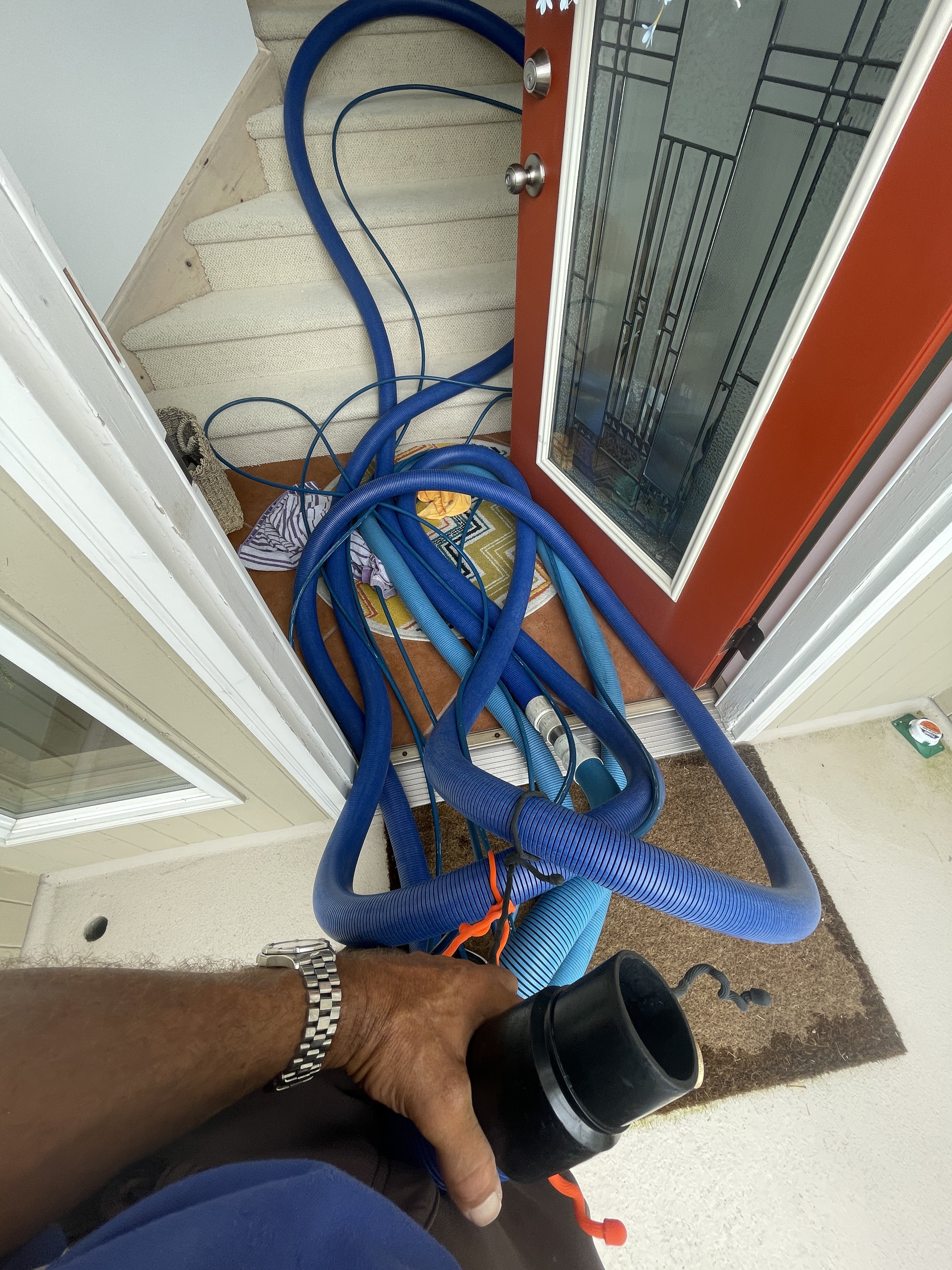

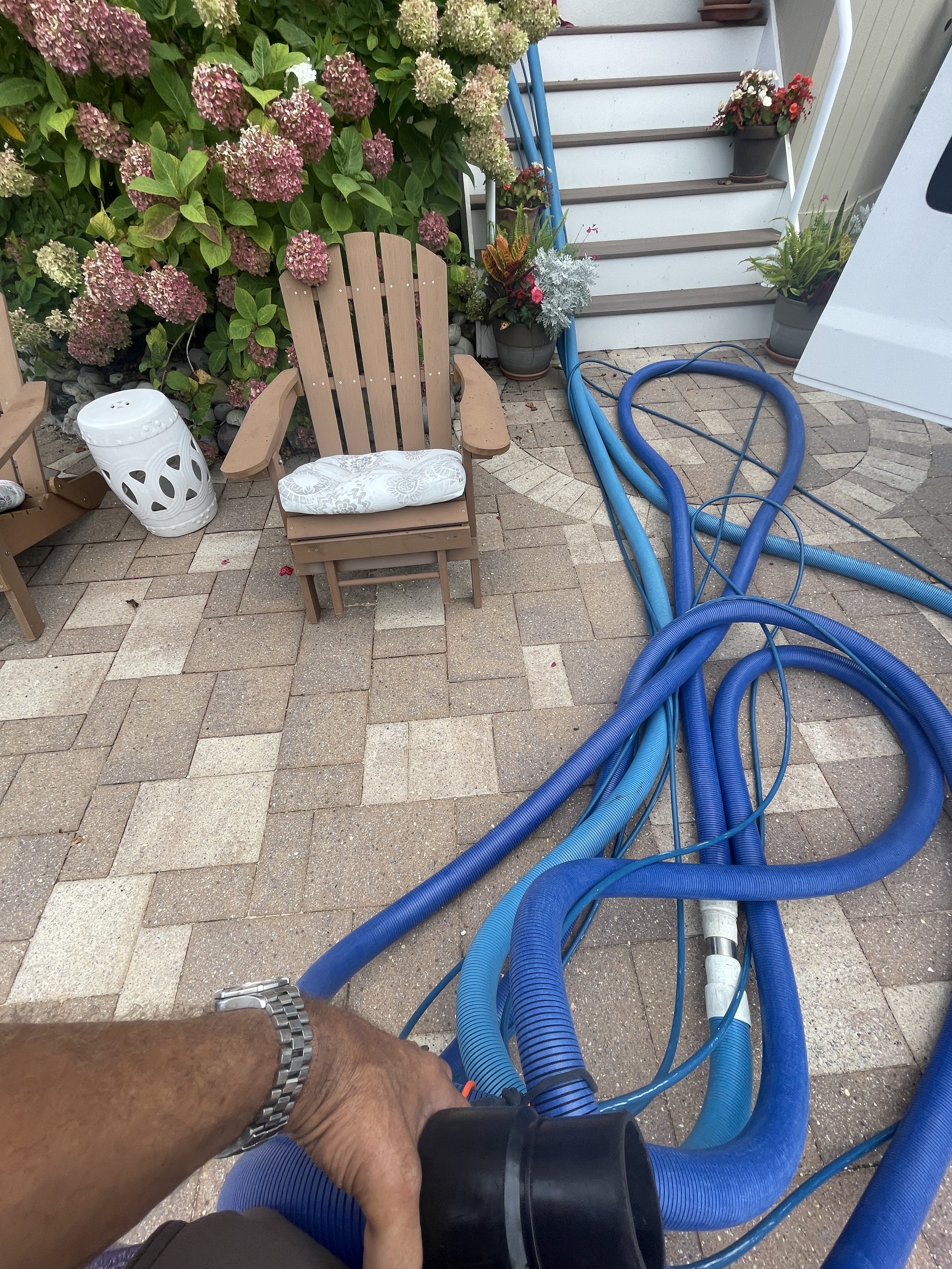

Liking these gear ties better and better. Great control, dont have to move plants as much, time saver.
Going Up
Going down, one shot using gear ties in place.
Only the one on the porch was left secure so the pile came in a little easier.
