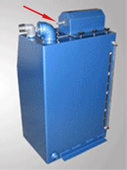

Lester,
The red arrow points to the vac relief valve on this White Magic waste tank. It is opposite the hose connection, as shown on your photo.
Matt Murdock's numbers refer to vac readings as successive amounts of restriction are added to the machine. The lesser restrictive the addition, the less the rise in vac level. Hence, the reason some users will opt to use larger than stock vacuum hose (i.e. 2.5" vac hose).
