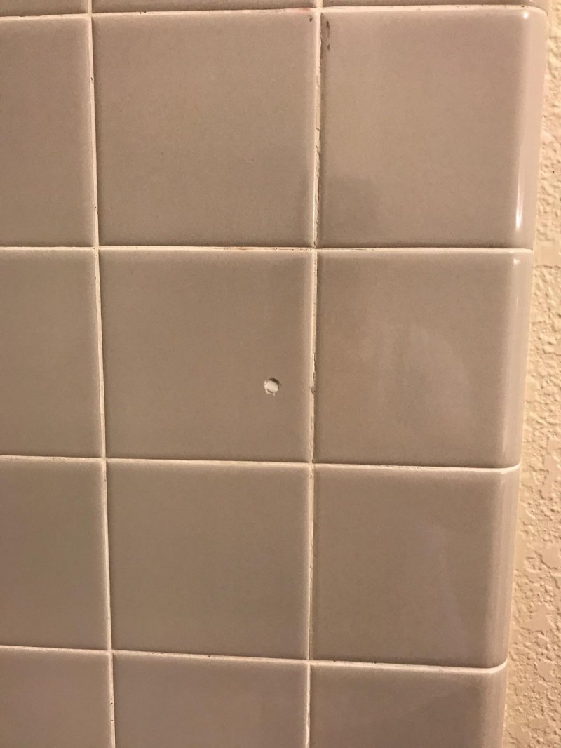

Jason my guys tried filling holes left over on a tub enclosure wall from the mollies.
They could not get your product level with the tile surface, it sort of dimple'd in..
Any tricks?

@Mikey P , here’s a tip. Pack those holes first with a thick mix of grout/water as a backer, then mix Super Grout Additive® as thick as possible for the final layer. Have your guys apply more epoxy on this one.
Same idea with any repair area that have large gaps.

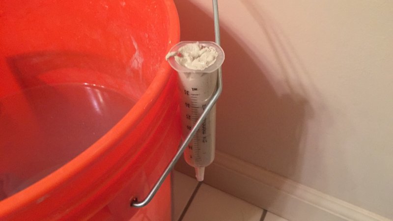

1 more question for ya. Say you walk into a new job and your going to skim coat the shower pan or an area and want to match it to the current grout on the walls or theres a color in general you need to match elseware in the bathroom.. what would be your technique for matching the color perfectly? any tricks you can share?
@Acp , get yourself a grout color chart and find the closest color. @Caulkmaster will mix different colors for custom matching. I always save any remaining epoxy as a sample and label them for future reference. Tip: let the remaining epoxy dry in the syringe overnight then remove it for a perfect cylinder core sample like in the pic.
You can also use the bucket to hold the syringe when filling. It frees up your hands.

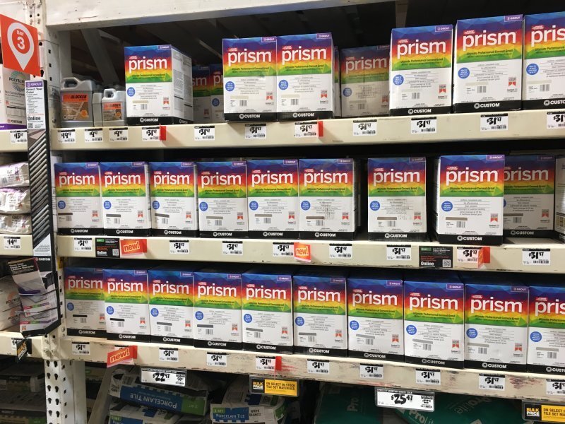

You must mis read my post Jason....it’s a hydrolic based cement.. what we used to use in my former life for under water repairs on concrete pipes.
Think of it as grout on steroids.
And yes-FACT- our local HD stores only sell this as your only option for cementitious based grout. I’m sure you still go to website and get it....
Simple economics... and long overdue.....why carry 2 of every color...
The Mapei. Version of the same (FX) however will scratch polished TML

Well......truth be told...... looks like you might want to follow up with trends in your field.

Interesting, all the Home Depots in my area haven't changed over. I still see Polyblend in the left side of the pic you provided. both sanded and unsanded. I can understand why they are doing it to simplify the grout selection process. Maybe I'll have my chemist do some testing with this stuff out of curiosity. Thanks for sharing!

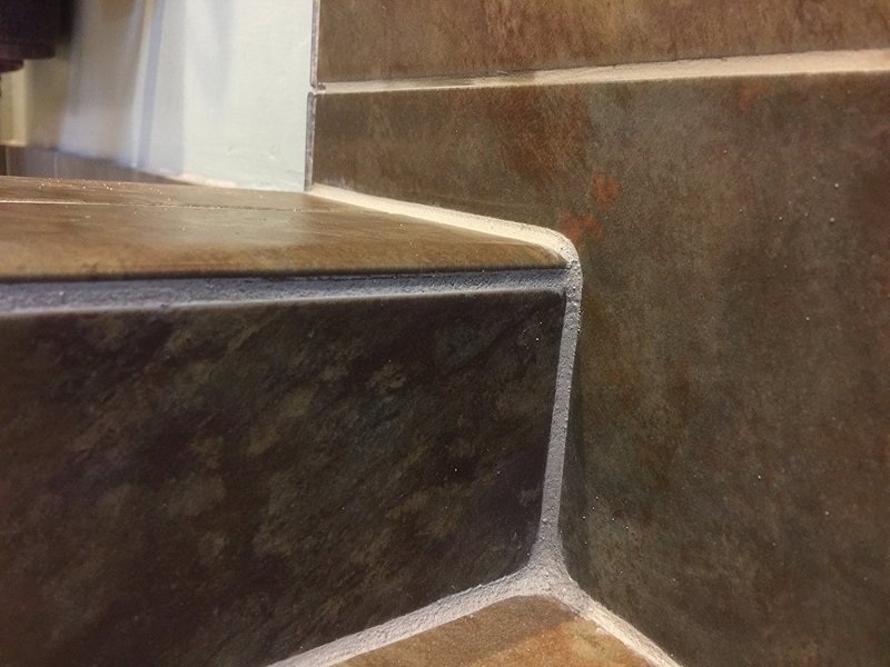

mix any color grout for color matching.

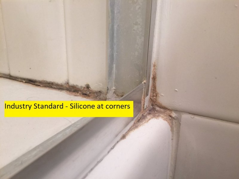

Industry standards are outdated and have been for several years. It's a fact and the pro's that run tile/grout restoration businesses no longer have to use low quality products that typically result in call backs.
Here's what the TCNA recommends for change of plane, right out of the handbook. Industry standard but certainly not Industry wide!

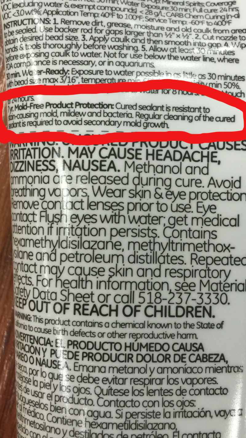

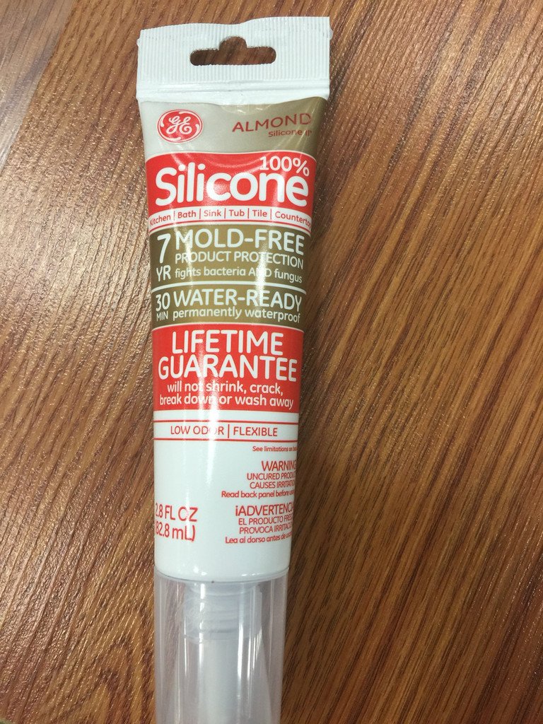

Read the fine print on 100% silicone. So misleading it should be against the law. How do these big companies getaway with it? Homeowners, DIY'ers, and pro's know what happens with this stuff in wet areas. Should be no surprise.
