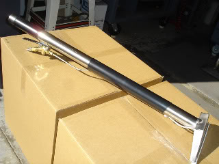

I use a straight tool, exactly like the one you are pushing, but without the 14 inch head, glide, or 2 inch tube. It's a pain in the lower back, and completely useless on any step lower than 3 or 4 feet.
I want one with a 2 inch tube (probably with no more working length than the straight one you're making now), s-bend tube, 14 inch wide glided head.
And I want it tomorrow.

A 2" inch stair tool with a 14" glided cleaning head? S-bend or not is sure sounds good...
Yes, we make glides for that, it's a WestPak 10" stair tool.
It's not that hard to add a bend to a 2" tube, I'm just not gonna buy it back if the guy discovers it's lame...lol
When you flip a double bend tool to do the riser, the hoses are pointed away from u in an awkward manner, on a straight pipe it's all balanced and universal.
I really don't think crouching to do the last two steps or even last step is that big of a deal, the trade off of cleaning 12 steps standing, and cleaning them fast and thoroughly, and with ease is worht the effort.
Good splainin' on the elbow knee thing, that is exactly what i do, use leverage.

Who carez about the S-bend! I want a 14" Greenhorn stair tool the way you designed it. Does come with a 2" pipe right?
49,922
I care about the S-bend.
However, Beany brings up some good points in defense of the straight tool. That extra bit of bend on the hoses when you flip the wand over can be a pain, but the bending on the bottom steps (for me) is also a pain. So, I have to decide which is the bigger pain.
I don't clean the risers all that often, and I always clean the bottom steps, so Greenies point has little bearing with me; however, just today, I experenced something that had me thinking I could seriously use the wand the way Greenie designed it. (Straight) I was cleaning a ton of church pews (like all freakin day) with my upholstery tool. I though how nice it would be to be able to use a wide, glided tool on them. It would be faster and the glide would actually make it better, in terms of the extraction effiency. However, thnk about another scenario we all encounter frequently. Cleaning that odd bathroom with carpet, and getting the area around the toilet. The straight tool would be inconvenient, when compared to the s-bend, and the 14 inch head would prevent you from getting between the toilet and the wall,or tub.
So, I guess it just depends on personal preference, and if I thought about it long enough, I might convince myself that the straight tool is the best.
But I would never publically admit it ...
well of course. :wink:
That carpeted bathroom scenario was almost a daily encounter here in Sun City retirementville, if you wouldn't use you Titanium wand on a bath, why would you even think of a 14" wide utility tool?
Uph. tools have their place.
The 10" wide GGUT40 would be sweet for pews, and cut some of your uph. time in half, not to mention be great on stairs, not everyone needs a 14" wide tool for sure, but everyone can use a 10" wide tool with a 2" tube.

I'm sure I could manage without the S-bend but I'm afraid 40" is about 11" too long. I like a stubby stair tool. Doesn't everyone?
maker
Nov 5, 2006
209
If you haven't tried the 40" straight design, do your self a favor and try it. As I said in previous post, You can stand straight up when cleaning the tops and the risers. As porky pointed out you can't stand up on the last couple but you still get to stand while doing all the risers. When I switched to this style tool I did stairs twice as fast and never had a sore back.
