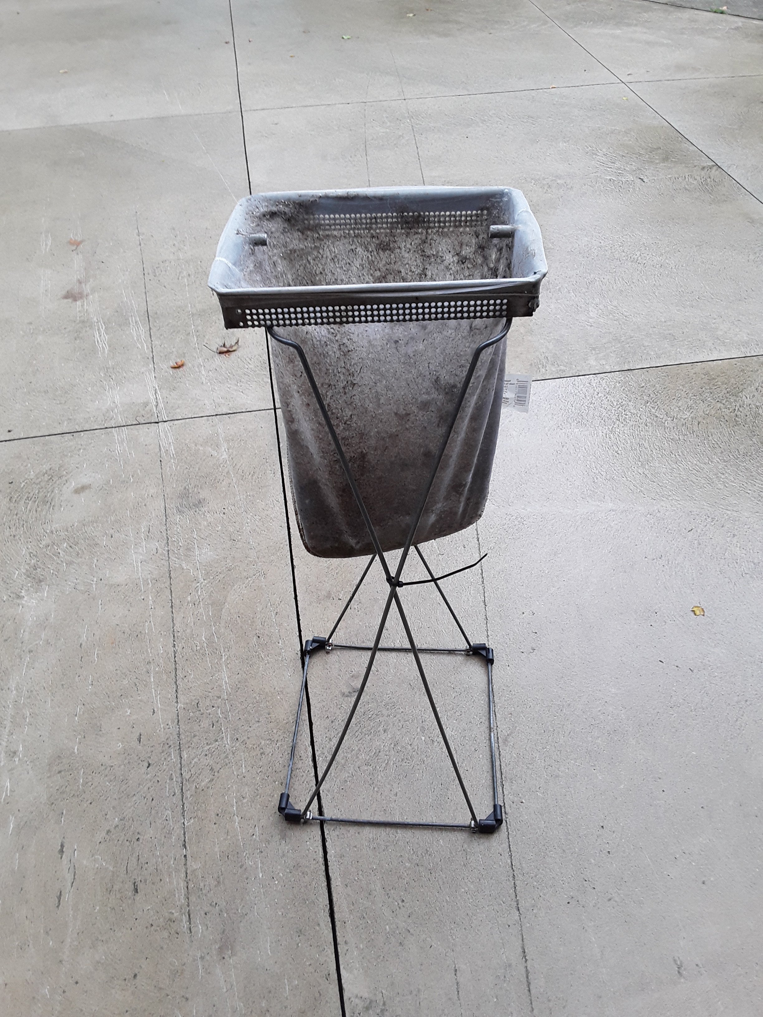

Rob Grady
Here is my modified aluminium in-tank basket. I sawed the bottom of the basket off, leaving only the retaining top to hold the paint filter. This is the easiest/best way to quickly remove and replace or wash down the filters.
No longer do I have to muck out the basket and attempt to remove the debris that used to get sucked into the baskets perforated holes.
This mod has also provided a noticeable increase in airflow due to more surface area of the filter hanging free inside the vac tank. I still run the 3" ss blower filter in the tank with a nylon knee high over it.
The fine silt/sand still finds a way to accumulate on the vac tank floor though, and I regularly have to wash out the residue as it goes septic fairly quick.
My service area has a many sand beaches, from Tobermory to Point Clark on Lake Huron, in Ontario.
