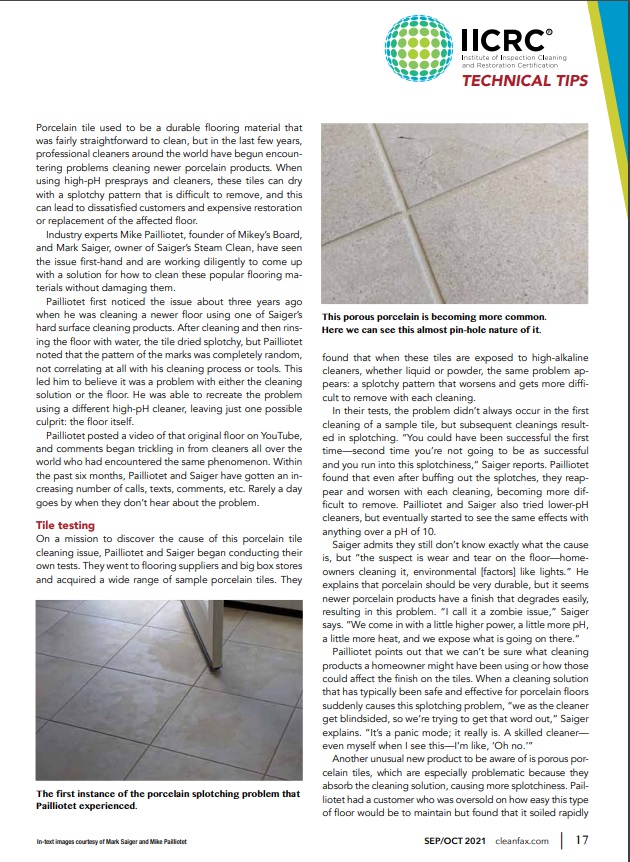

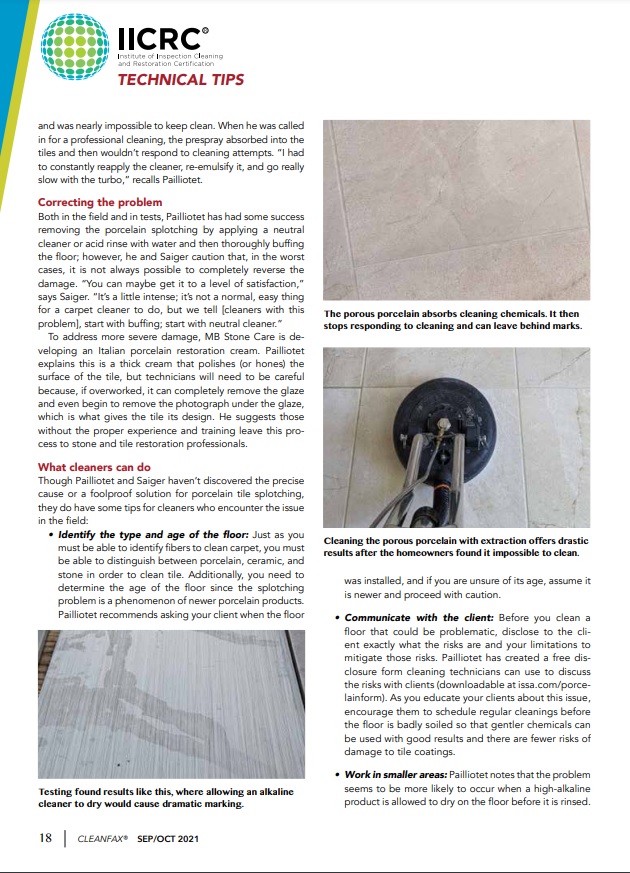

The Saiger/Pailliotet interview...
I have closely read the above article 2 times. On page 18, third paragraph, it mentions the porcelain restoration cream can remove the glaze and the photograph under the glaze. I am sure that would be possible, however, is not this issue found only in polished porcelain tile and not glazed or full bodied porcelain tile?
Also we know that around 75% of new carpet is polyester and around 25% is nylon. Do we know the percentages of full bodied porcelain, glazed porcelain and polished porcelain tile? We know it is recent so is it 1 out 0f 8 (?) new floors, and non existent before 2018. So with the longevity of porcelain tiles we may run into this phenomenon 1 out of 30 (?) floors with new homes built in the last three years being the most likely danger zones.
On page 18, fifth paragraph do you identify polished porcelain through its porosity or absorption of water? Will it abrade or scratch more readily? At this point age but are there any other identifications? IPA rubbed over tile may remove weak finish? Any way it is an intriguing topic at least to me as there appears to be a lot more to learn on the topic. Good start!!
116,967
yep, if worked too long wet to dry and with too aggressive a pad.
Most blemishes issues can be fixed BY HAND with just a white pad and the cream. A 175 would be used for efficiency
I doubt anyone outside of China would know that true number..
I would say 8 out of 10 wood or stone look porcelain planks are junk
yes, far more easily.
unfortunately there is no quick chemical test as it typically takes many exposures to our Sodium metasilicate and percarbonate to damage the glaze
I have not seen this 1st hand. I would guess IPA is removing the protective coatings that are applied to protect tiles during shipping
Reactions: Tom Forsythe
