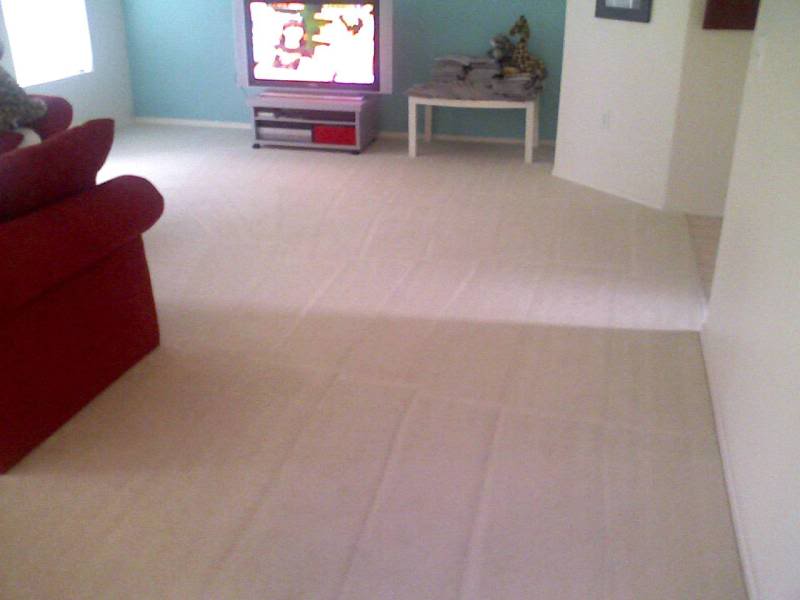

I just found that after spending so much time setting up furn to be moved , vacuuming , prespray and groom , steam cleaning , and replace furn/tidy up, unless I'm applying protector the grooming usually isn't justified.
I like the pattern of the holed glide as well.
