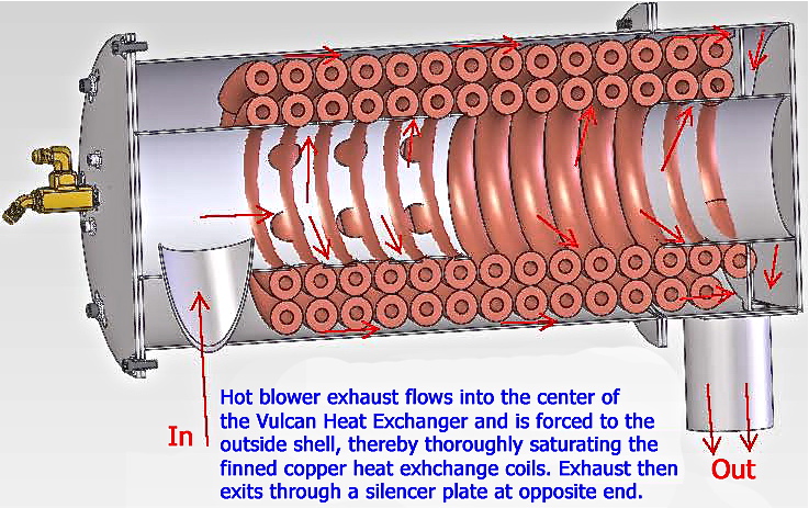

David, this is a diagram I found of the Sapphire Vulcan HX - is yours like this?
http://mikeysboard.com/sapphire-sci...-technology-in-a-time-proven-slide-in-design/
