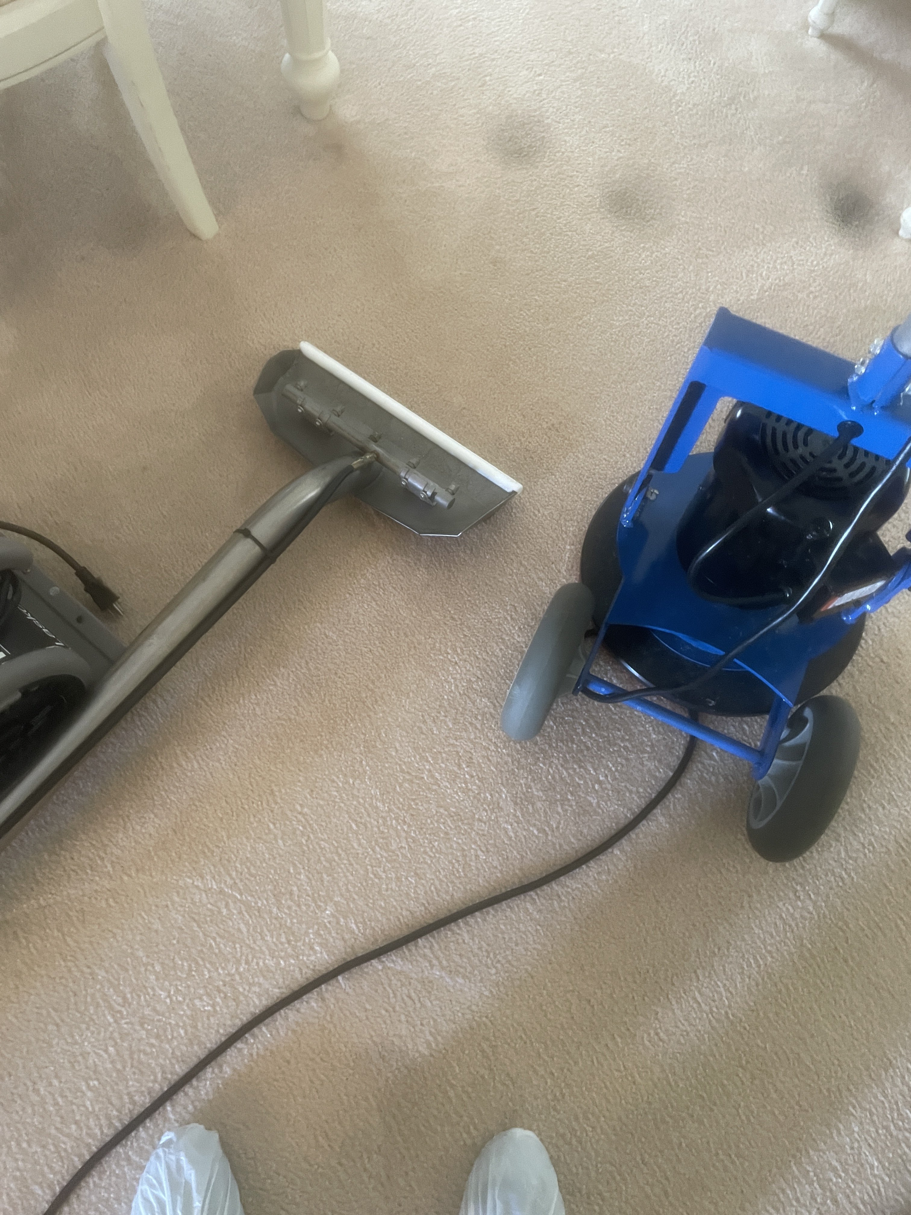

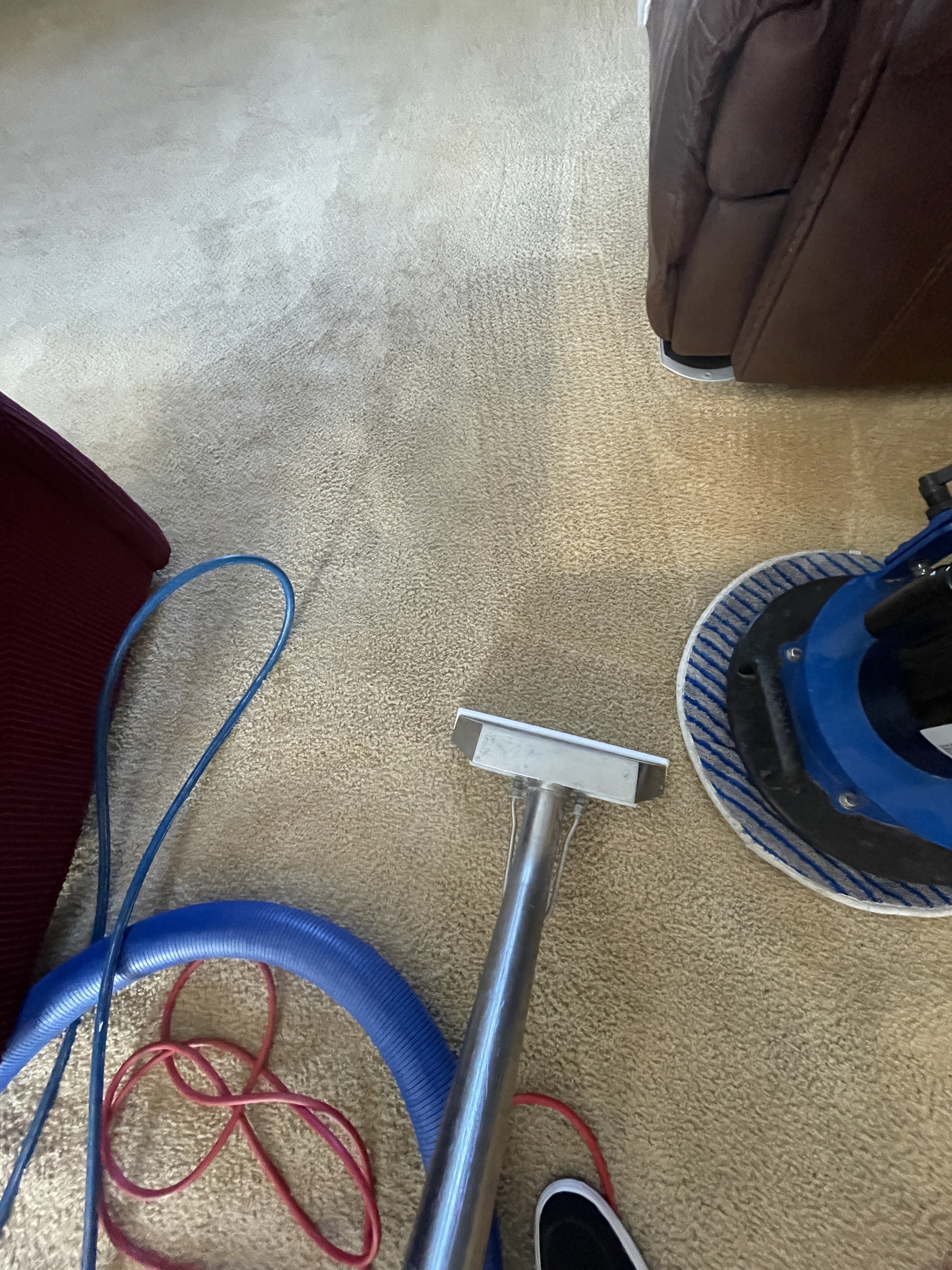

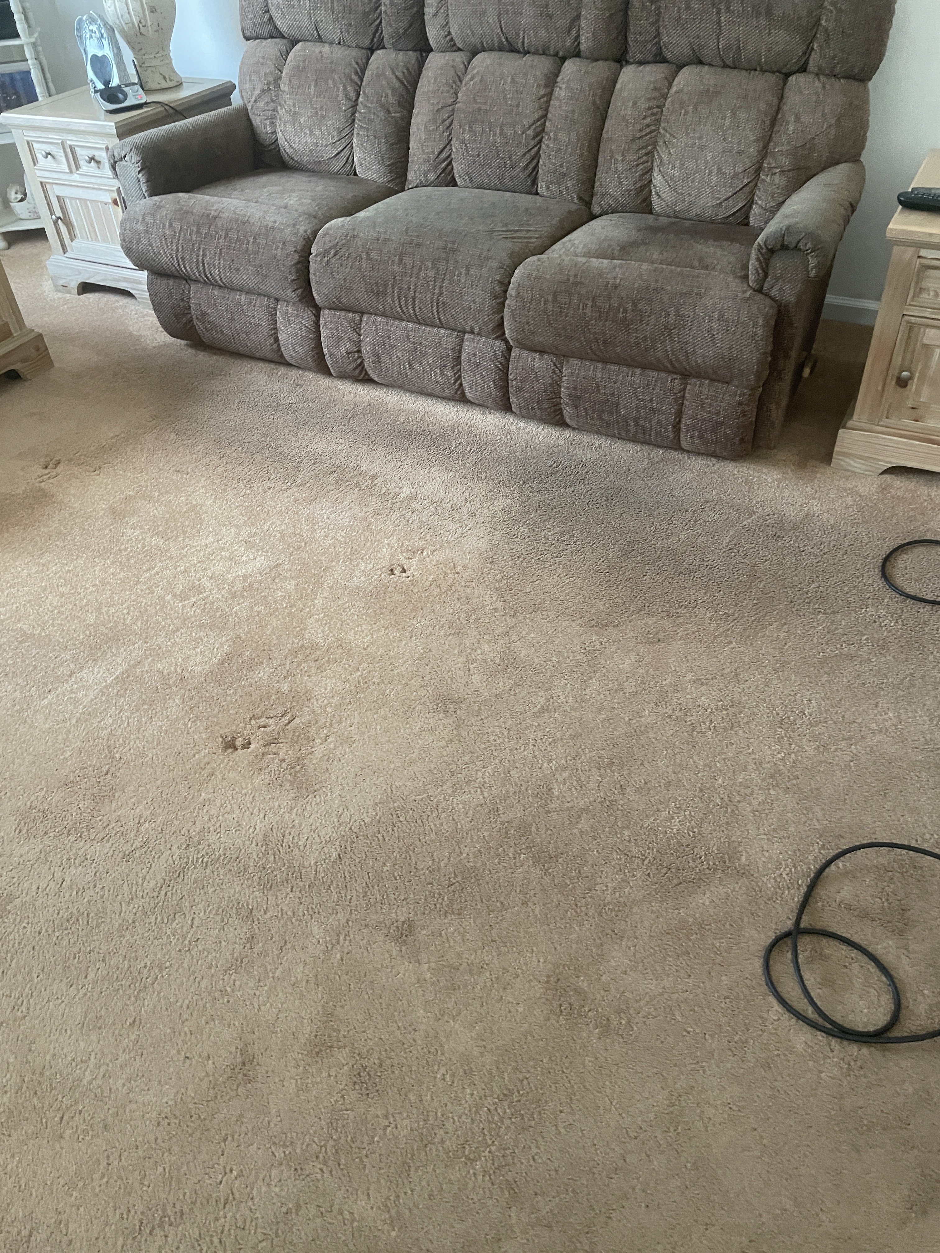

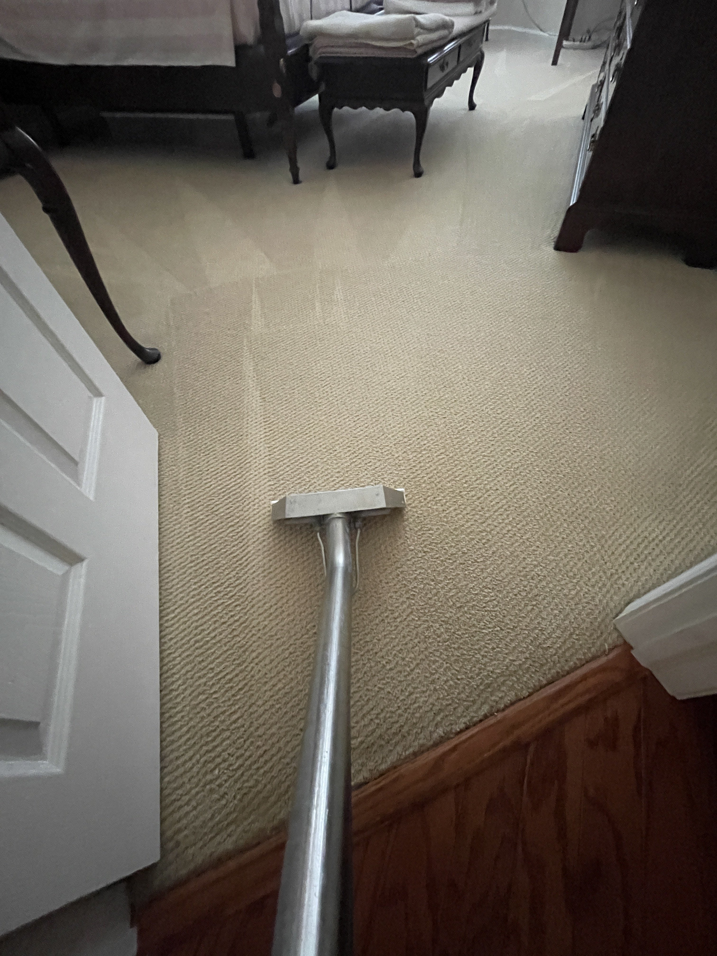

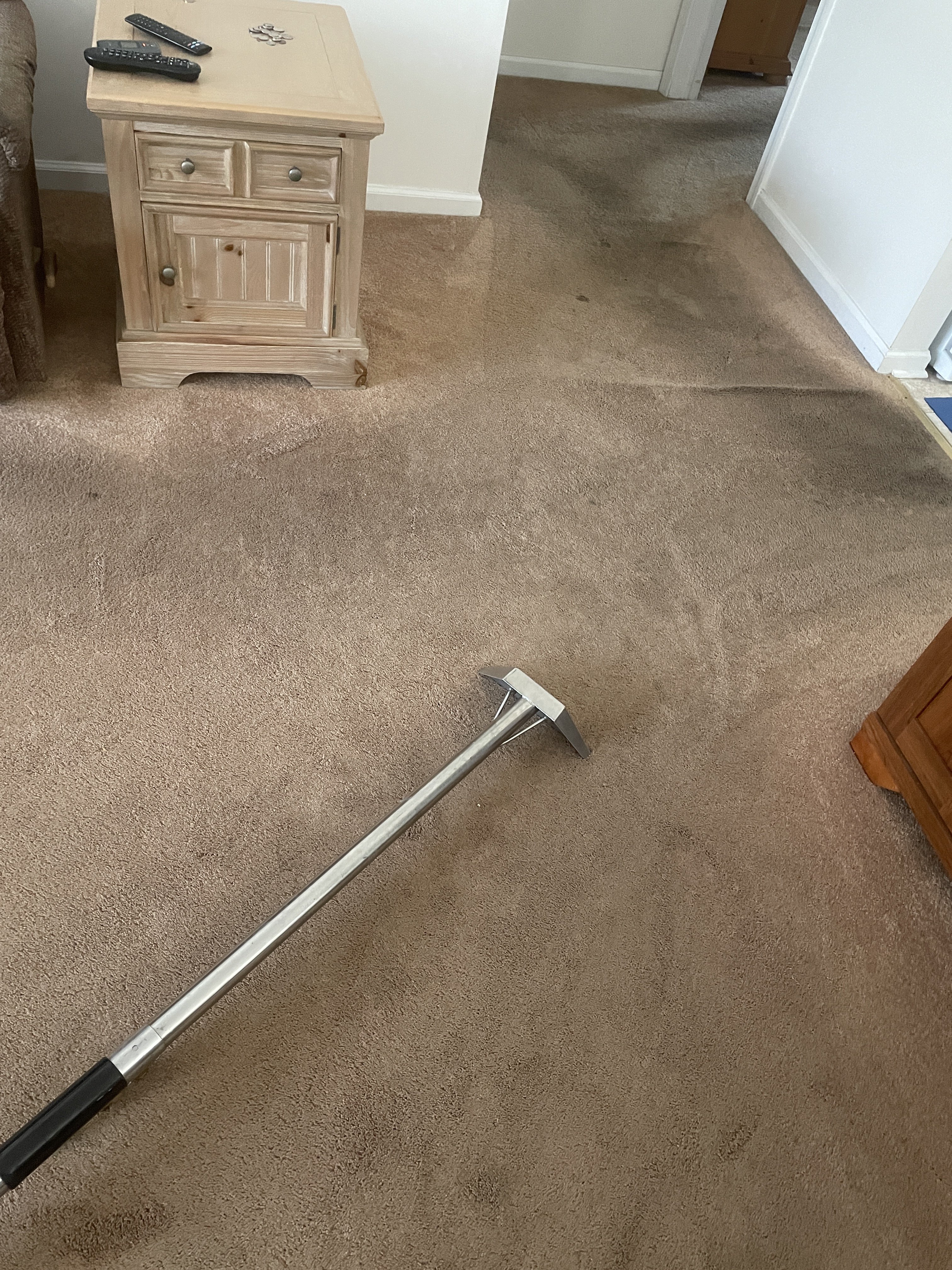

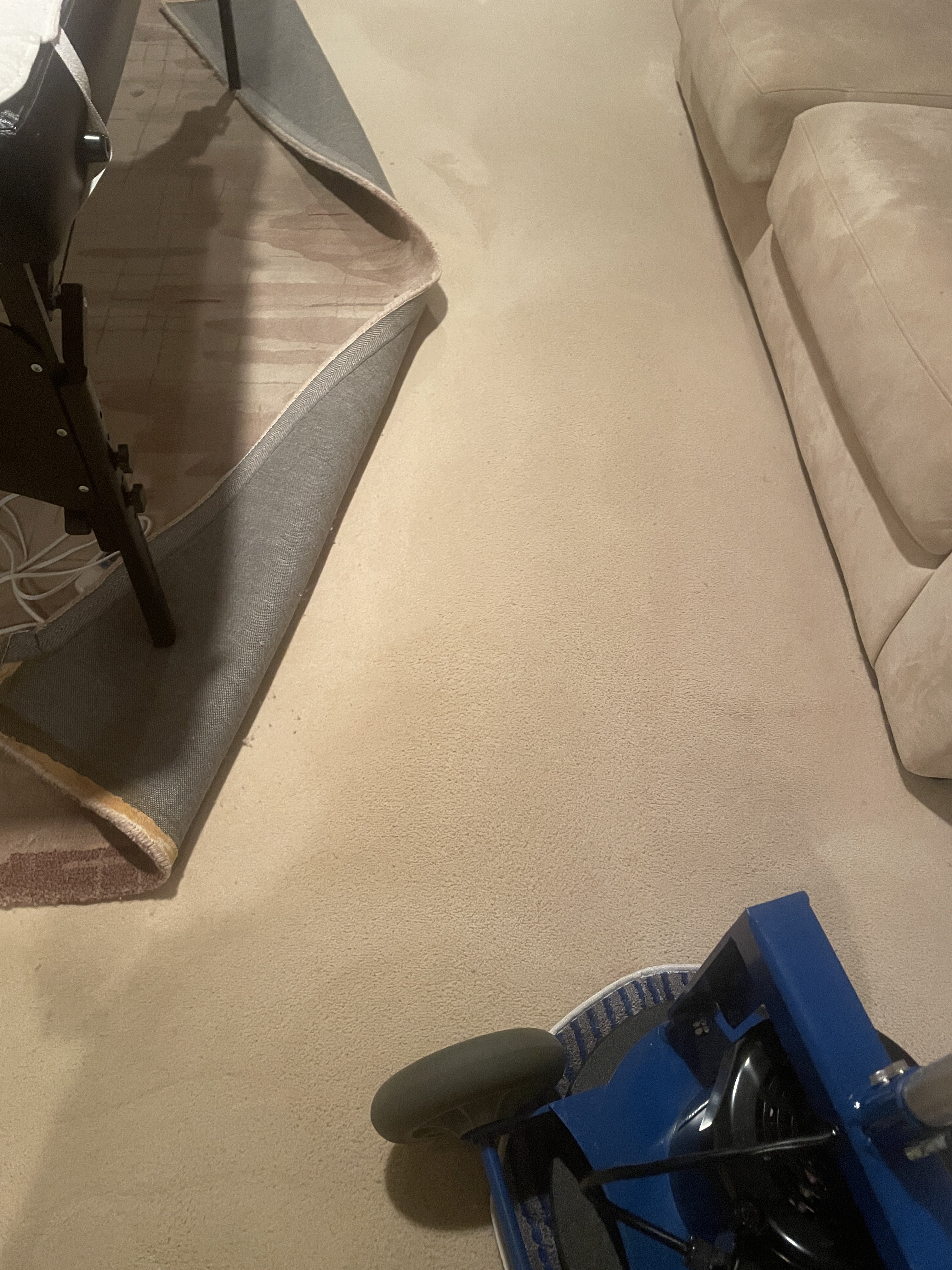

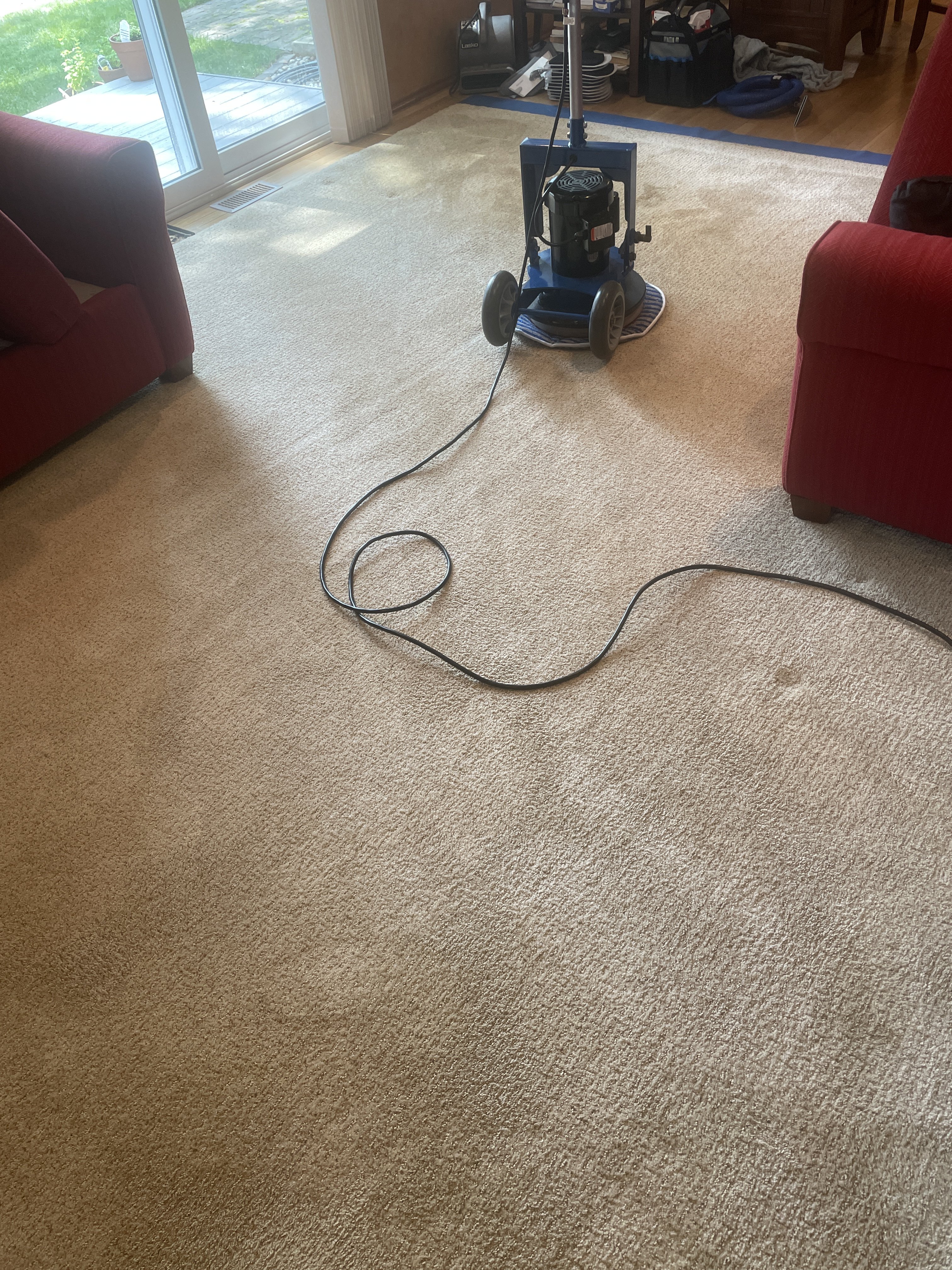

I tried again today with good results. Just used the Stepson because I want to see its potential, and I was HWE.
Before: By this point ther under couch and end table was cleaned. Vacuumed here, no spray yet.
Then agitated with the Stepson and Pad Cap Pro.
Then HWE
Finished

Nah, just went over it quick to agitate, whipping it around pretty easy but the Odyssey would have been the proper choice, just checking it out. I did these carpets 5 yrs ago and they look better than when I just HWE 5 yrs ago. Easier too, way easier. This padding is an eye opener for me.

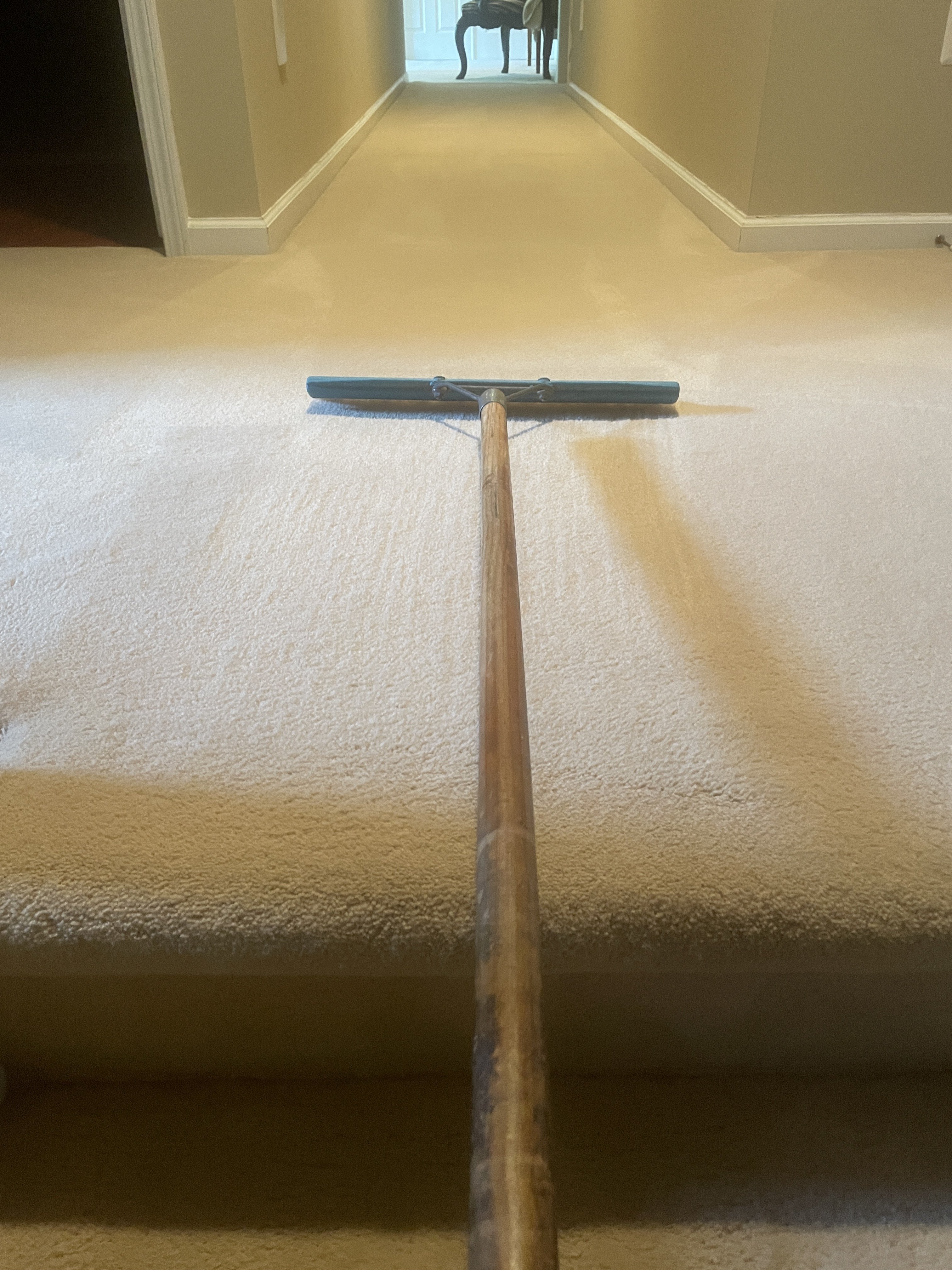

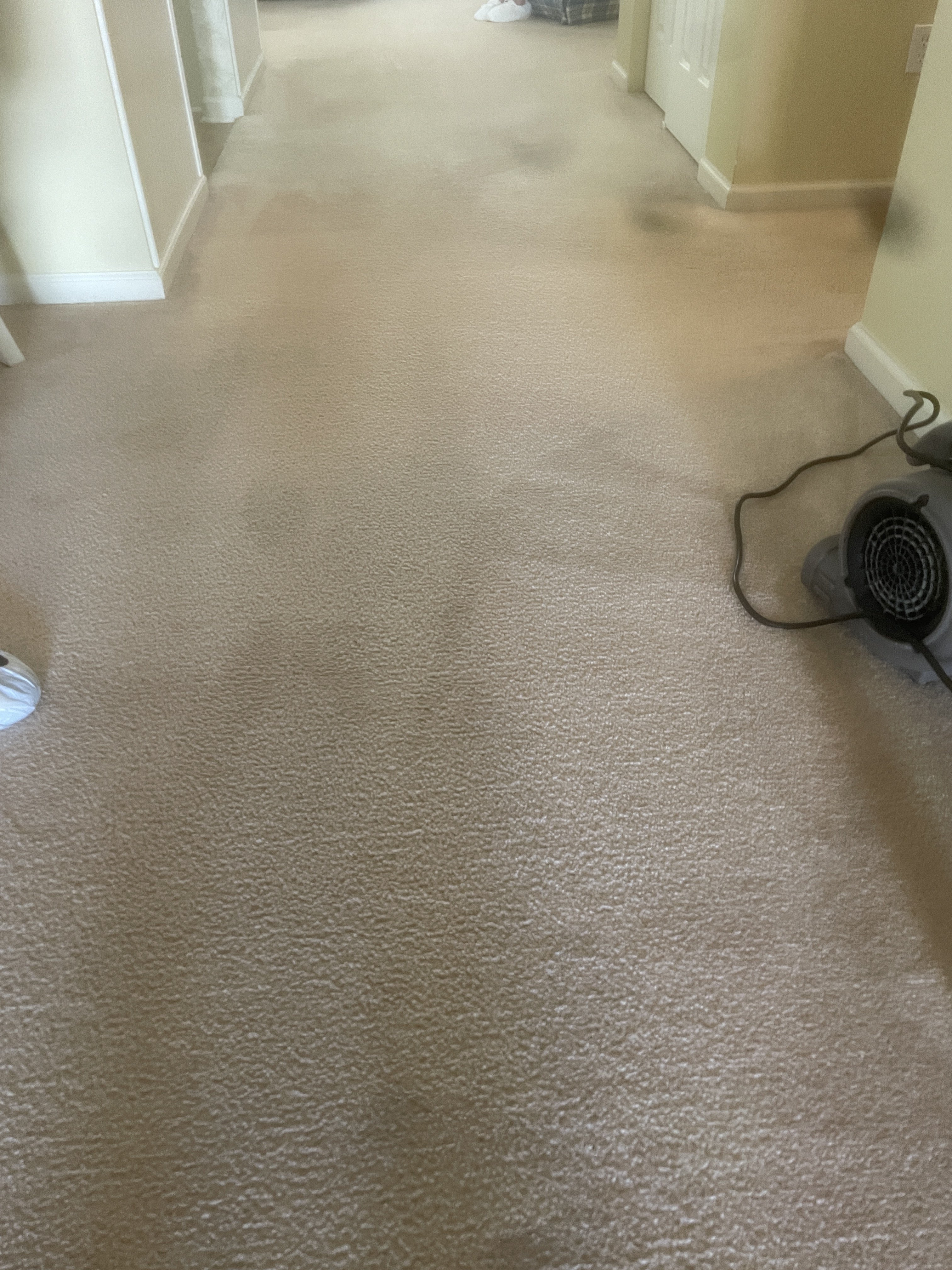

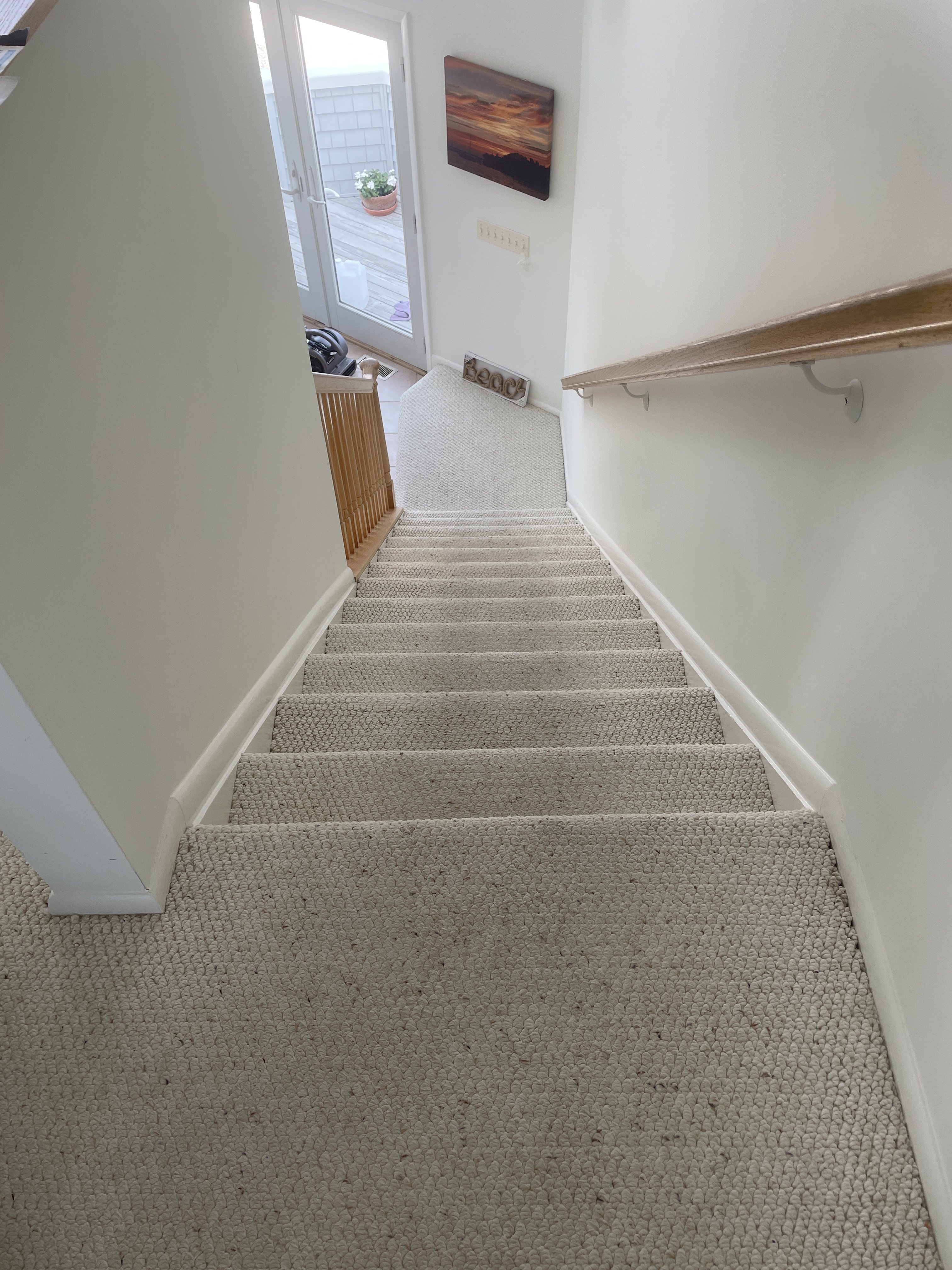

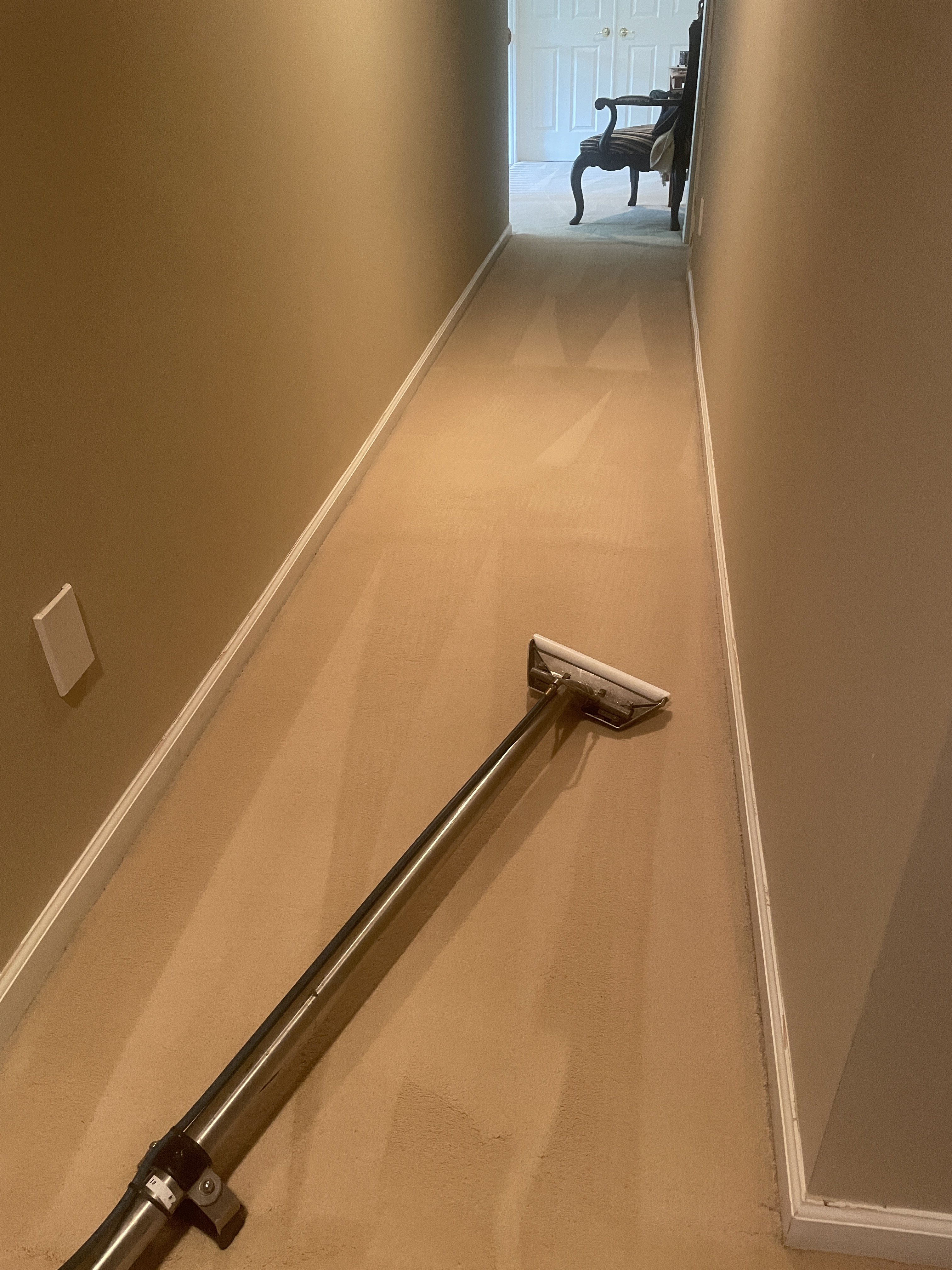

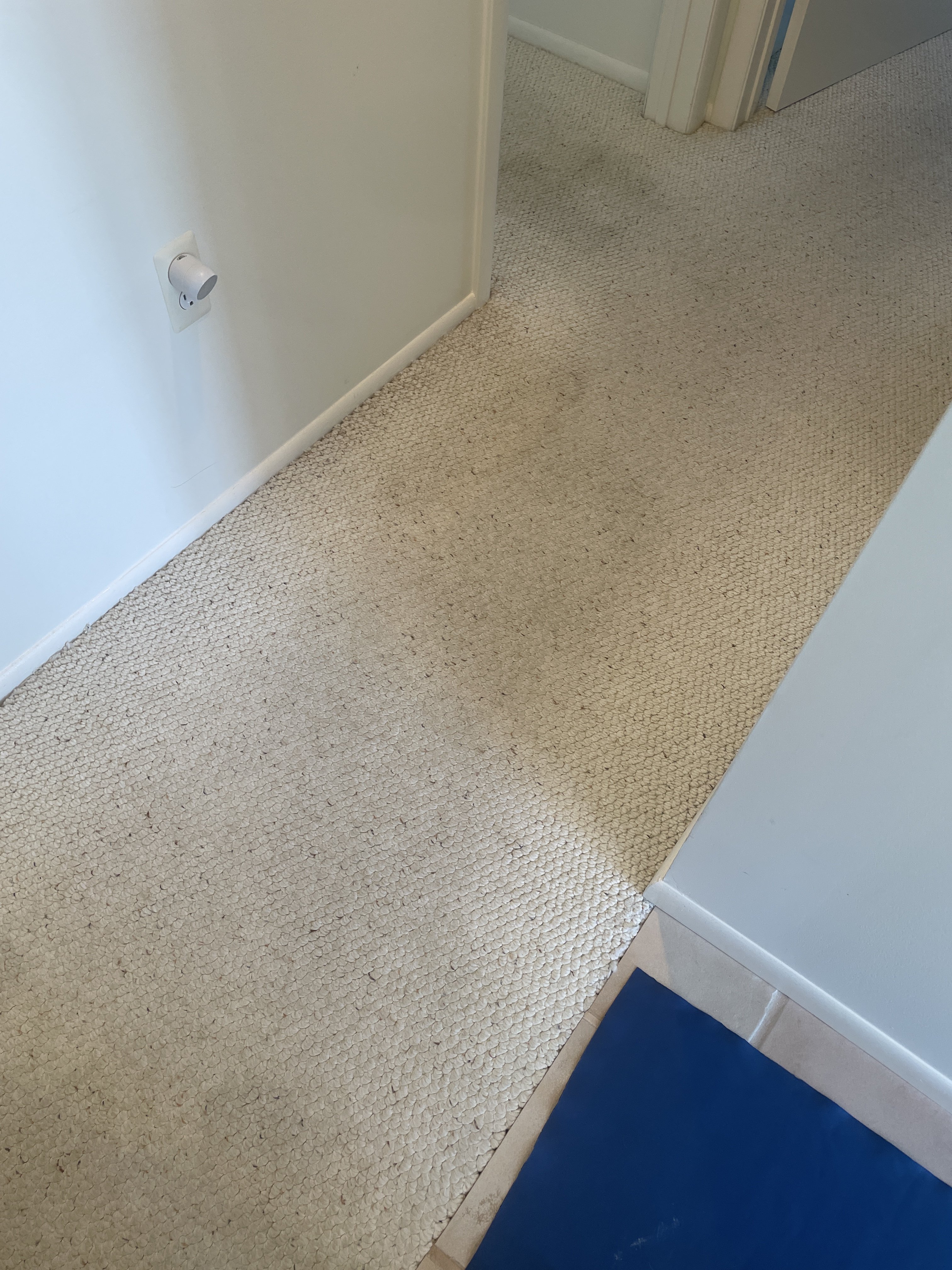

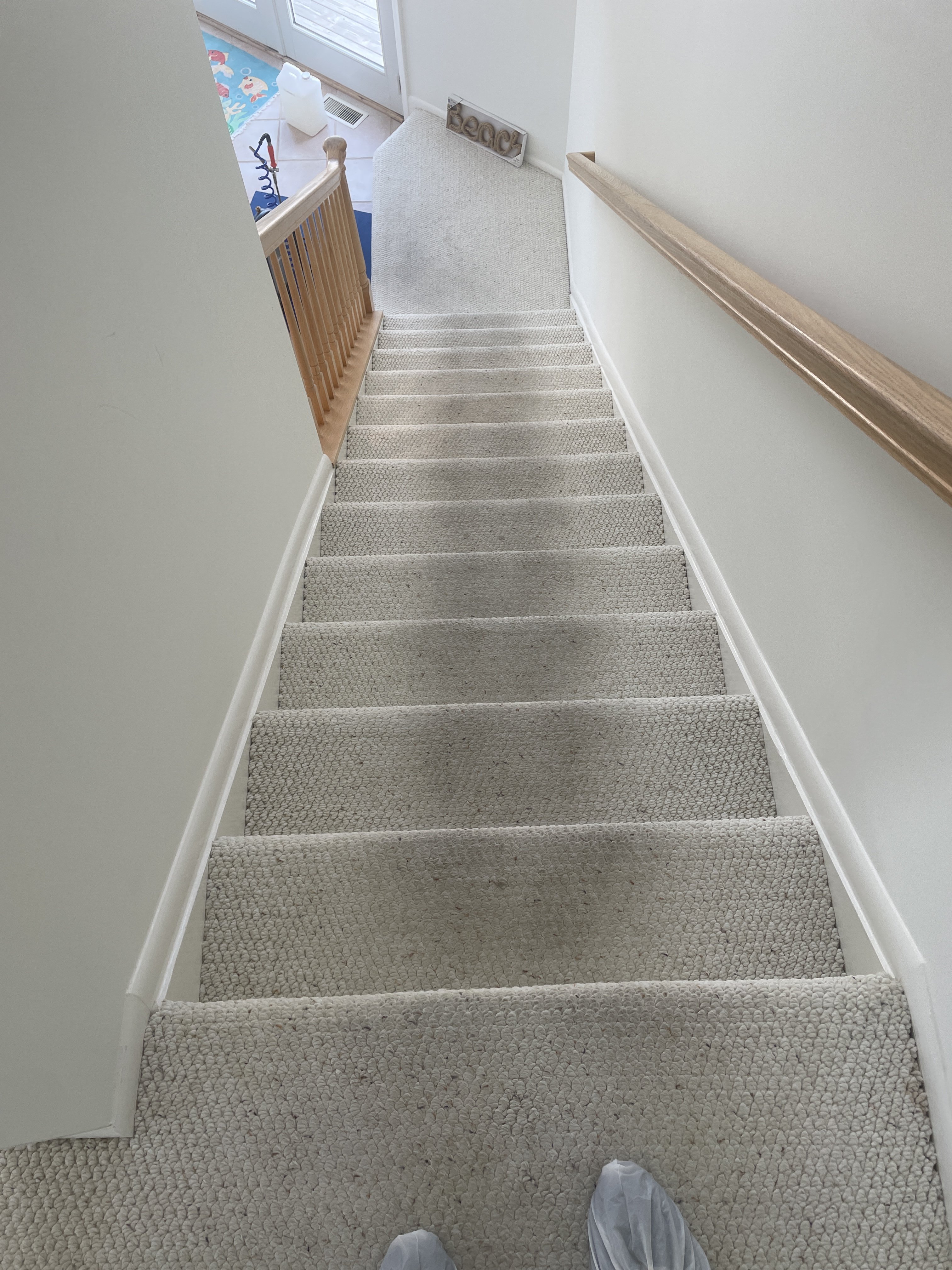

Another Hybrid day, Did stairs first in 10 minutes with the Stepson. Area rug, and a performance fabric chair.
Repeat customer is loving the dry stairs and has them cleaned regularly. More so from here on out. Loving this option.
Reactions: Jim Pemberton

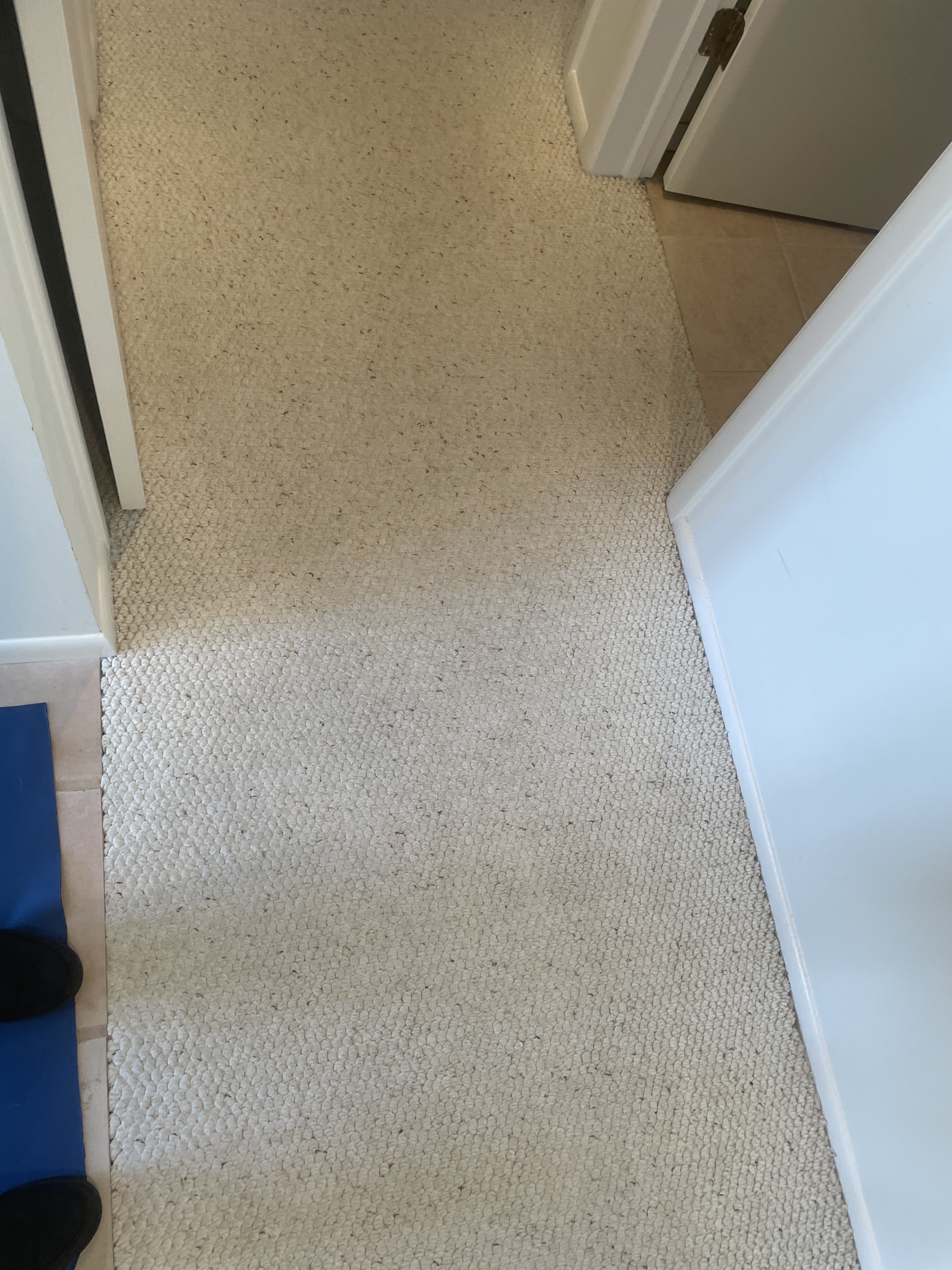

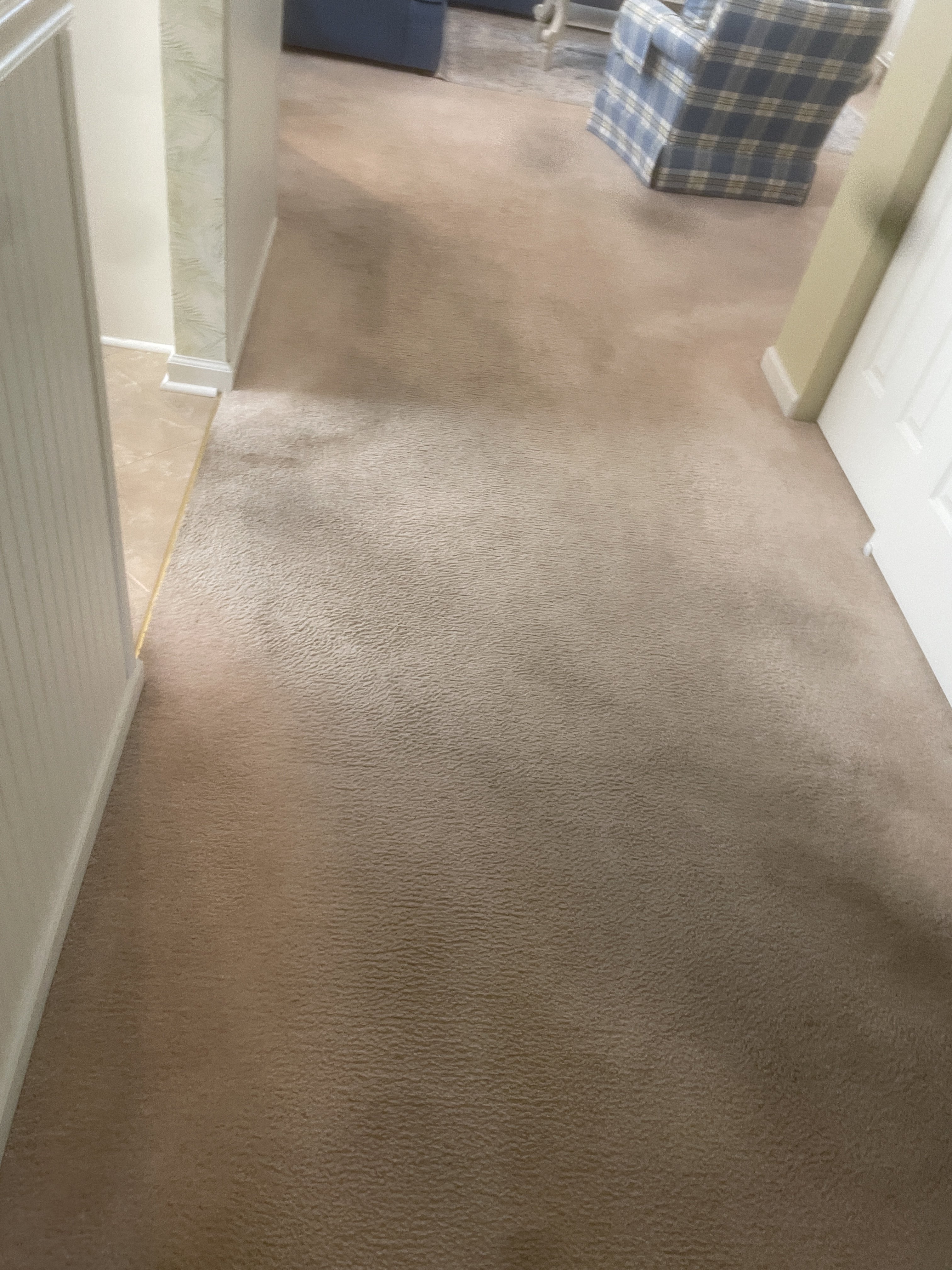

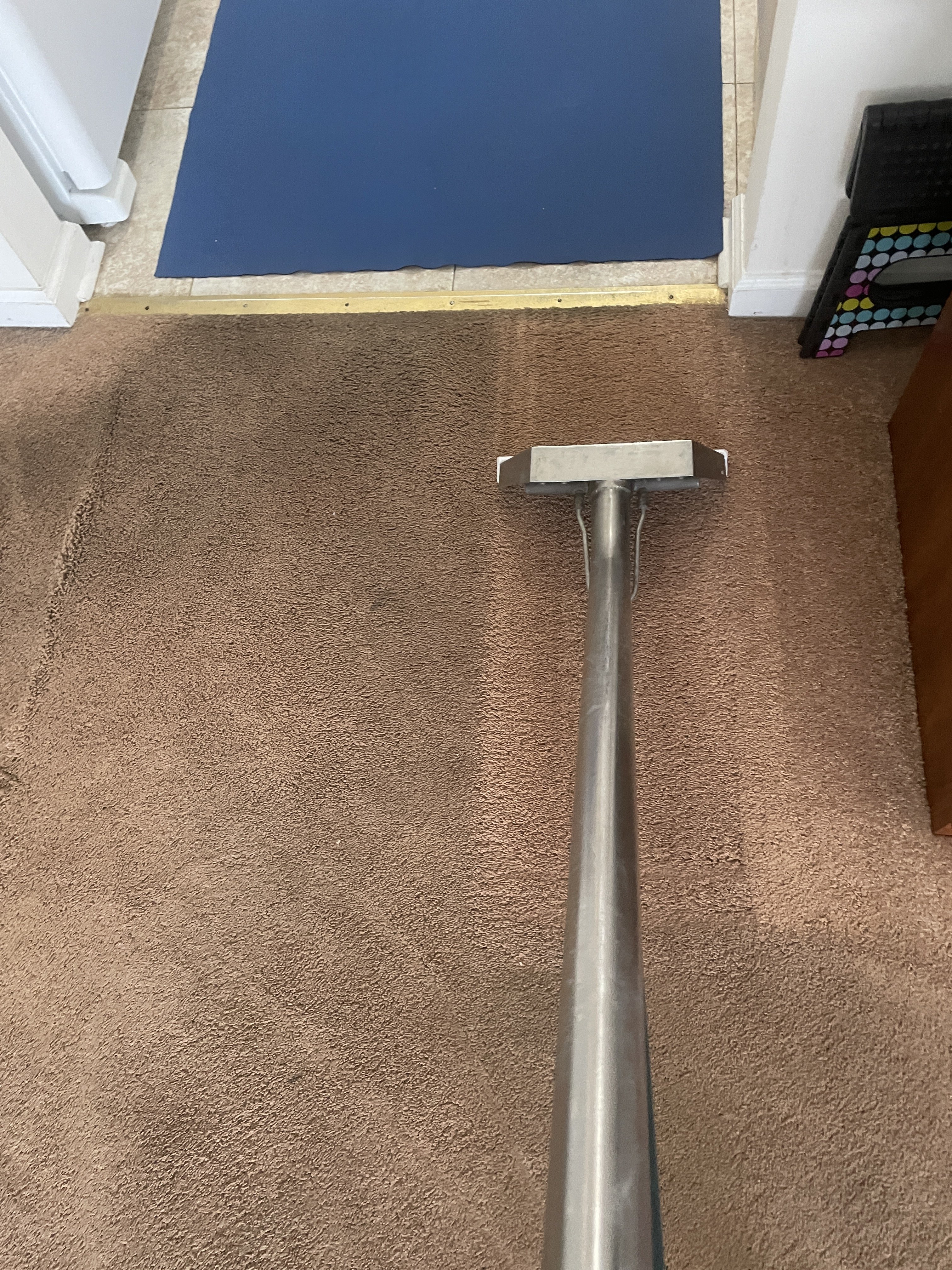

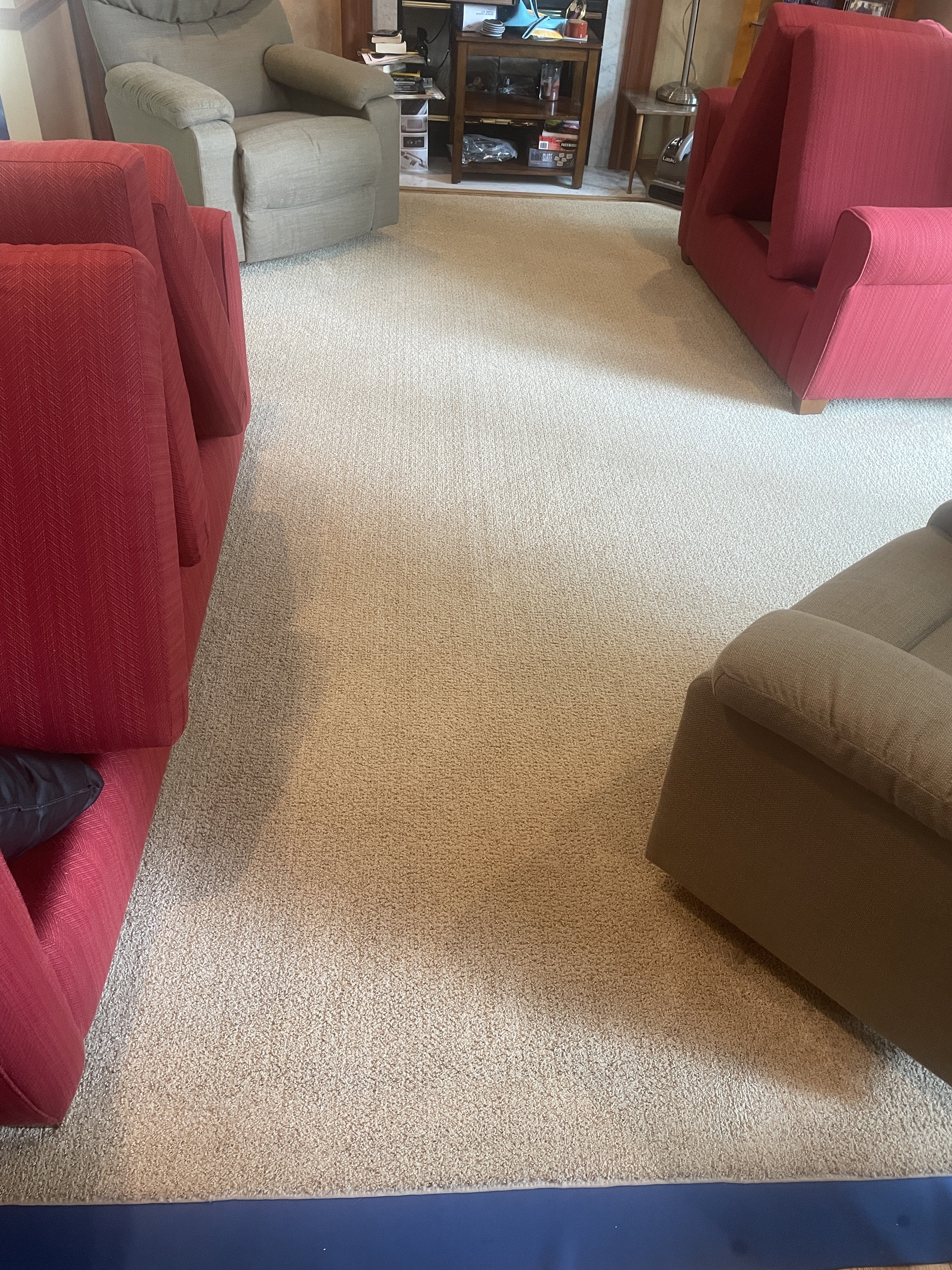

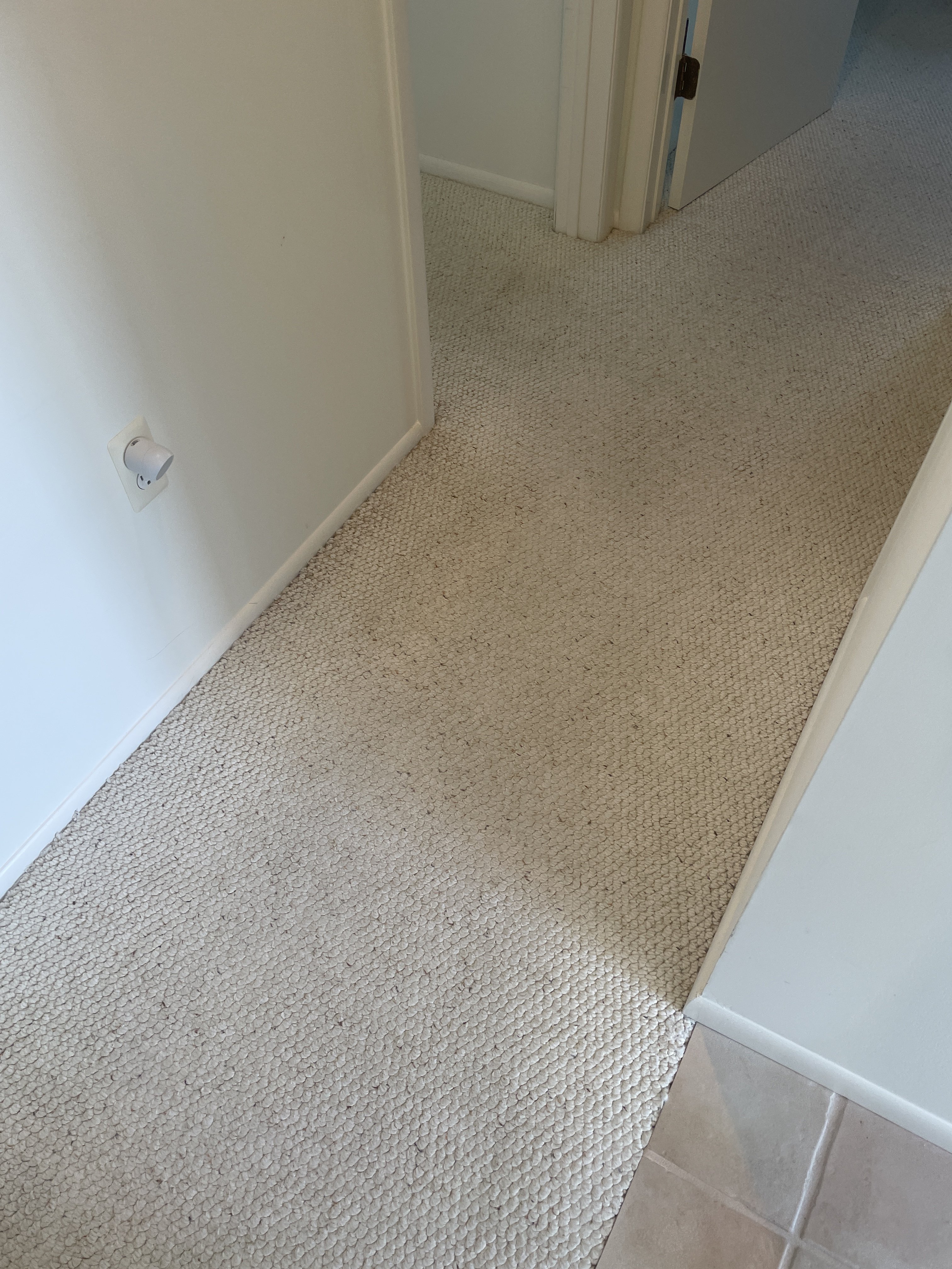

Perfect Saturday
No truckmount here and long time customer is thrilled. Coming back September for the whole sha bang.
These are very old over 20 years and they look worse in person before, better in person after. Home run.
Before
After
Before
After
Also was able to do a little area that was real bad, no before pic
The other little job was Padding the hall and HWE the Living room. Again scheduled for later in year when house is empty for W/W.

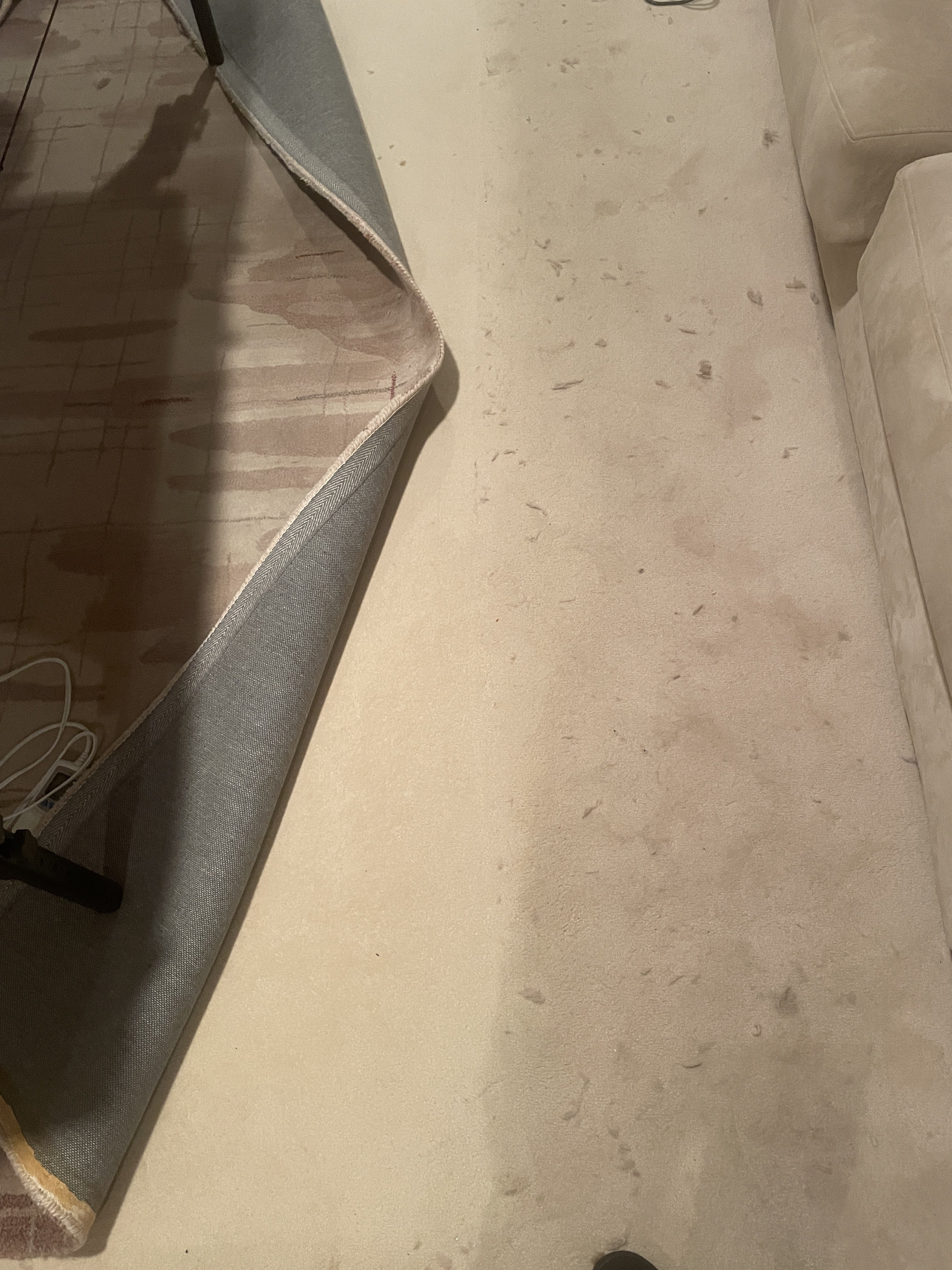

BEFORE
AFTER
This was a massage room (above). It was Oil. I was set up for HWE so this was the result of agitation only Pad. The first job I did before this one was Upholstery, Liv, Din, 4 bed and stairs carpet. Did VLM in the Liv and Din, and HWE 4 Bedrooms and stairs. Customer had medical issues and was chilling in the dry. OP cleaned living room with no fans blowing as I jammed upstairs.

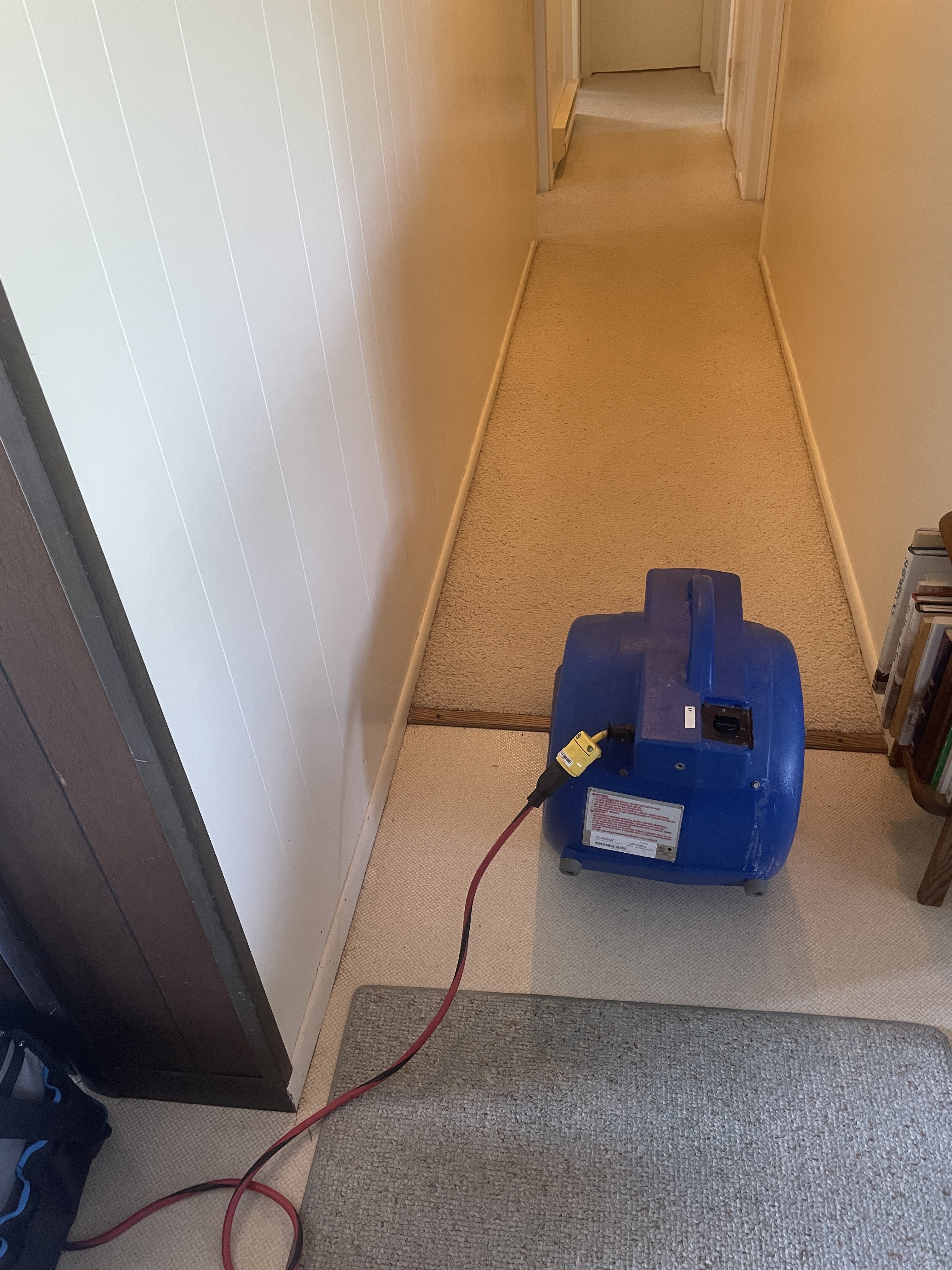

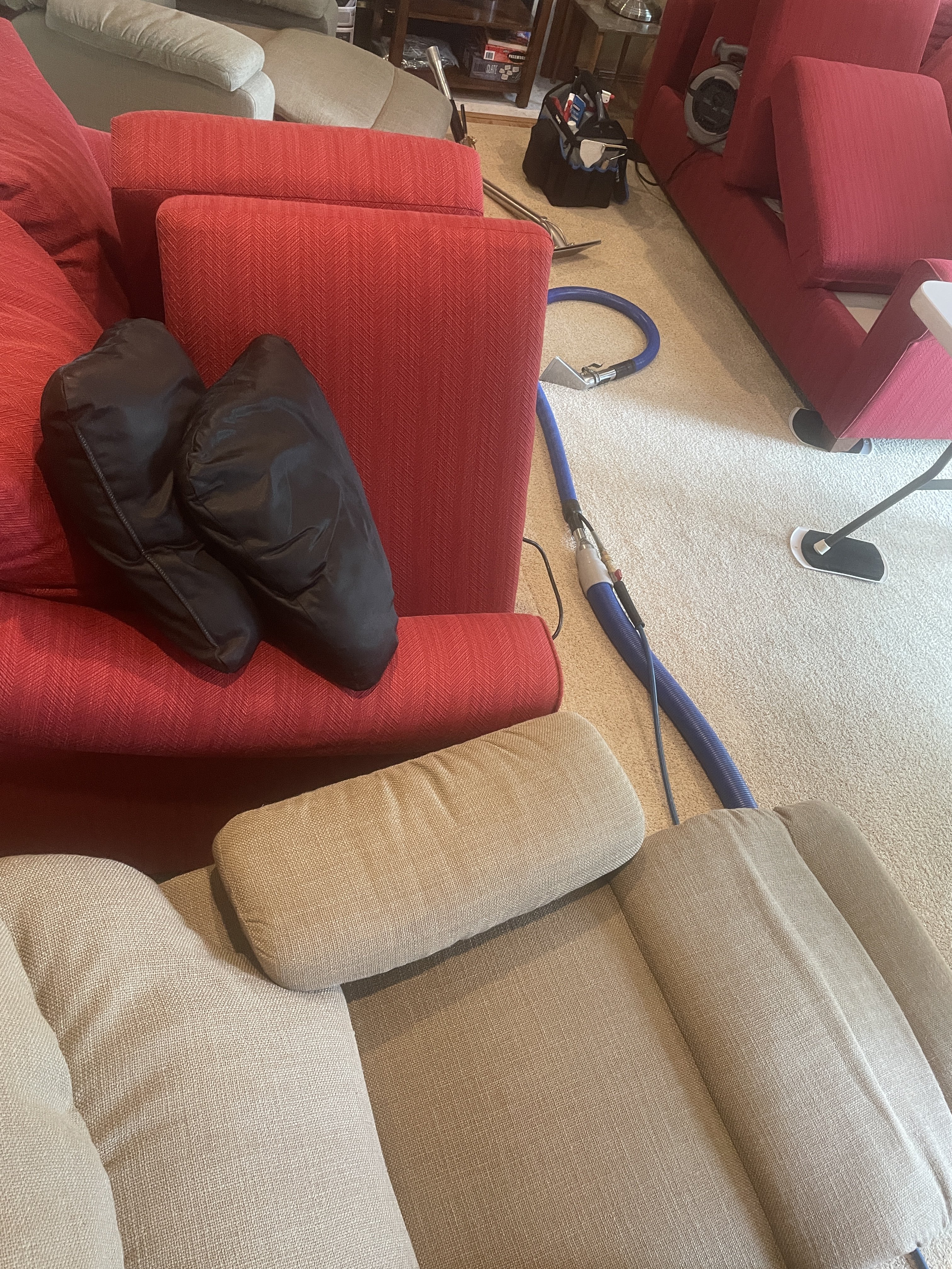

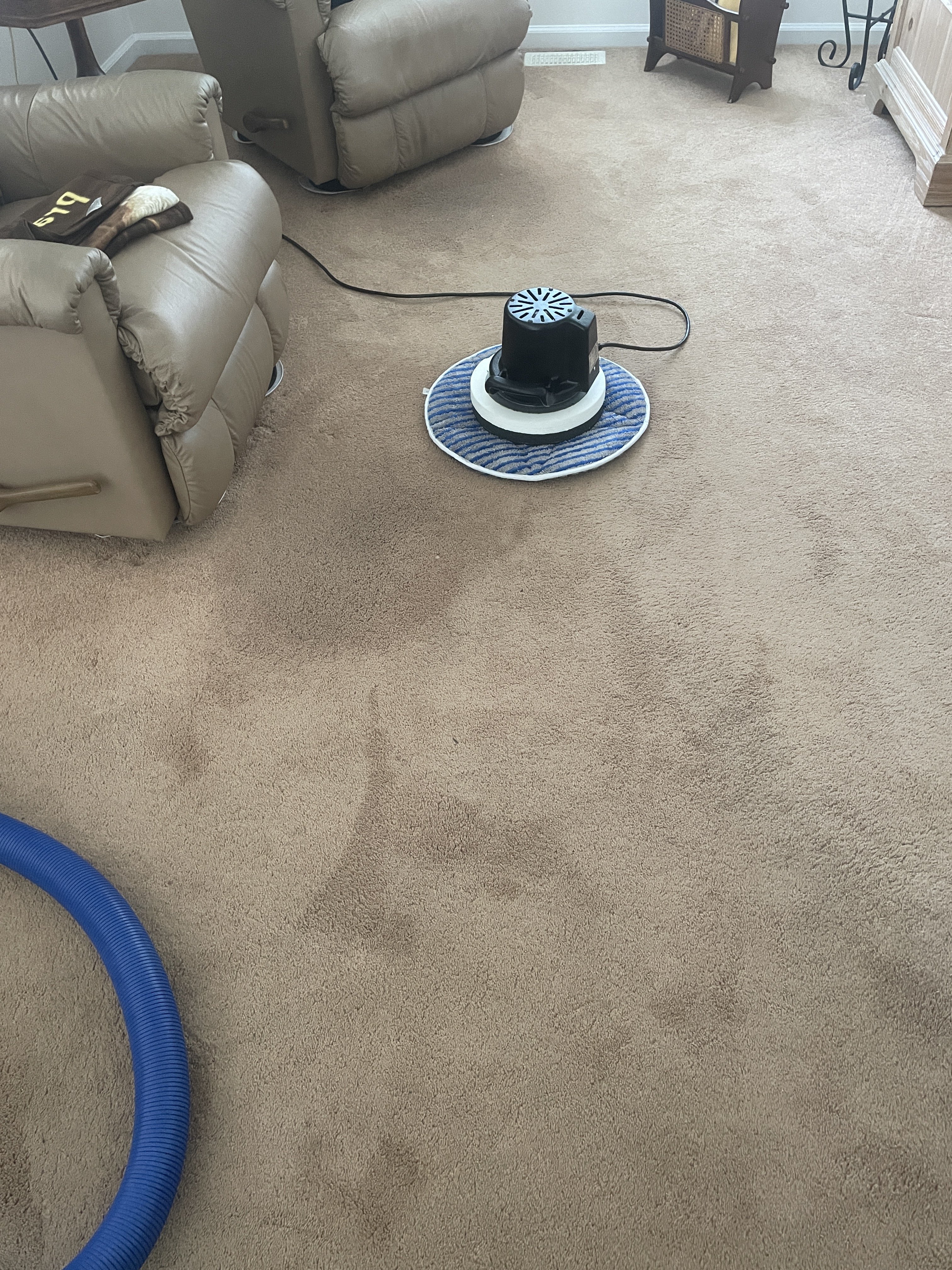

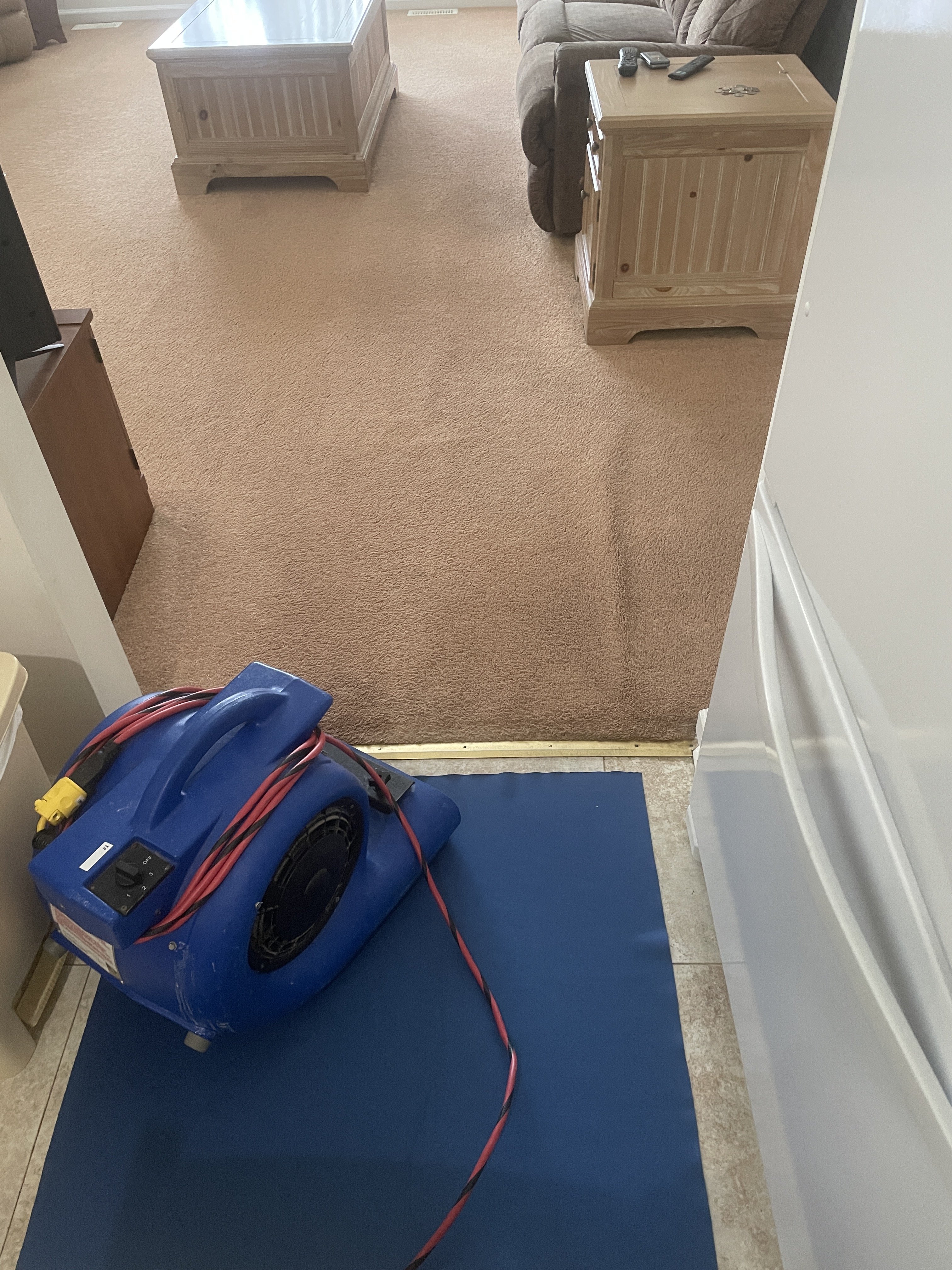

Glad I had it all on the truck. This was Job 4 that was calling for a while for urgent cleaning. I am there only guy and they had to wait. Very hard HWE setup. So I popped in for exactly 1/2 hour from start to finish, to help her out. Husband is now in Hospice, she is very old, and they are just great people to the b0ne. So I surprised her as she was bedside at the hospital.
2 rounds of agitation with Pad Cap Pro, and a cotton pad after.
Before
After
During. (self film, one handed)
Drying was ALWAYS a concern here, and I get called frequently here. This is a win win.

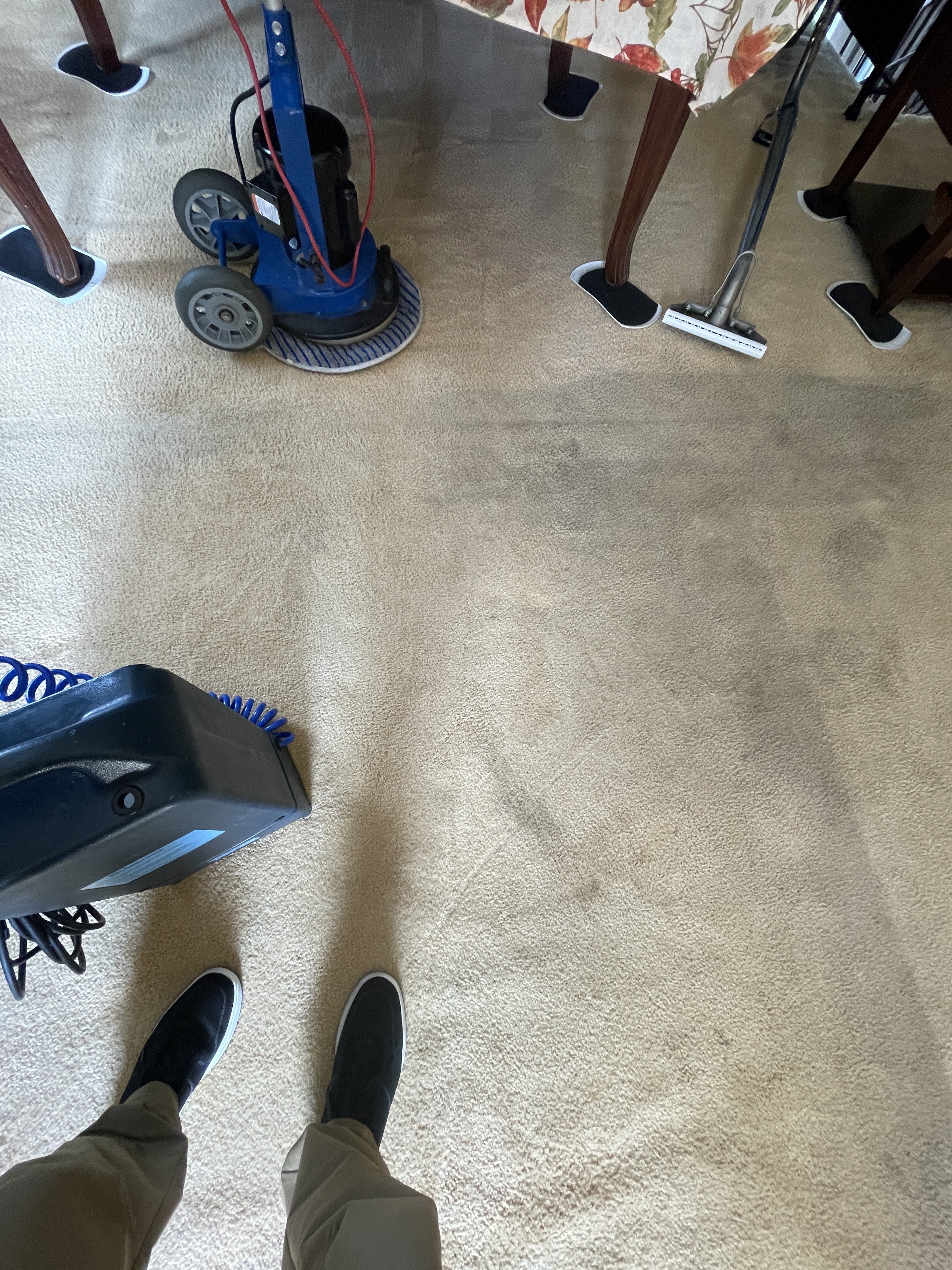

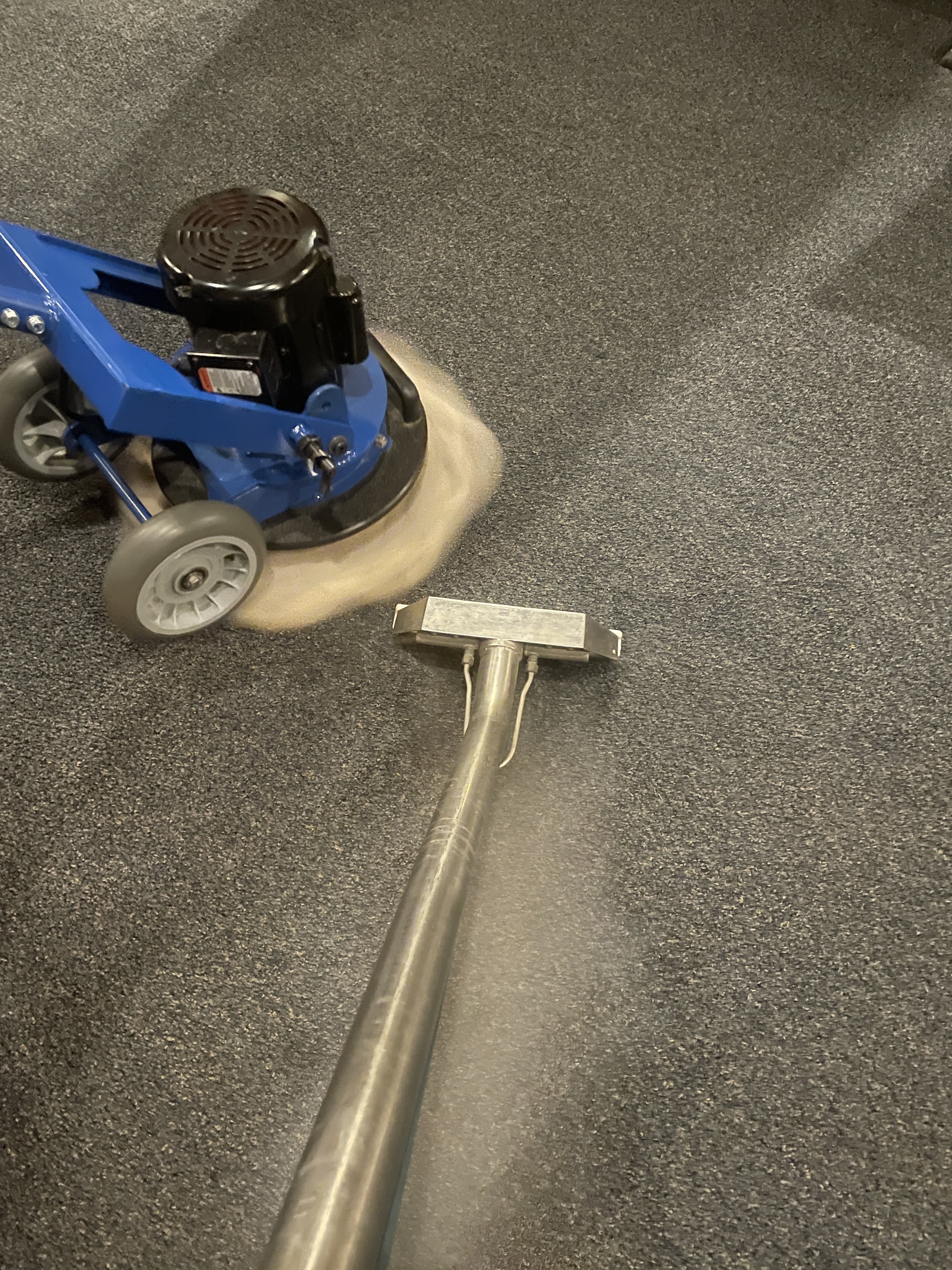

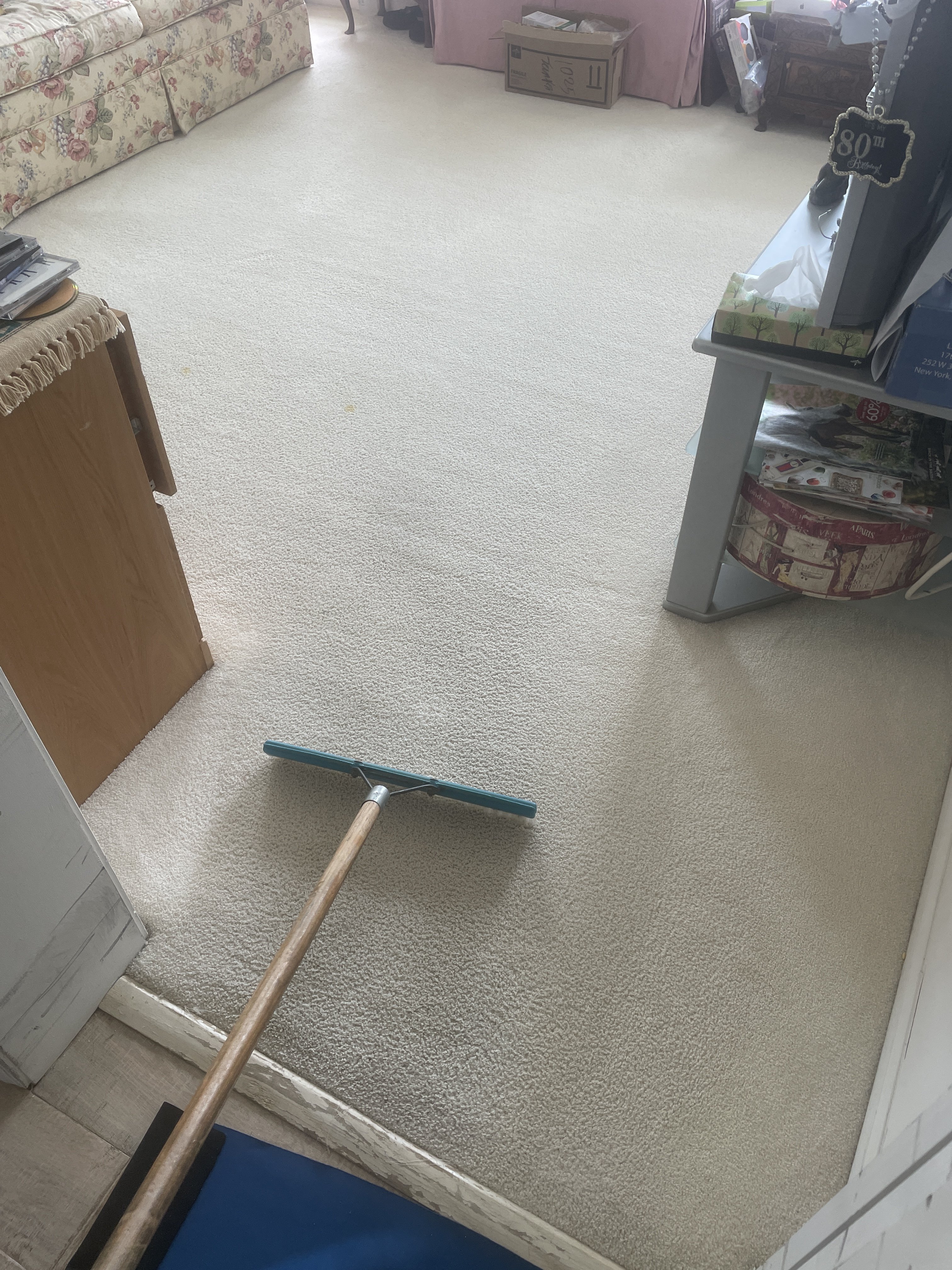

Customer in a 55+ community.
Vacuum, Trinity Odyssey with Pad Cap Pro, HWE, Re apply and run Odyssey again (agitation), Prespray and HWE one more time, Then Post Pad with
the Glad Pads from Greenglides.
The customer was very happy. 2 1/2 hrs spent. Last crew of 2 from the Franchise were in and out in less than 30 minutes.
Breaking in to this market now.
The tools, (3 dark spots are not on carpet, broken camera lens)
Before
After
Close to dry, plus I left a fan. 86 YO couple that is full of life and they were so happy. Love my job.
The Dark spots are from my broke camera lens, 3 dots are tech issue, not spots.

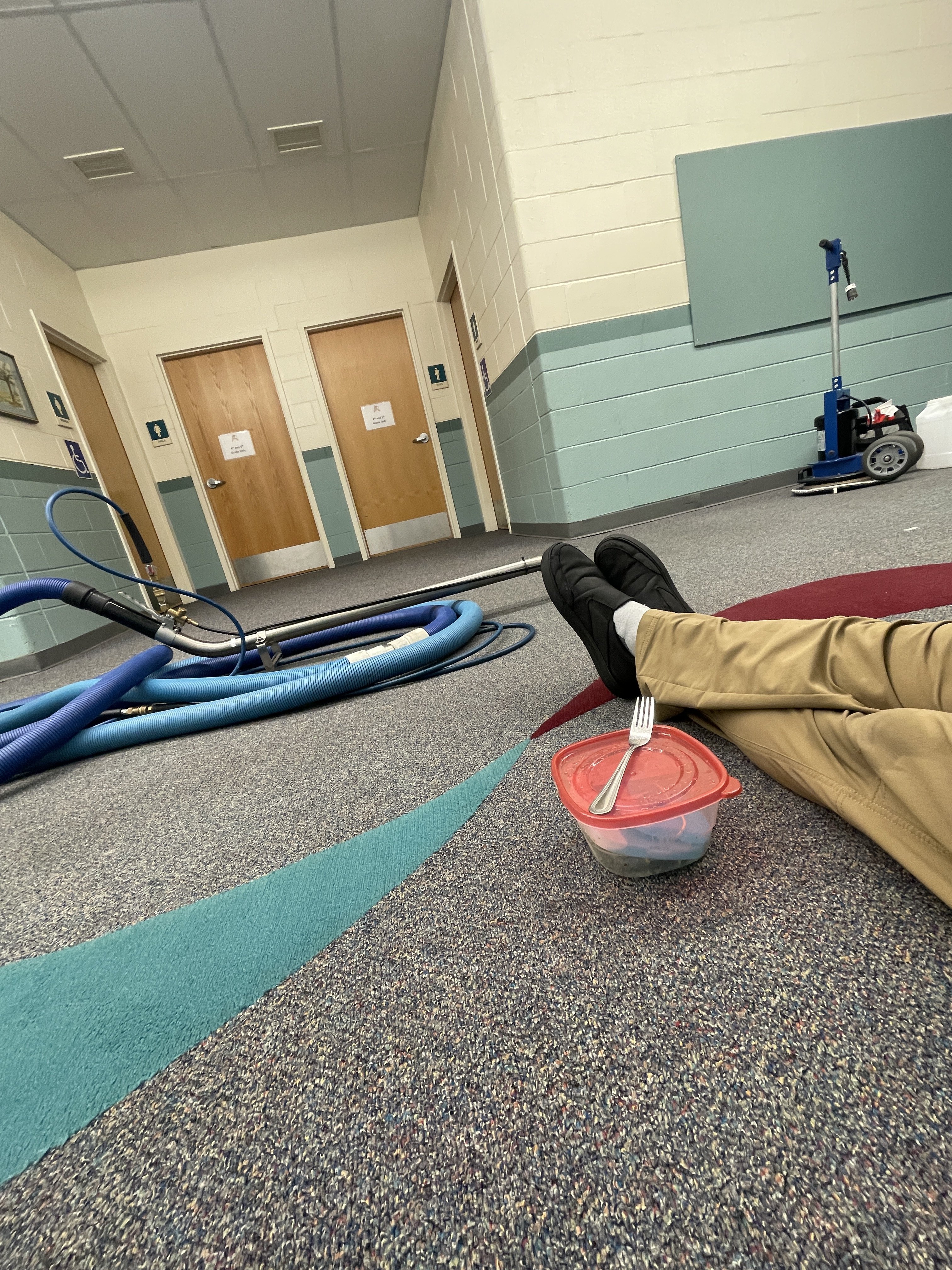

This is getting it for me now. Did 10K sq ft in 1 day. 12 hours solo, then my part time guy carried me for 5 more hours. 350ft of hose with 1 truckmount (PMF Mach 15), Trinity Odyssey,which impressed the boss for future VLM only work during the school year. Home Run.
I can see how you guys like commercial work more than occupied houses. Going back tonight to finish it off, about 2K sq ft to go.
