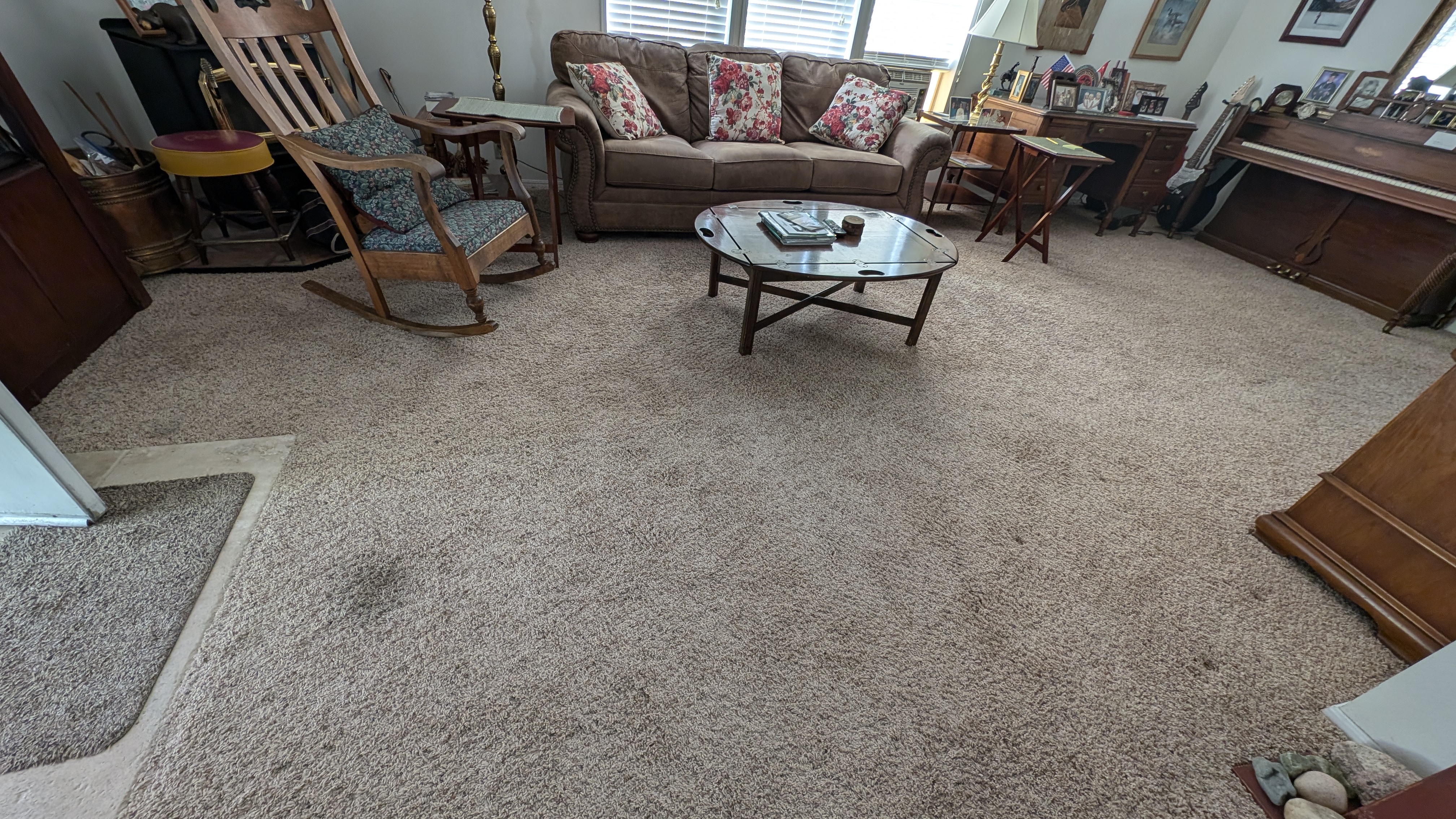

Show us the after pics of that trashed carpet you just cleaned recently?
116,967
Trashed?! lol That whole pic should be purple…

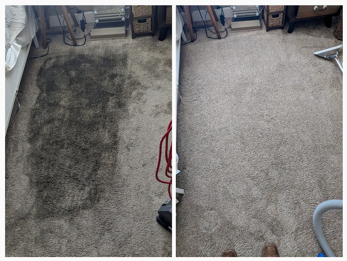

I got a trashed one today .
