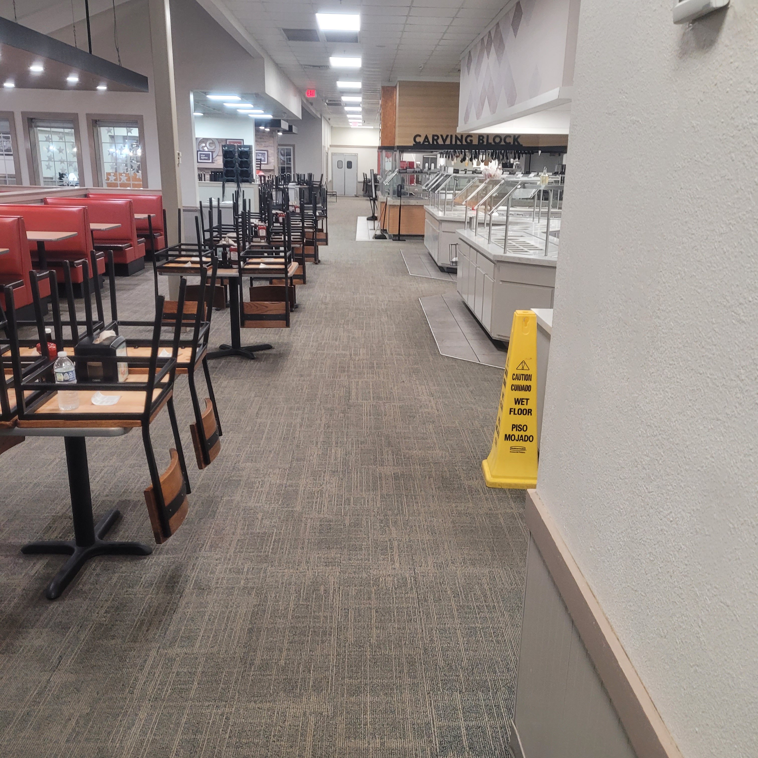

We're not proud of jobs like this, but #10 flow made it happen faster with less effort. I want to encourage you to stay away from jobs like this. If you're going to experiment, get yourself a 25-foot section of 3/8" pressure line and witness the power of rinse with less Psi.

It would be pointless to continue this debate since I have 20 commercial accounts, and you don't ( I assume that based on your eloquently framed response)
I can use the Zipper or something similar in the open, but I must dance around tables and booths. With Zipper, it's not possible.

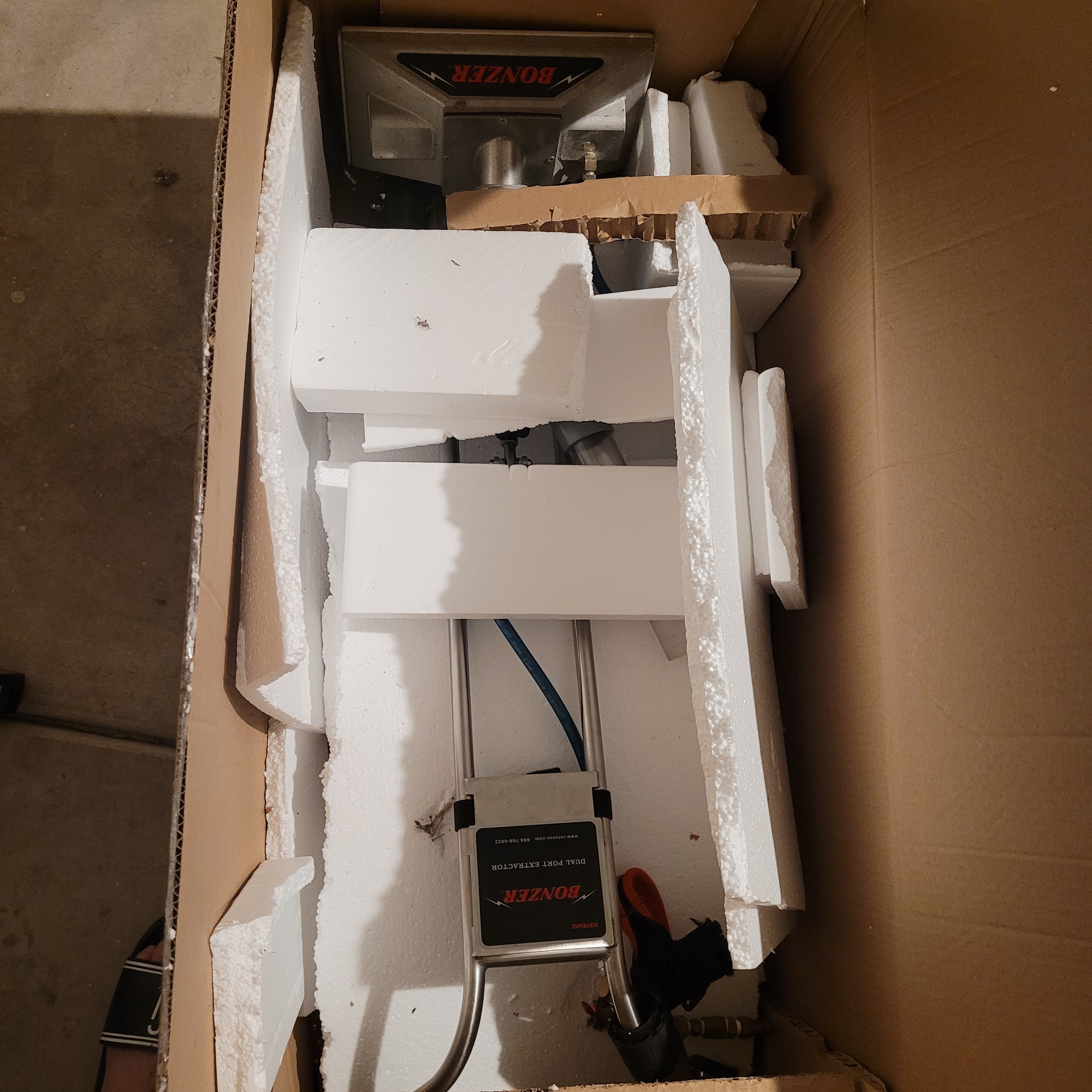

Here's a packed up Bonzer ready to ship to Canada or worldwide .
Is this available?
